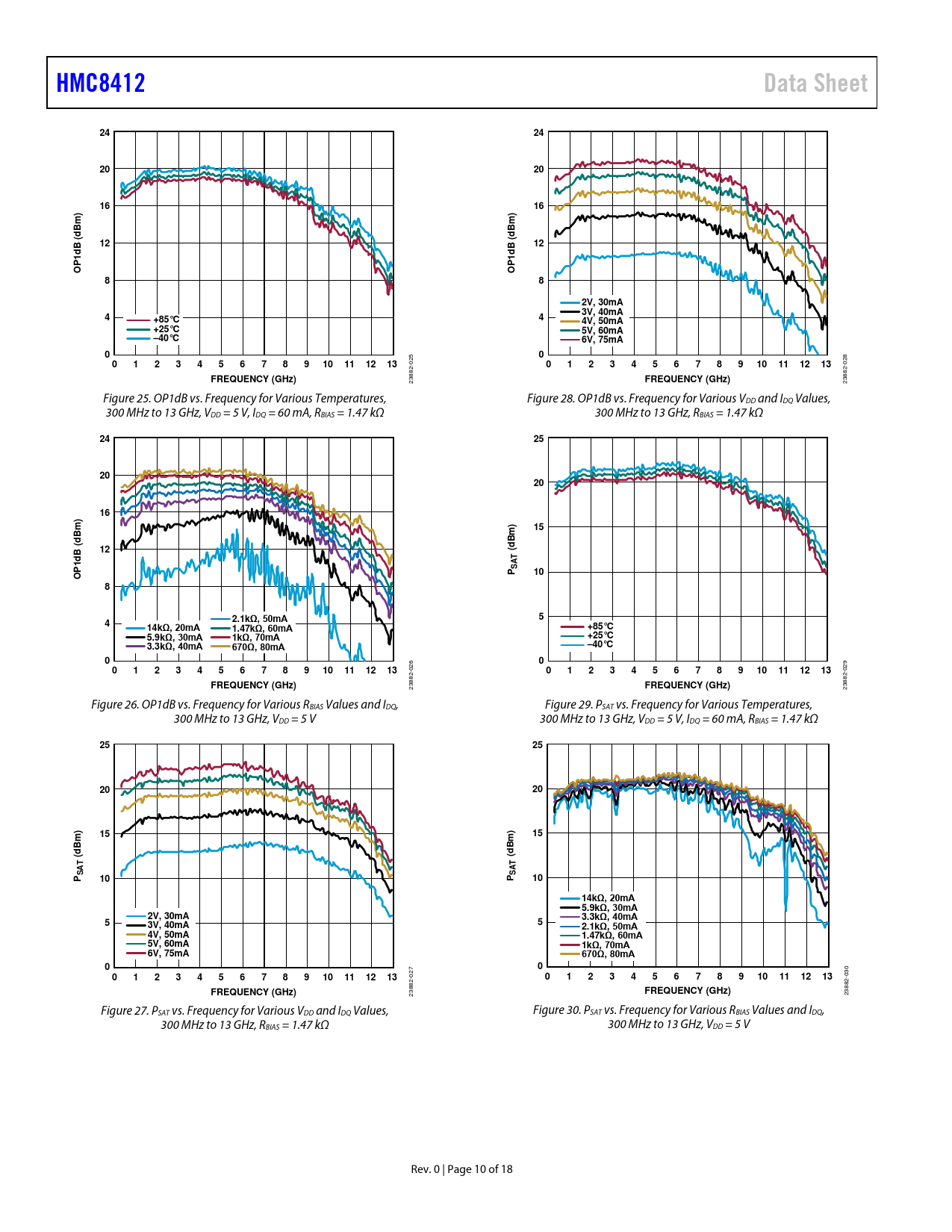

HMC8412. Data Sheet. Bm). B (. 2V, 30mA 3V, 40mA. +85°C. 4V, 50mA. +25°C. 5V, 60mA. –40°C. 6V, 75mA. FREQUENCY (GHz). Bm) d. 2.1kΩ, 50mA
HMC8412 Data Sheet Bm) B ( 2V, 30mA 3V, 40mA +85°C 4V, 50mA +25°C 5V, 60mA –40°C 6V, 75mA FREQUENCY (GHz) Bm) d 2.1kΩ, 50mA
HMC8412 Data Sheet 24 24 20 20 16 16 Bm) Bm) d d B ( 12 B ( 12 1d 1d P P O O 8 8 2V, 30mA 3V, 40mA 4 +85°C 4 4V, 50mA +25°C 5V, 60mA –40°C 6V, 75mA 0 0 0 1 2 3 4 5 6 7 8 9 10 11 12 13
025
028
FREQUENCY (GHz)
23882-
FREQUENCY (GHz)
23882- Figure 25. OP1dB vs. Frequency for Various Temperatures, Figure 28. OP1dB vs. Frequency for Various VDD and IDQ Values, 300 MHz to 13 GHz, VDD = 5 V, IDQ = 60 mA, RBIAS = 1.47 kΩ 300 MHz to 13 GHz, RBIAS = 1.47 kΩ
24 25 20 20 16 15 Bm) d Bm) d B ( 12 ( 1d AT P SP 10 O 8 2.1kΩ, 50mA 5 4 14kΩ, 20mA 1.47kΩ, 60mA +85°C 5.9kΩ, 30mA 1kΩ, 70mA +25°C 3.3kΩ, 40mA 670Ω, 80mA –40°C 0 0 0 1 2 3 4 5 6 7 8 9 10 11 12 13
026
029
FREQUENCY (GHz)
23882-
FREQUENCY (GHz)
23882- Figure 26. OP1dB vs. Frequency for Various RBIAS Values and IDQ, Figure 29. PSAT vs. Frequency for Various Temperatures, 300 MHz to 13 GHz, VDD = 5 V 300 MHz to 13 GHz, VDD = 5 V, IDQ = 60 mA, RBIAS = 1.47 kΩ
25 25 20 20 15 15 Bm) Bm) d d ( ( AT AT S S P 10 P 10 14kΩ, 20mA 5.9kΩ, 30mA 2V, 30mA 3.3kΩ, 40mA 5 3V, 40mA 5 2.1kΩ, 50mA 4V, 50mA 1.47kΩ, 60mA 5V, 60mA 1kΩ, 70mA 6V, 75mA 670Ω, 80mA 0 0 0 1 2 3 4 5 6 7 8 9 10 11 12 13
027
030
FREQUENCY (GHz) FREQUENCY (GHz)
23882- 23882- Figure 27. PSAT vs. Frequency for Various VDD and IDQ Values, Figure 30. PSAT vs. Frequency for Various RBIAS Values and IDQ, 300 MHz to 13 GHz, RBIAS = 1.47 kΩ 300 MHz to 13 GHz, VDD = 5 V Rev. 0 | Page 10 of 18 Document Outline Features Applications Functional Block Diagram General Description Revision History Specifications 0.4 GHz to 3 GHz Frequency Range 3 GHz to 9 GHz Frequency Range 9 GHz to 11 GHz Frequency Range Absolute Maximum Ratings Thermal Resistance Electrostatic Discharge (ESD) Ratings ESD Ratings for HMC8412 ESD Caution Pin Configuration and Function Descriptions Interface Schematics Typical Performance Characteristics Theory of Operation Applications Information Recommended Bias Sequencing Power-Up Sequence Power-Down Sequence Outline Dimensions Ordering Guide
