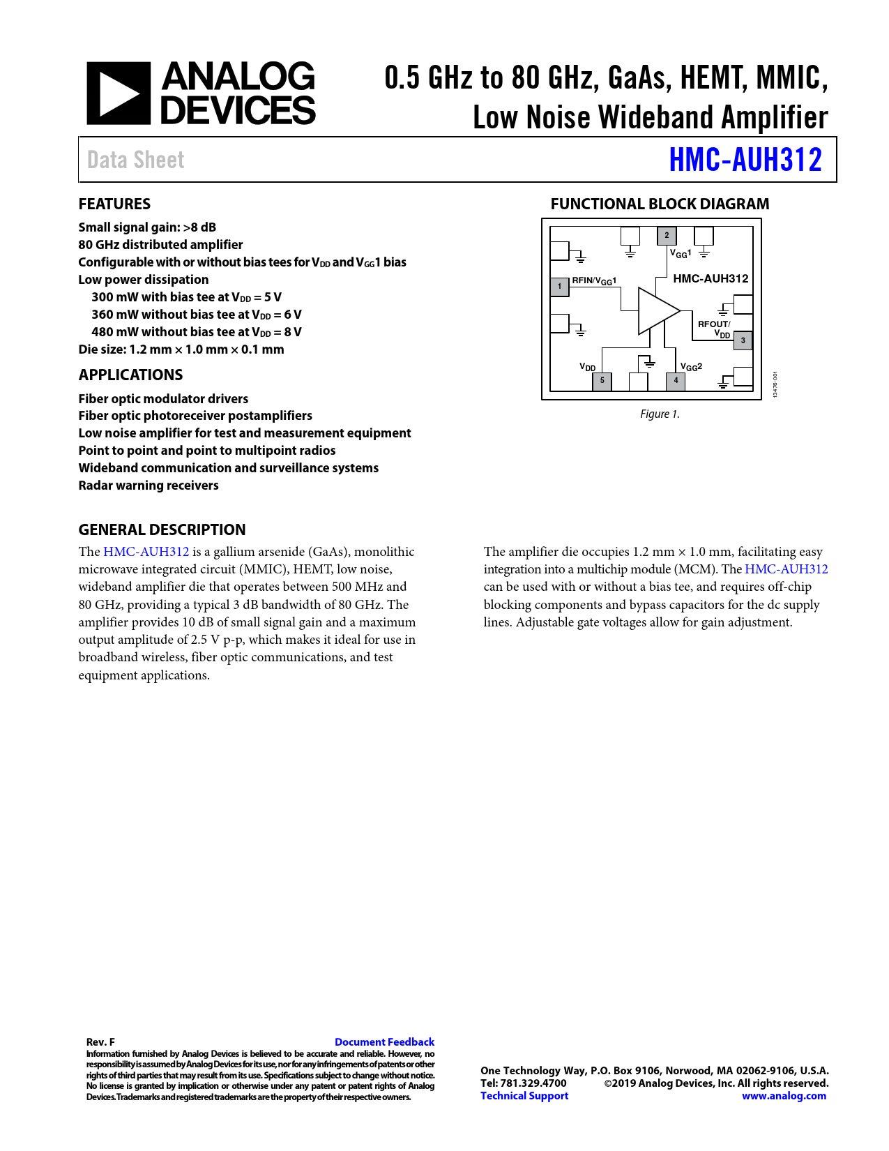

0.5 GHz to 80 GHz, GaAs, HEMT, MMIC, Low Noise Wideband Amplifier Data Sheet HMC-AUH312 FEATURES FUNCTIONAL BLOCK DIAGRAM Small signal gain: >8 dB 2 80 GHz distributed amplifier V Configurable with or without bias tees for V GG1 DD and VGG1 bias Low power dissipation RFIN/V HMC-AUH312 GG1 1 300 mW with bias tee at VDD = 5 V 360 mW without bias tee at VDD = 6 V 480 mW without bias tee at V RFOUT/ DD = 8 V VDD 3 Die size: 1.2 mm × 1.0 mm × 0.1 mm APPLICATIONS V V DD GG2 5 4

Fiber optic modulator drivers
13476-
Fiber optic photoreceiver postamplifiers
Figure 1.
Low noise amplifier for test and measurement equipment Point to point and point to multipoint radios Wideband communication and surveillance systems Radar warning receivers GENERAL DESCRIPTION
The HMC-AUH312 is a gallium arsenide (GaAs), monolithic The amplifier die occupies 1.2 mm × 1.0 mm, facilitating easy microwave integrated circuit (MMIC), HEMT, low noise, integration into a multichip module (MCM). The HMC-AUH312 wideband amplifier die that operates between 500 MHz and can be used with or without a bias tee, and requires off-chip 80 GHz, providing a typical 3 dB bandwidth of 80 GHz. The blocking components and bypass capacitors for the dc supply amplifier provides 10 dB of small signal gain and a maximum lines. Adjustable gate voltages allow for gain adjustment. output amplitude of 2.5 V p-p, which makes it ideal for use in broadband wireless, fiber optic communications, and test equipment applications.
