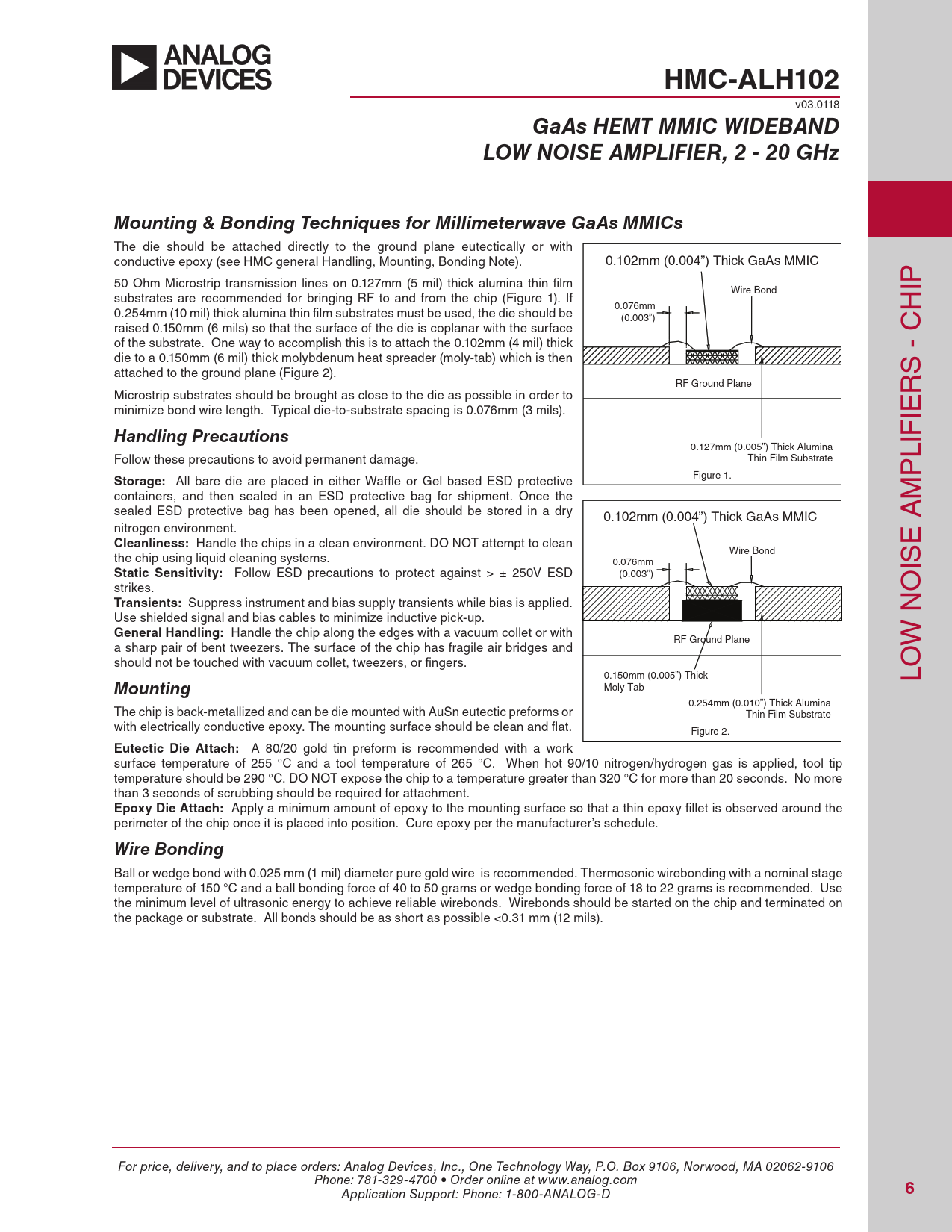

The die should be attached directly to the ground plane eutectically or with conductive epoxy (see HMC general Handling, Mounting, Bonding Note). 0.102mm (0.004”) Thick GaAs MMIC 50 Ohm Microstrip transmission lines on 0.127mm (5 mil) thick alumina thin film Wire Bond IP substrates are recommended for bringing RF to and from the chip (Figure 1). If 0.076mm H 0.254mm (10 mil) thick alumina thin film substrates must be used, the die should be (0.003”) raised 0.150mm (6 mils) so that the surface of the die is coplanar with the surface C of the substrate. One way to accomplish this is to attach the 0.102mm (4 mil) thick - die to a 0.150mm (6 mil) thick molybdenum heat spreader (moly-tab) which is then attached to the ground plane (Figure 2). S RF Ground Plane Microstrip substrates should be brought as close to the die as possible in order to R minimize bond wire length. Typical die-to-substrate spacing is 0.076mm (3 mils). IE

0.127mm (0.005”) Thick Alumina Follow these precautions to avoid permanent damage. Thin Film Substrate LIF Figure 1. P

Handle the chip along the edges with a vacuum collet or with RF Ground Plane a sharp pair of bent tweezers. The surface of the chip has fragile air bridges and W should not be touched with vacuum collet, tweezers, or fingers. 0.150mm (0.005”) Thick LO
Mounting
Moly Tab 0.254mm (0.010”) Thick Alumina The chip is back-metallized and can be die mounted with AuSn eutectic preforms or Thin Film Substrate with electrically conductive epoxy. The mounting surface should be clean and flat. Figure 2.
