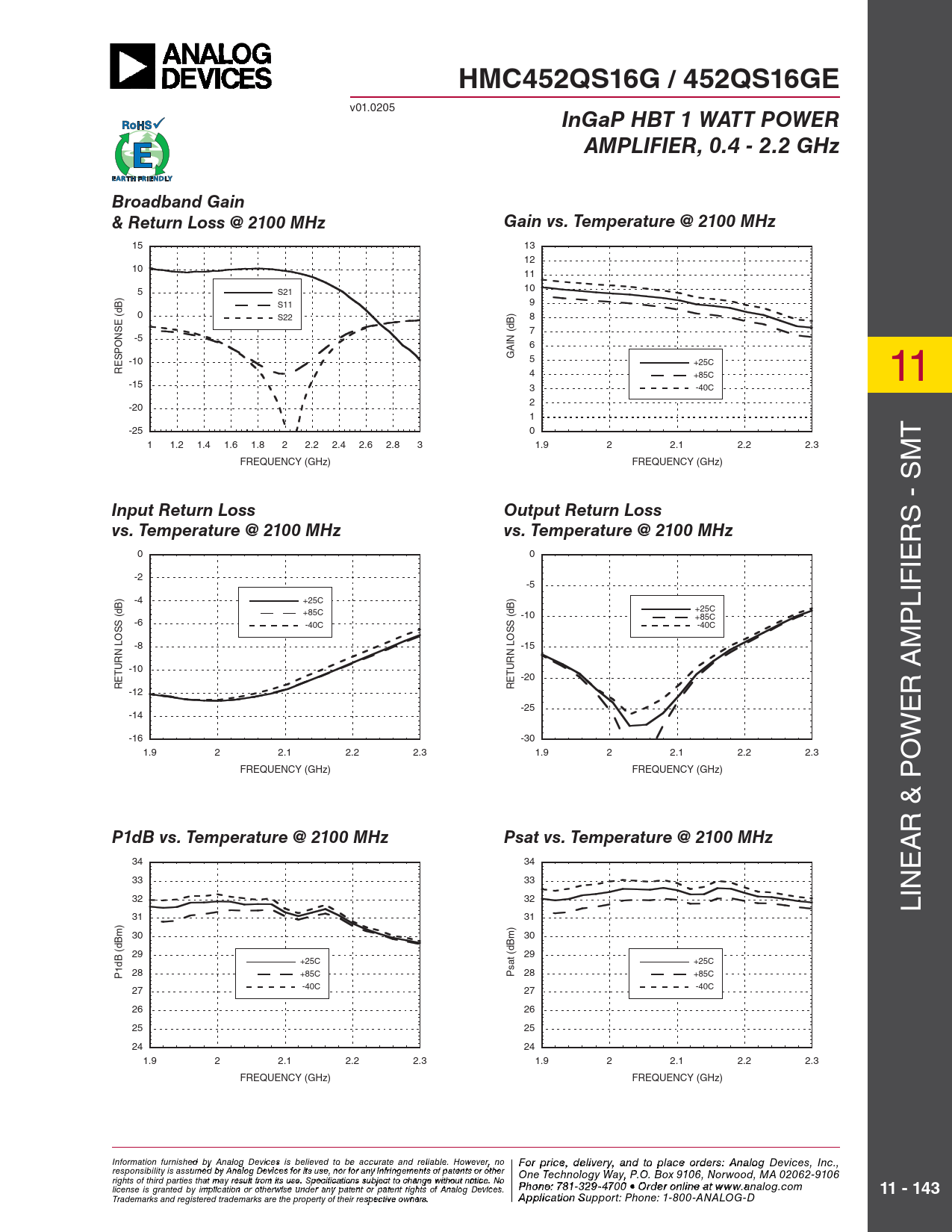

DescriptionInGaP HBT 1 WATT POWER AMPLIFIER, 0.4 - 2.2 GHz
Pages / Page22 / 10 — HMC452QS16G / 452QS16GE. InGaP HBT 1 WATT POWER. AMPLIFIER, 0.4 - 2.2 …
HMC452QS16G / 452QS16GE. InGaP HBT 1 WATT POWER. AMPLIFIER, 0.4 - 2.2 GHz. Broadband Gain & Return Loss @ 2100 MHz
HMC452QS16G / 452QS16GE InGaP HBT 1 WATT POWER AMPLIFIER, 0.4 - 2.2 GHz Broadband Gain & Return Loss @ 2100 MHz
v01.0205
InGaP HBT 1 WATT POWER AMPLIFIER, 0.4 - 2.2 GHz Broadband Gain & Return Loss @ 2100 MHz Gain vs. Temperature @ 2100 MHz
15 13 12 10 11 5 10 S21 S11 9 0 S22 8 (dB) 7 -5 6 GAIN -10 5 +25C RESPONSE (dB) 4 +85C -15 3 -40C 11 2 -20 1 -25 0 T 1 1.2 1.4 1.6 1.8 2 2.2 2.4 2.6 2.8 3 1.9 2 2.1 2.2 2.3 FREQUENCY (GHz) FREQUENCY (GHz) - SM
Input Return Loss Output Return Loss
S
vs. Temperature @ 2100 MHz vs. Temperature @ 2100 MHz
0 0 -2 -5 -4 +25C +25C +85C -10 +85C -6 -40C -40C PLIFIER -8 -15 M -10 -20 RETURN LOSS (dB) RETURN LOSS (dB) -12 -25 -14 ER A -16 -30 W 1.9 2 2.1 2.2 2.3 1.9 2 2.1 2.2 2.3 O FREQUENCY (GHz) FREQUENCY (GHz) & P R
P1dB vs. Temperature @ 2100 MHz Psat vs. Temperature @ 2100 MHz
A 34 34 E 33 33 32 32 31 31 LIN 30 30 29 29 +25C +25C 28 +85C Psat (dBm) 28 +85C P1dB (dBm) 27 -40C 27 -40C 26 26 25 25 24 24 1.9 2 2.1 2.2 2.3 1.9 2 2.1 2.2 2.3 FREQUENCY (GHz) FREQUENCY (GHz) Information furnish F e o d r pri by An ce, de alog Devic leis vie s rbyeli, a eve nd to pla d to be accur ce o ate an r d der relia s ble , pl . Ho ease co wever, no For price, delivery, and to place orders: Analog Devices, Inc., responsibility is assumed by Analog Devices for its use, nor for any infringements of patents or other ntact Hittite Microwave Corporation: One Technology Way, P.O. Box 9106, Norwood, MA 02062-9106 20 Alpha Road, Chelmsford, MA 01824 Phone rights of third parties that may result from its use. Specifications subject to change without notice. No license is granted by implication or otherwise under any patent or patent rights of Analog Devices. : 978 Pho - n 25 e: 7 0- 81 33 2 4 9- 3 F 470 ax: 978 0 • Order o - n 25 lin 0 e a-t 3373 www.analog.com
