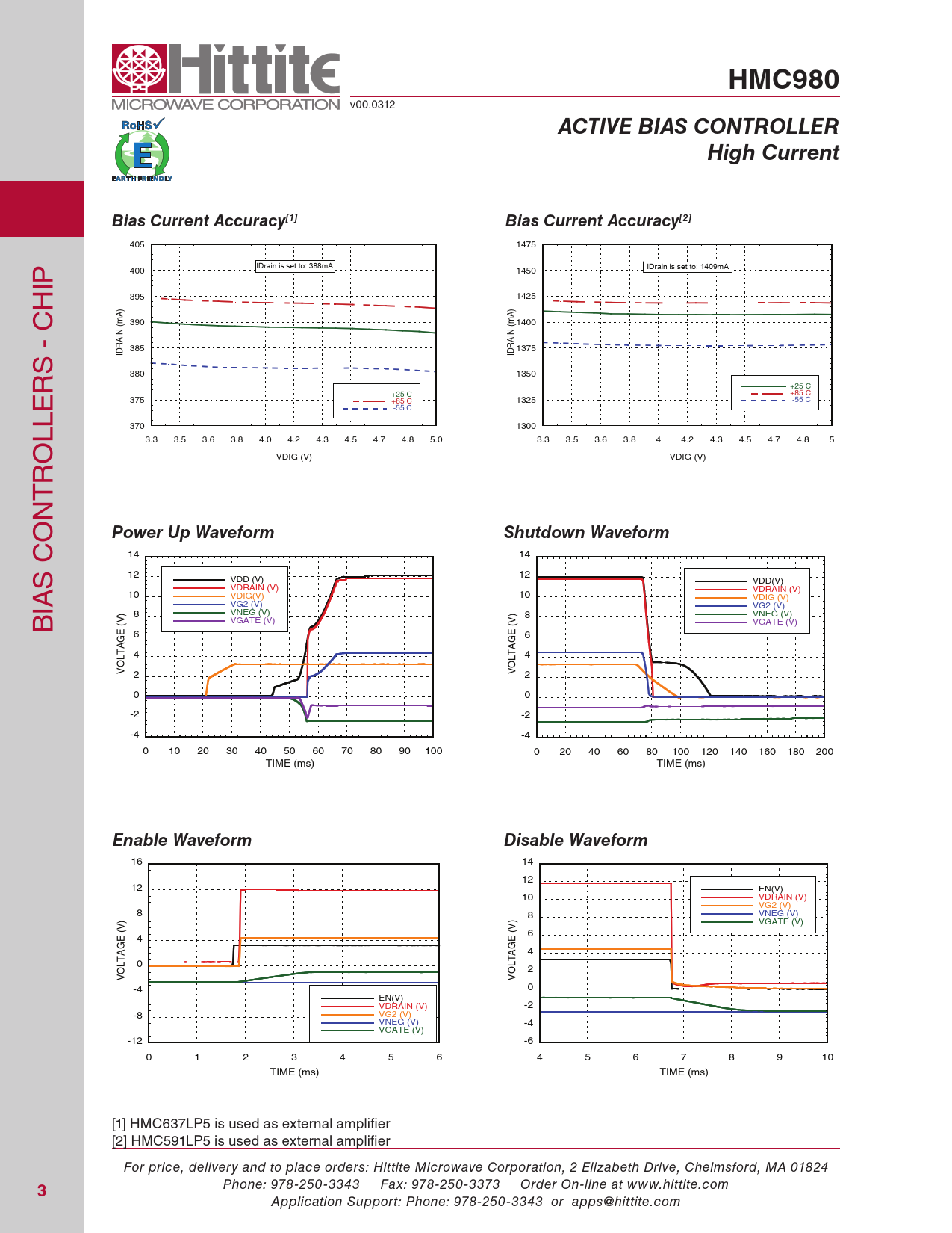

Active BiAs controller High current Bias current Accuracy[1] Bias current Accuracy[2]
405 1475 ip IDrain is set to: 388mA 400 1450 IDrain is set to: 1409mA h 395 1425 A) A) 390 (m 1400 (m IN IN A A R 385 R 1375 s - C ID ID r 380 1350 +25 C +25 C +85 C 375 +85 C 1325 -55 C -55 C lle 370 1300 o 3.3 3.5 3.6 3.8 4.0 4.2 4.3 4.5 4.7 4.8 5.0 3.3 3.5 3.6 3.8 4 4.2 4.3 4.5 4.7 4.8 5 VDIG (V) VDIG (V) r t n o
Power Up Waveform shutdown Waveform
14 14 s C 12 12 VDD (V) VDD(V) VDRAIN (V) ia 10 VDIG(V) 10 VDRAIN (V) VDIG (V) VG2 (V) VG2 (V) B 8 VNEG (V) 8 VNEG (V) VGATE (V) VGATE (V) 6 6 4 4 VOLTAGE (V) VOLTAGE (V) 2 2 0 0 -2 -2 -4 -4 0 10 20 30 40 50 60 70 80 90 100 0 20 40 60 80 100 120 140 160 180 200 TIME (ms) TIME (ms)
enable Waveform Disable Waveform
16 14 12 12 EN(V) 10 VDRAIN (V) VG2 (V) 8 8 VNEG (V) VGATE (V) 4 6 4 0 2 VOLTAGE (V) VOLTAGE (V) -4 0 EN(V) VDRAIN (V) -2 -8 VG2 (V) VNEG (V) -4 VGATE (V) -12 -6 0 1 2 3 4 5 6 4 5 6 7 8 9 10 TIME (ms) TIME (ms) [1] hMC637lp5 is used as external amplifier [2] hMC591lp5 is used as external amplifier For price, delivery and to place orders: Hittite Microwave Corporation, 2 Elizabeth Drive, Chelmsford, MA 01824 Phone: 978-250-3343 Fax: 978-250-3373 Order On-line at www.hittite.com
