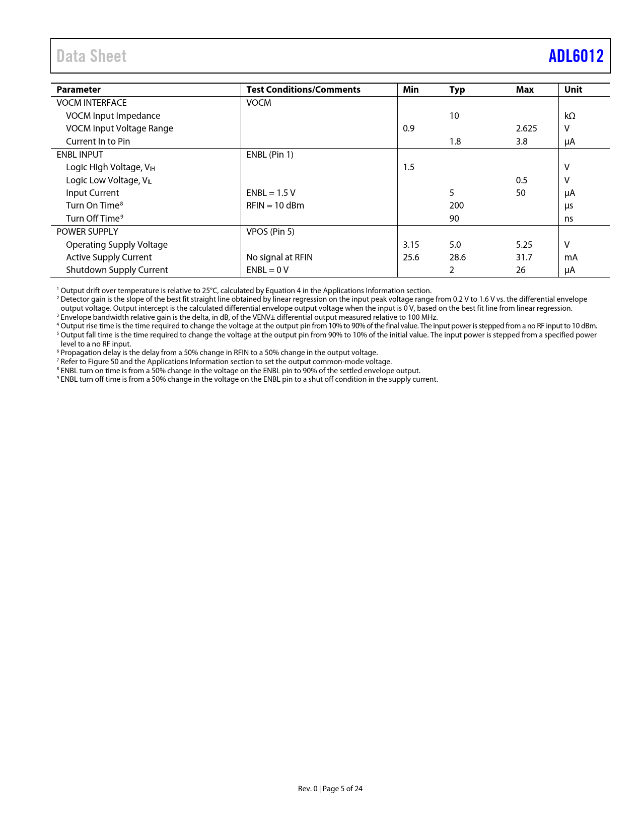

Data Sheet. ADL6012. Parameter. Test Conditions/Comments. Min. Typ. Max. Unit
Data Sheet ADL6012 Parameter Test Conditions/Comments Min Typ Max Unit
link to page 23 link to page 15 link to page 23
VOCM INTERFACE VOCM VOCM Input Impedance 10 kΩ VOCM Input Voltage Range 0.9 2.625 V Current In to Pin 1.8 3.8 µA ENBL INPUT ENBL (Pin 1) Logic High Voltage, VIH 1.5 V Logic Low Voltage, VIL 0.5 V Input Current ENBL = 1.5 V 5 50 µA Turn On Time8 RFIN = 10 dBm 200 µs Turn Off Time9 90 ns POWER SUPPLY VPOS (Pin 5) Operating Supply Voltage 3.15 5.0 5.25 V Active Supply Current No signal at RFIN 25.6 28.6 31.7 mA Shutdown Supply Current ENBL = 0 V 2 26 µA 1 Output drift over temperature is relative to 25°C, calculated by Equation 4 in the Applications Information section. 2 Detector gain is the slope of the best fit straight line obtained by linear regression on the input peak voltage range from 0.2 V to 1.6 V vs. the differential envelope output voltage. Output intercept is the calculated differential envelope output voltage when the input is 0 V, based on the best fit line from linear regression. 3 Envelope bandwidth relative gain is the delta, in dB, of the VENV± differential output measured relative to 100 MHz. 4 Output rise time is the time required to change the voltage at the output pin from 10% to 90% of the final value. The input power is stepped from a no RF input to 10 dBm. 5 Output fall time is the time required to change the voltage at the output pin from 90% to 10% of the initial value. The input power is stepped from a specified power level to a no RF input. 6 Propagation delay is the delay from a 50% change in RFIN to a 50% change in the output voltage. 7 Refer to Figure 50 and the Applications Information section to set the output common-mode voltage. 8 ENBL turn on time is from a 50% change in the voltage on the ENBL pin to 90% of the settled envelope output. 9 ENBL turn off time is from a 50% change in the voltage on the ENBL pin to a shut off condition in the supply current. Rev. 0 | Page 5 of 24 Document Outline FEATURES APPLICATIONS FUNCTIONAL BLOCK DIAGRAM GENERAL DESCRIPTION TABLE OF CONTENTS REVISION HISTORY SPECIFICATIONS ABSOLUTE MAXIMUM RATINGS THERMAL RESISTANCE ESD CAUTION PIN CONFIGURATION AND FUNCTION DESCRIPTIONS TYPICAL PERFORMANCE CHARACTERISTICS MEASUREMENT SETUPS THEORY OF OPERATION BASIC CONNECTIONS RF INPUT ENVELOPE OUTPUT INTERFACE COMMON-MODE VOLTAGE INTERFACE ENABLE INTERFACE DECOUPLING INTERFACE PCB LAYOUT RECOMMENDATIONS SYSTEM CALIBRATION AND MEASUREMENT ERROR APPLICATIONS INFORMATION EVALUATION BOARD OUTLINE DIMENSIONS ORDERING GUIDE
