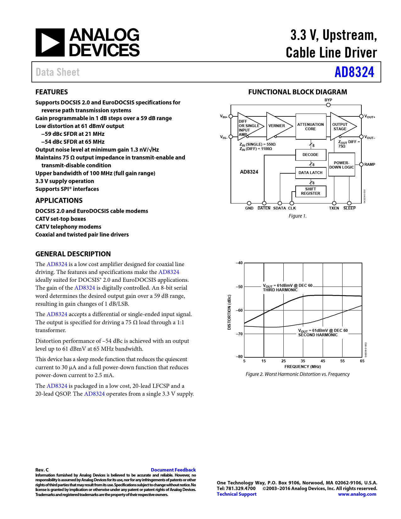

3.3 V, Upstream,. Cable Line Driver. Data Sheet. AD8324. FEATURES. FUNCTIONAL BLOCK DIAGRAM. BYP
Datasheet AD8324 Analog Devices, Revision: C
3.3 V, Upstream, Cable Line Driver Data Sheet AD8324 FEATURES FUNCTIONAL BLOCK DIAGRAM BYP Supports DOCSIS 2.0 and EuroDOCSIS specifications for reverse path transmission systems V V Gain programmable in 1 dB steps over a 59 dB range IN+ OUT+ DIFF Low distortion at 61 dBmV output OR SINGLE VERNIER ATTENUATION OUTPUT INPUT CORE STAGE −59 dBc SFDR at 21 MHz AMP VIN– VOUT– −54 dBc SFDR at 65 MHz Z Z OUT DIFF = IN (SINGLE) = 550Ω 8 75Ω Output noise level at minimum gain 1.3 nV/√Hz ZIN (DIFF) = 1100Ω DECODE Maintains 75 Ω output impedance in transmit-enable and POWER- transmit-disable condition 8 RAMP DOWN LOGIC Upper bandwidth of 100 MHz (full gain range) AD8324 DATA LATCH 3.3 V supply operation 8 Supports SPI® interfaces SHIFT
01
REGISTER
-0 0 9-
APPLICATIONS
433 0
GND DATEN SDATA CLK TXEN SLEEP DOCSIS 2.0 and EuroDOCSIS cable modems
Figure 1.
CATV set-top boxes CATV telephony modems Coaxial and twisted pair line drivers GENERAL DESCRIPTION
The AD8324 is a low cost amplifier designed for coaxial line
–40
driving. The features and specifications make the AD8324 ideally suited for DOCSIS® 2.0 and EuroDOCSIS applications. The gain of the AD8324 is digitally controlled. An 8-bit serial
–50 VOUT = 61dBmV @ DEC 60 THIRD HARMONIC
word determines the desired output gain over a 59 dB range,
Bc)
resulting in gain changes of 1 dB/LSB.
d –60
The AD8324 accepts a differential or single-ended input signal. The output is specified for driving a 75 Ω load through a 1:1 transformer.
DISTORTION ( VOUT = 61dBmV @ DEC 60 –70 SECOND HARMONIC
Distortion performance of –54 dBc is achieved with an output level up to 61 dBmV at 65 MHz bandwidth.
–80
04339-0-002 This device has a sleep mode function that reduces the quiescent
5 15 25 35 45 55 65
current to 30 μA and a full power-down function that reduces
FREQUENCY (MHz)
power-down current to 2.5 mA. Figure 2. Worst Harmonic Distortion vs. Frequency The AD8324 is packaged in a low cost, 20-lead LFCSP and a 20-lead QSOP. The AD8324 operates from a single 3.3 V supply.
