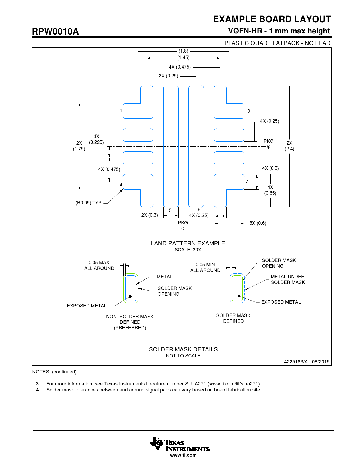

EXAMPLE BOARD LAYOUT. RPW0010A. VQFN-HR - 1 mm max height. www.ti.com
EXAMPLE BOARD LAYOUT RPW0010A VQFN-HR - 1 mm max height www.ti.com
PLASTIC QUAD FLATPACK - NO LEAD (1.8) (1.45) 4X (0.475) 2X (0.25) 1 10 4X (0.25) 4X PKG 2X (0.225) 2X (1.75) (2.4) 4X (0.475) 4X (0.3) 7 4 4X (0.65) (R0.05) TYP 5 6 2X (0.3) 4X (0.25) PKG 8X (0.6) LAND PATTERN EXAMPLE SCALE: 30X SOLDER MASK 0.05 MAX 0.05 MIN OPENING ALL AROUND ALL AROUND METAL METAL UNDER SOLDER MASK SOLDER MASK OPENING EXPOSED METAL EXPOSED METAL NON- SOLDER MASK SOLDER MASK DEFINED DEFINED (PREFERRED) SOLDER MASK DETAILS NOT TO SCALE 4225183/A 08/2019 NOTES: (continued) 3. For more information, see Texas Instruments literature number SLUA271 (www.ti.com/lit/slua271). 4. Solder mask tolerances between and around signal pads can vary based on board fabrication site.
