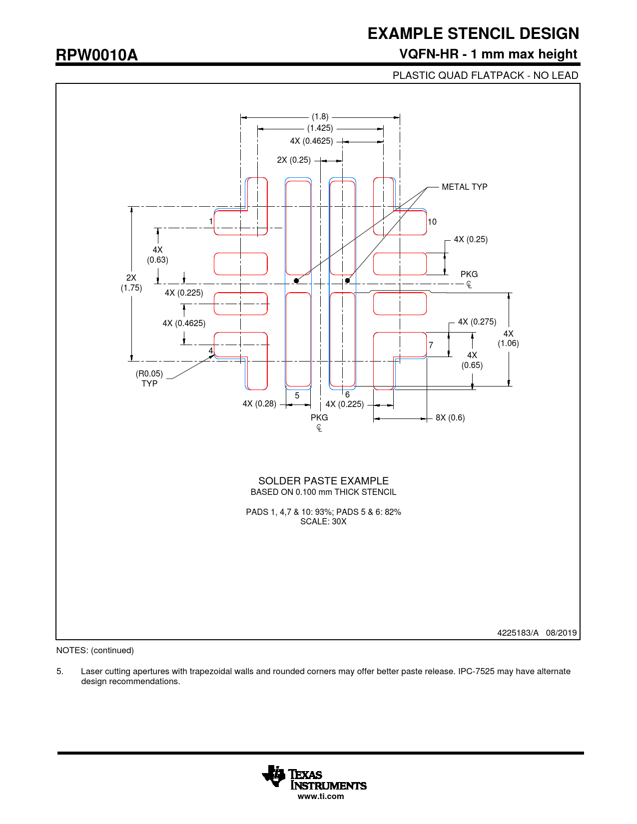

Pages / Page52 / 51 — EXAMPLE STENCIL DESIGN. RPW0010A. VQFN-HR - 1 mm max height. www.ti.com
File Format / SizePDF / 5.1 Mb
EXAMPLE STENCIL DESIGN RPW0010A VQFN-HR - 1 mm max height www.ti.com
PLASTIC QUAD FLATPACK - NO LEAD (1.8) (1.425) 4X (0.4625) 2X (0.25) METAL TYP 1 10 4X (0.25) 4X (0.63) PKG 2X (1.75) 4X (0.225) 4X (0.4625) 4X (0.275) 4X (1.06) 7 4 4X (0.65) (R0.05) TYP 5 6 4X (0.28) 4X (0.225) PKG 8X (0.6) SOLDER PASTE EXAMPLE BASED ON 0.100 mm THICK STENCIL PADS 1, 4,7 & 10: 93%; PADS 5 & 6: 82% SCALE: 30X 4225183/A 08/2019 NOTES: (continued) 5. Laser cutting apertures with trapezoidal walls and rounded corners may offer better paste release. IPC-7525 may have alternate design recommendations.
