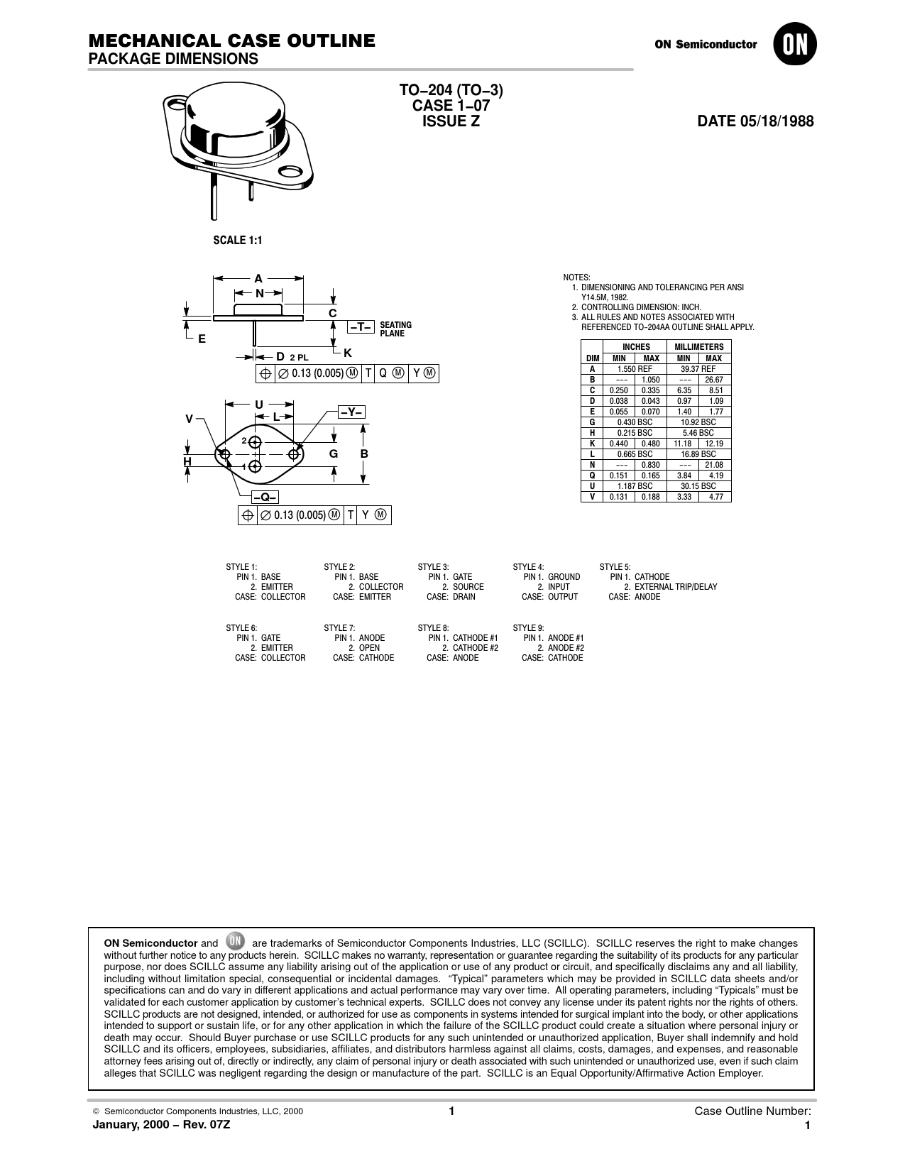

PACKAGE DIMENSIONS. TO−204 (TO−3). CASE 1−07. ISSUE Z. DATE 05/18/1988. SCALE 1:1. −T− SEATING. PLANE. INCHES. MILLIMETERS. D 2 PL. DIM. MIN. MAX
PACKAGE DIMENSIONS TO−204 (TO−3) CASE 1−07 ISSUE Z DATE 05/18/1988 SCALE 1:1 −T− SEATING PLANE INCHES MILLIMETERS D 2 PL DIM MIN MAX
MECHANICAL CASE OUTLINE
NOTES:
A
1. DIMENSIONING AND TOLERANCING PER ANSI
N
Y14.5M, 1982. 2. CONTROLLING DIMENSION: INCH.
C
3. ALL RULES AND NOTES ASSOCIATED WITH
−T− SEATING
REFERENCED TO-204AA OUTLINE SHALL APPLY.
PLANE E INCHES MILLIMETERS K D 2 PL DIM MIN MAX MIN MAX A
1.550 REF 39.37 REF 0.13 (0.005) M T Q M Y M
B
--- 1.050 --- 26.67
C
0.250 0.335 6.35 8.51
D
0.038 0.043 0.97 1.09
U −Y− E
0.055 0.070 1.40 1.77
V L G
0.430 BSC 10.92 BSC
H
0.215 BSC 5.46 BSC
2 K
0.440 0.480 11.18 12.19
G B L
0.665 BSC 16.89 BSC
H 1 N
--- 0.830 --- 21.08
Q
0.151 0.165 3.84 4.19
U
1.187 BSC 30.15 BSC
−Q− V
0.131 0.188 3.33 4.77 0.13 (0.005) M T Y M STYLE 1: STYLE 2: STYLE 3: STYLE 4: STYLE 5: PIN 1. BASE PIN 1. BASE PIN 1. GATE PIN 1. GROUND PIN 1. CATHODE 2. EMITTER 2. COLLECTOR 2. SOURCE 2. INPUT 2. EXTERNAL TRIP/DELAY CASE: COLLECTOR CASE: EMITTER CASE: DRAIN CASE: OUTPUT CASE: ANODE STYLE 6: STYLE 7: STYLE 8: STYLE 9: PIN 1. GATE PIN 1. ANODE PIN 1. CATHODE #1 PIN 1. ANODE #1 2. EMITTER 2. OPEN 2. CATHODE #2 2. ANODE #2 CASE: COLLECTOR CASE: CATHODE CASE: ANODE CASE: CATHODE
