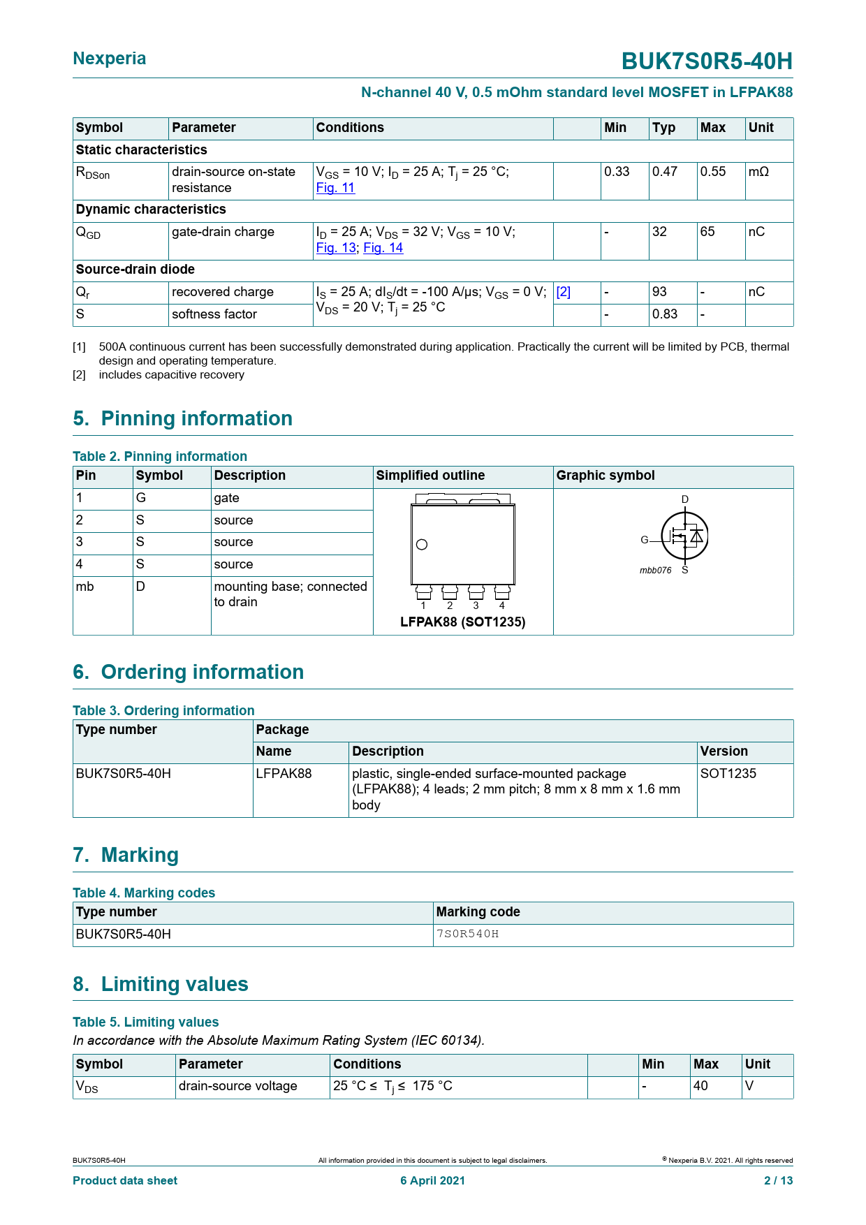

Nexperia. BUK7S0R5-40H. N-channel 40 V, 0.5 mOhm standard level MOSFET in LFPAK88. Symbol. Parameter. Conditions. Min. Typ. Max. Unit
Nexperia BUK7S0R5-40H N-channel 40 V, 0.5 mOhm standard level MOSFET in LFPAK88 Symbol Parameter Conditions Min Typ Max Unit
link to page 7 link to page 8 link to page 8 link to page 2
Nexperia BUK7S0R5-40H N-channel 40 V, 0.5 mOhm standard level MOSFET in LFPAK88 Symbol Parameter Conditions Min Typ Max Unit Static characteristics
RDSon drain-source on-state VGS = 10 V; ID = 25 A; Tj = 25 °C; 0.33 0.47 0.55 mΩ resistance Fig. 11
Dynamic characteristics
QGD gate-drain charge ID = 25 A; VDS = 32 V; VGS = 10 V; - 32 65 nC Fig. 13; Fig. 14
Source-drain diode
Qr recovered charge IS = 25 A; dIS/dt = -100 A/µs; VGS = 0 V; [2] - 93 - nC S softness factor VDS = 20 V; Tj = 25 °C - 0.83 - [1] 500A continuous current has been successfully demonstrated during application. Practically the current will be limited by PCB, thermal design and operating temperature. [2] includes capacitive recovery
5. Pinning information Table 2. Pinning information Pin Symbol Description Simplified outline Graphic symbol
1 G gate D 2 S source 3 S source G 4 S source mbb076 S mb D mounting base; connected to drain 1 2 3 4
LFPAK88 (SOT1235) 6. Ordering information Table 3. Ordering information Type number Package Name Description Version
BUK7S0R5-40H LFPAK88 plastic, single-ended surface-mounted package SOT1235 (LFPAK88); 4 leads; 2 mm pitch; 8 mm x 8 mm x 1.6 mm body
7. Marking Table 4. Marking codes Type number Marking code
BUK7S0R5-40H 7S0R540H
8. Limiting values Table 5. Limiting values
In accordance with the Absolute Maximum Rating System (IEC 60134).
Symbol Parameter Conditions Min Max Unit
VDS drain-source voltage 25 °C ≤ Tj ≤ 175 °C - 40 V BUK7S0R5-40H All information provided in this document is subject to legal disclaimers. © Nexperia B.V. 2021. Al rights reserved
Product data sheet 6 April 2021 2 / 13
