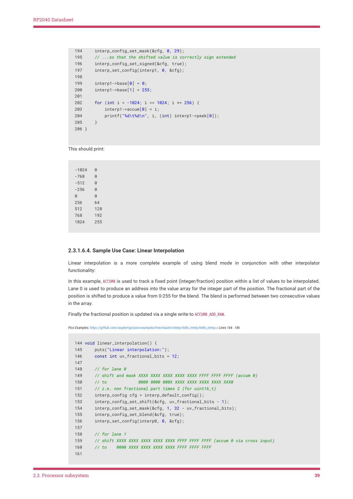

RP2040 Datasheet 194 interp_config_set_mask(&cfg, 0, 29); 195 // ...so that the shifted value is correctly sign extended 196 interp_config_set_signed(&cfg, true); 197 interp_set_config(interp1, 0, &cfg); 198 199 interp1->base[0] = 0; 200 interp1->base[1] = 255; 201 202 for (int i = -1024; i <= 1024; i += 256) { 203 interp1->accum[0] = i; 204 printf("%d\t%d\n", i, (int) interp1->peek[0]); 205 } 206 } This should print: -1024 0 -768 0 -512 0 -256 0 0 0 256 64 512 128 768 192 1024 255
2.3.1.6.4. Sample Use Case: Linear Interpolation
Linear interpolation is a more complete example of using blend mode in conjunction with other interpolator functionality: In this example, ACCUM0 is used to track a fixed point (integer/fraction) position within a list of values to be interpolated. Lane 0 is used to produce an address into the value array for the integer part of the position. The fractional part of the position is shifted to produce a value from 0-255 for the blend. The blend is performed between two consecutive values in the array. Finally the fractional position is updated via a single write to ACCUM0_ADD_RAW. Pico Examples: https://github.com/raspberrypi/pico-examples/tree/master/interp/hello_interp/hello_interp.c Lines 144 - 186 144 void linear_interpolation() { 145 puts("Linear interpolation:"); 146 const int uv_fractional_bits = 12; 147 148 // for lane 0 149 // shift and mask XXXX XXXX XXXX XXXX XXXX FFFF FFFF FFFF (accum 0) 150 // to 0000 0000 000X XXXX XXXX XXXX XXXX XXX0 151 // i.e. non fractional part times 2 (for uint16_t) 152 interp_config cfg = interp_default_config(); 153 interp_config_set_shift(&cfg, uv_fractional_bits - 1); 154 interp_config_set_mask(&cfg, 1, 32 - uv_fractional_bits); 155 interp_config_set_blend(&cfg, true); 156 interp_set_config(interp0, 0, &cfg); 157 158 // for lane 1 159 // shift XXXX XXXX XXXX XXXX XXXX FFFF FFFF FFFF (accum 0 via cross input) 160 // to 0000 XXXX XXXX XXXX XXXX FFFF FFFF FFFF 161 2.3. Processor subsystem
