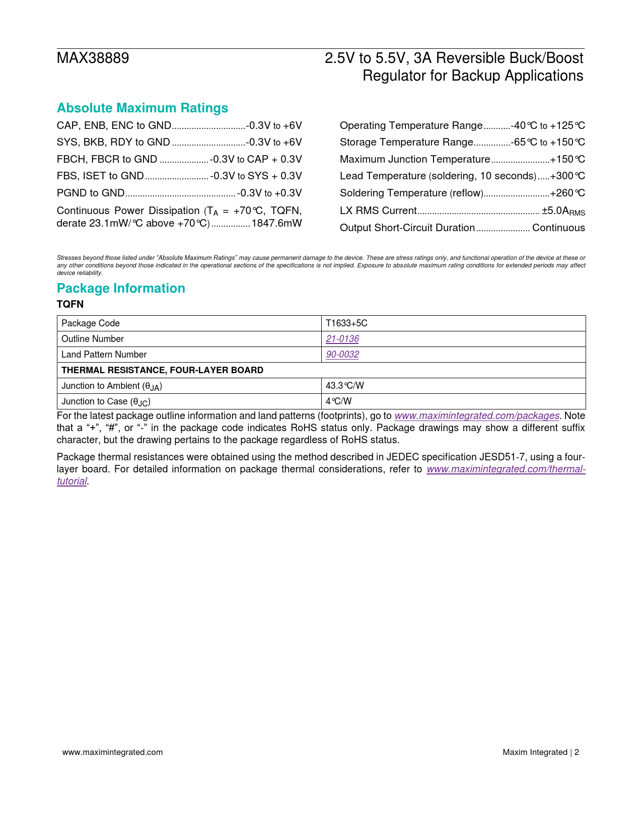

Absolute Maximum Ratings
CAP, ENB, ENC to GND .. -0.3V to +6V Operating Temperature Range ... -40°C to +125°C SYS, BKB, RDY to GND .. -0.3V to +6V Storage Temperature Range ... -65°C to +150°C FBCH, FBCR to GND .. -0.3V to CAP + 0.3V Maximum Junction Temperature .. +150°C FBS, ISET to GND .. -0.3V to SYS + 0.3V Lead Temperature (soldering, 10 seconds) ... +300°C PGND to GND ... -0.3V to +0.3V Soldering Temperature (reflow)... +260°C Continuous Power Dissipation (TA = +70°C, TQFN, LX RMS Current .. ±5.0ARMS derate 23.1mW/°C above +70°C) .. 1847.6mW Output Short-Circuit Duration .. Continuous Stresses beyond those listed under “Absolute Maximum Ratings” may cause permanent damage to the device. These are stress ratings only, and functional operation of the device at these or any other conditions beyond those indicated in the operational sections of the specifications is not implied. Exposure to absolute maximum rating conditions for extended periods may affect device reliability.
Package Information TQFN
Package Code T1633+5C Outline Number 21-0136 Land Pattern Number 90-0032
THERMAL RESISTANCE, FOUR-LAYER BOARD
