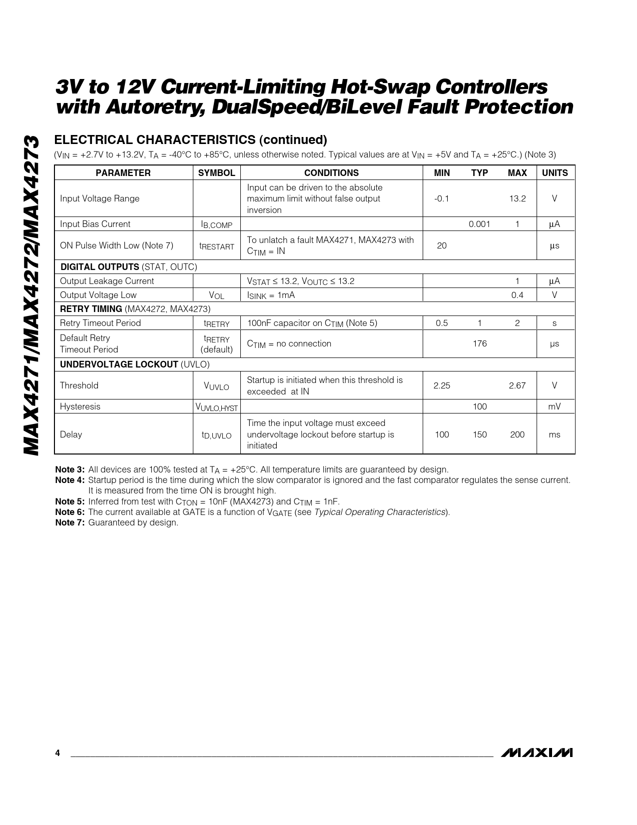

3V to 12V Current-Limiting Hot-Swap Controllers with Autoretry, DualSpeed/BiLevel Fault Protection ELECTRICAL CHARACTERISTICS (continued)
(VIN = +2.7V to +13.2V, TA = -40°C to +85°C, unless otherwise noted. Typical values are at VIN = +5V and TA = +25°C.) (Note 3)
PARAMETER SYMBOL CONDITIONS MIN TYP MAX UNITS
Input can be driven to the absolute Input Voltage Range maximum limit without false output -0.1 13.2 V inversion Input Bias Current IB,COMP 0.001 1 μA To unlatch a fault MAX4271, MAX4273 with ON Pulse Width Low (Note 7) tRESTART 20 μs CTIM = IN
DIGITAL OUTPUTS
(STAT, OUTC) Output Leakage Current VSTAT ≤ 13.2, VOUTC ≤ 13.2 1 μA Output Voltage Low VOL ISINK = 1mA 0.4 V
RETRY TIMING
(MAX4272, MAX4273) Retry Timeout Period tRETRY 100nF capacitor on CTIM (Note 5) 0.5 1 2 s Default Retry tRETRY CTIM = no connection 176 µs Timeout Period (default)
UNDERVOLTAGE LOCKOUT
(UVLO) Startup is initiated when this threshold is Threshold VUVLO 2.25 2.67 V exceeded at IN Hysteresis V U V LO,H YS T 100 mV Time the input voltage must exceed Delay tD,UVLO undervoltage lockout before startup is 100 150 200 ms
MAX4271/MAX4272/MAX4273
initiated
Note 3:
All devices are 100% tested at TA = +25°C. All temperature limits are guaranteed by design.
Note 4:
Startup period is the time during which the slow comparator is ignored and the fast comparator regulates the sense current. It is measured from the time ON is brought high.
Note 5:
Inferred from test with CTON = 10nF (MAX4273) and CTIM = 1nF.
Note 6:
The current available at GATE is a function of VGATE (see Typical Operating Characteristics).
Note 7:
Guaranteed by design.
