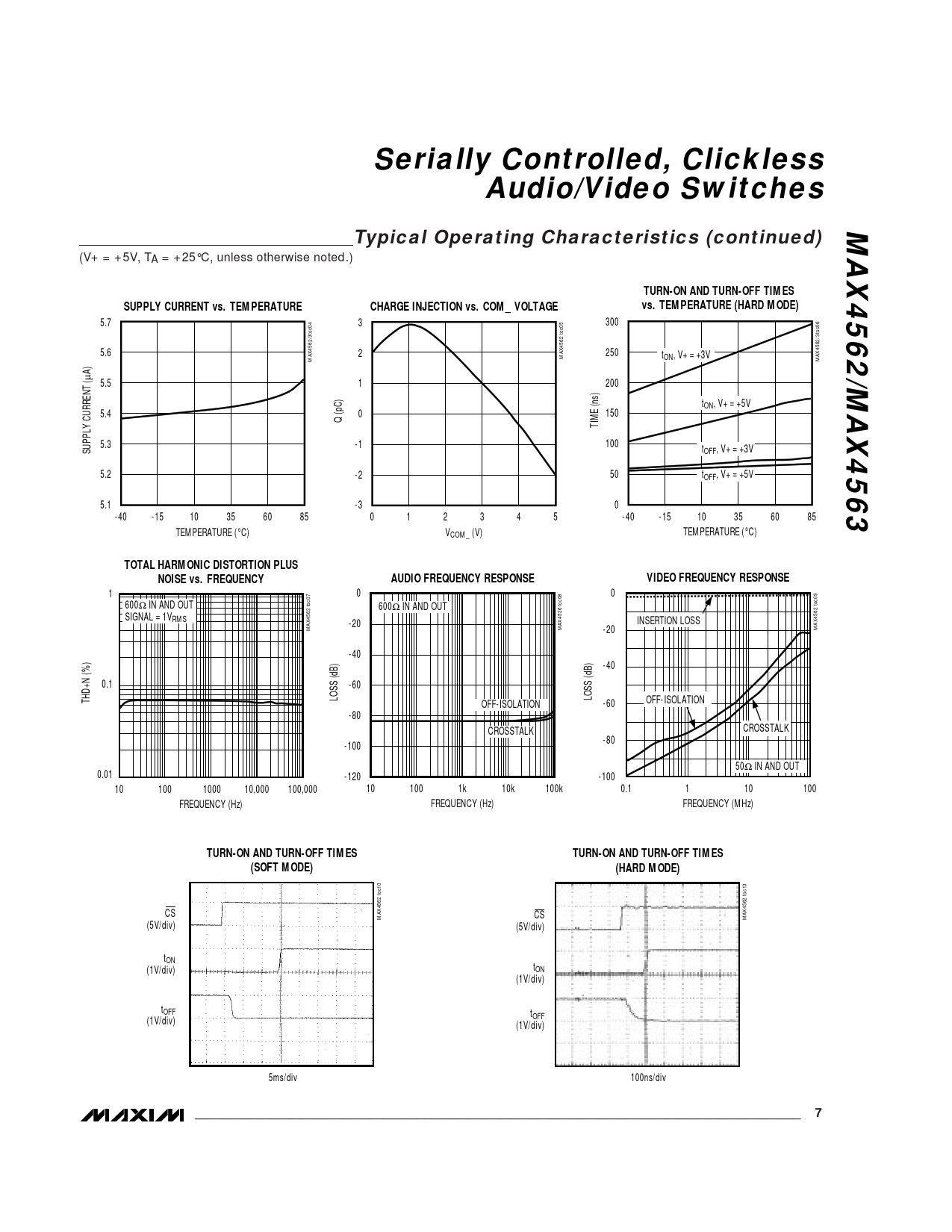

Serially Controlled, Clickless. Audio/Video Switches. MAX4562/MAX4563. Typical Operating Characteristics (continued)
Serially Controlled, Clickless Audio/Video Switches MAX4562/MAX4563 Typical Operating Characteristics (continued)
(V+ = +5V, TA = +25°C, unless otherwise noted.)
TURN-ON AND TURN-OFF TIMES SUPPLY CURRENT vs. TEMPERATURE CHARGE INJECTION vs. COM_ VOLTAGE vs. TEMPERATURE (HARD MODE)
5.7 3 300 5.6 2 250 MAX4562 toc05 t MAX4562/3toc04 ON, V+ = +3V MAX4562/3toc06 µA) 5.5 1 200 tON, V+ = +5V 5.4 0 150 Q (pC) TIME (ns) 5.3 -1 100 SUPPLY CURRENT ( tOFF, V+ = +3V 5.2 -2 50 tOFF, V+ = +5V 5.1 -3 0 -40 -15 10 35 60 85 0 1 2 3 4 5 -40 -15 10 35 60 85 TEMPERATURE (°C) VCOM_ (V) TEMPERATURE (°C)
TOTAL HARMONIC DISTORTION PLUS NOISE vs. FREQUENCY AUDIO FREQUENCY RESPONSE VIDEO FREQUENCY RESPONSE
1 0 0 600Ω IN AND OUT 600Ω IN AND OUT SIGNAL = 1VRMS -20 INSERTION LOSS MAX4562 toc07 MAX4526 toc08 -20 MAX4562 toc09 -40 -40 0.1 -60 THD+N (%) LOSS (dB) LOSS (dB) OFF-ISOLATION OFF-ISOLATION -60 -80 CROSSTALK CROSSTALK -80 -100 50Ω IN AND OUT 0.01 -120 -100 10 100 1000 10,000 100,000 10 100 1k 10k 100k 0.1 1 10 100 FREQUENCY (Hz) FREQUENCY (Hz) FREQUENCY (MHz)
TURN-ON AND TURN-OFF TIMES TURN-ON AND TURN-OFF TIMES (SOFT MODE) (HARD MODE)
CS MAX4562 toc10 CS MAX4562 toc13 (5V/div) (5V/div) tON (1V/div) tON (1V/div) tOFF tOFF (1V/div) (1V/div) 5ms/div 100ns/div
