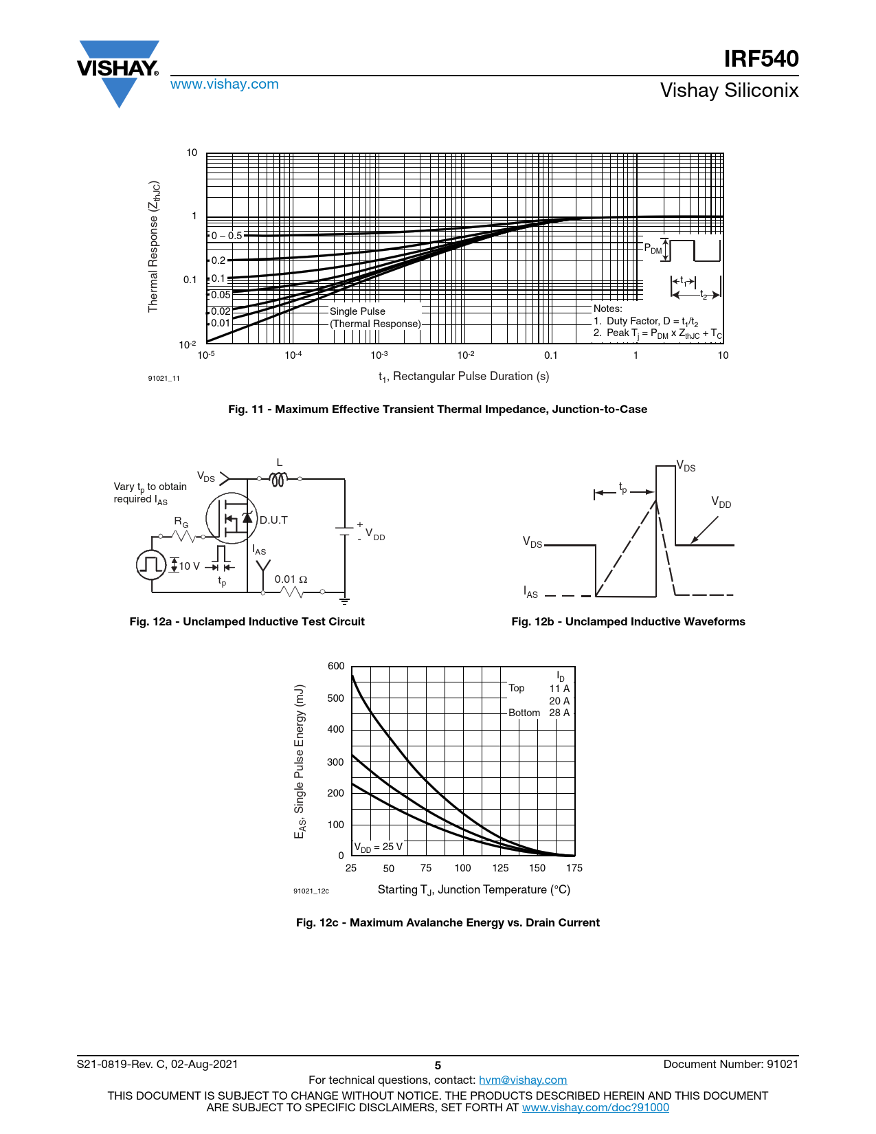

Pages / Page8 / 5 — IRF540. Fig. 11 - Maximum Effective Transient Thermal Impedance, …
File Format / SizePDF / 155 Kb
IRF540. Fig. 11 - Maximum Effective Transient Thermal Impedance, Junction-to-Case
IRF540 Fig 11 - Maximum Effective Transient Thermal Impedance, Junction-to-Case
IRF540
www.vishay.com Vishay Siliconix 10 ) thJC 1 0 − 0.5 PDM 0.2 0.1 0.1 t1 mal Response (Z t 0.05 2 Ther Notes: 0.02 Single Pulse 1. Duty Factor, D = t /t 0.01 (Thermal Response) 1 2 2. Peak T = P x Z + T j DM thJC C 10-2 10-5 10-4 10-3 10-2 0.1 1 10 91021_11 t1, Rectangular Pulse Duration (s)
L VDS VDS Vary t t p to obtain p required IAS VDD R D.U.T G + V - DD V I DS AS 10 V t 0.01 p Ω IAS
Fig. 12a - Unclamped Inductive Test Circuit Fig. 12b - Unclamped Inductive Waveforms
600 ID Top 11 A 500 20 A Bottom 28 A 400 300 200 , Single Pulse Energy (mJ) 100 ASE V = 25 V DD 0 25 50 75 100 125 150 175 91021_12c Starting TJ, Junction Temperature (°C)
Fig. 12c - Maximum Avalanche Energy vs. Drain Current
