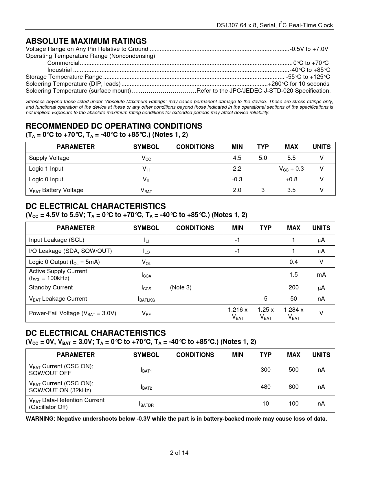

ABSOLUTE MAXIMUM RATINGS. RECOMMENDED DC OPERATING CONDITIONS (TA = 0°C to +70°C, TA = -40°C to +85°C.) (Notes 1, 2)
ABSOLUTE MAXIMUM RATINGS RECOMMENDED DC OPERATING CONDITIONS (TA = 0°C to +70°C, TA = -40°C to +85°C.) (Notes 1, 2)
DS1307 64 x 8, Serial, I2C Real-Time Clock
Voltage Range on Any Pin Relative to Ground .. -0.5V to +7.0V Operating Temperature Range (Noncondensing) Commercial .. 0°C to +70°C Industrial .. -40°C to +85°C Storage Temperature Range ... -55°C to +125°C Soldering Temperature (DIP, leads) .. +260°C for 10 seconds Soldering Temperature (surface mount)…..……………………….Refer to the JPC/JEDEC J-STD-020 Specification. Stresses beyond those listed under “Absolute Maximum Ratings” may cause permanent damage to the device. These are stress ratings only, and functional operation of the device at these or any other conditions beyond those indicated in the operational sections of the specifications is not implied. Exposure to the absolute maximum rating conditions for extended periods may affect device reliability.
RECOMMENDED DC OPERATING CONDITIONS (TA = 0°C to +70°C, TA = -40°C to +85°C.) (Notes 1, 2) PARAMETER SYMBOL CONDITIONS MIN TYP MAX UNITS
Supply Voltage VCC 4.5 5.0 5.5 V Logic 1 Input VIH 2.2 VCC + 0.3 V Logic 0 Input VIL -0.3 +0.8 V VBAT Battery Voltage VBAT 2.0 3 3.5 V
DC ELECTRICAL CHARACTERISTICS (VCC = 4.5V to 5.5V; TA = 0°C to +70°C, TA = -40°C to +85°C.) (Notes 1, 2) PARAMETER SYMBOL CONDITIONS MIN TYP MAX UNITS
Input Leakage (SCL) ILI -1 1 µA I/O Leakage (SDA, SQW/OUT) ILO -1 1 µA Logic 0 Output (IOL = 5mA) VOL 0.4 V Active Supply Current I (f CCA 1.5 mA SCL = 100kHz) Standby Current ICCS (Note 3) 200 µA VBAT Leakage Current IBATLKG 5 50 nA 1.216 x 1.25 x 1.284 x Power-Fail Voltage (VBAT = 3.0V) VPF V VBAT VBAT VBAT
DC ELECTRICAL CHARACTERISTICS (VCC = 0V, VBAT = 3.0V; TA = 0°C to +70°C, TA = -40°C to +85°C.) (Notes 1, 2) PARAMETER SYMBOL CONDITIONS MIN TYP MAX UNITS
VBAT Current (OSC ON); I SQW/OUT OFF BAT1 300 500 nA VBAT Current (OSC ON); I SQW/OUT ON (32kHz) BAT2 480 800 nA VBAT Data-Retention Current I (Oscillator Off) BATDR 10 100 nA
WARNING: Negative undershoots below -0.3V while the part is in battery-backed mode may cause loss of data.
