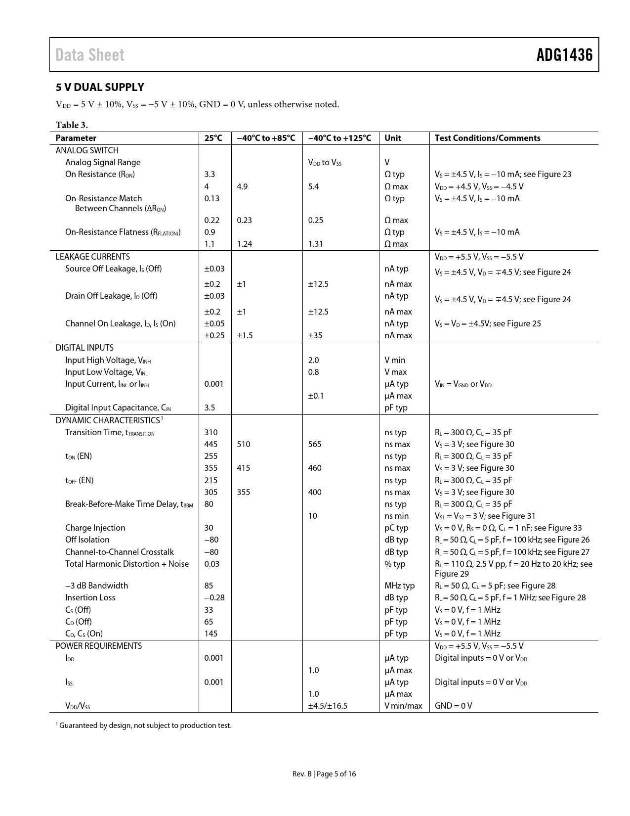

Data Sheet. ADG1436. 5 V DUAL SUPPLY. Table 3. Parameter. 25°C. −40°C to +85°C. −40°C to +125°C. Unit. Test Conditions/Comments
Data Sheet ADG1436 5 V DUAL SUPPLY Table 3 Parameter 25°C −40°C to +85°C −40°C to +125°C Unit Test Conditions/Comments
link to page 13 link to page 13 link to page 13 link to page 13 link to page 14 link to page 14 link to page 14 link to page 14 link to page 15 link to page 13 link to page 13 link to page 14 link to page 13 link to page 13
VDD = 5 V ± 10%, VSS = −5 V ± 10%, GND = 0 V, unless otherwise noted.
Table 3. Parameter 25°C −40°C to +85°C −40°C to +125°C Unit Test Conditions/Comments
ANALOG SWITCH Analog Signal Range VDD to VSS V On Resistance (RON) 3.3 Ω typ VS = ±4.5 V, IS = −10 mA; see Figure 23 4 4.9 5.4 Ω max VDD = +4.5 V, VSS = −4.5 V On-Resistance Match 0.13 Ω typ VS = ±4.5 V, IS = −10 mA Between Channels (∆RON) 0.22 0.23 0.25 Ω max On-Resistance Flatness (RFLAT(ON)) 0.9 Ω typ VS = ±4.5 V, IS = −10 mA 1.1 1.24 1.31 Ω max LEAKAGE CURRENTS VDD = +5.5 V, VSS = −5.5 V Source Off Leakage, IS (Off) ±0.03 nA typ VS = ±4.5 V, VD = ∓4.5 V; see Figure 24 ±0.2 ±1 ±12.5 nA max Drain Off Leakage, ID (Off) ±0.03 nA typ VS = ±4.5 V, VD = ∓4.5 V; see Figure 24 ±0.2 ±1 ±12.5 nA max Channel On Leakage, ID, IS (On) ±0.05 nA typ VS = VD = ±4.5V; see Figure 25 ±0.25 ±1.5 ±35 nA max DIGITAL INPUTS Input High Voltage, VINH 2.0 V min Input Low Voltage, VINL 0.8 V max Input Current, IINL or IINH 0.001 µA typ VIN = VGND or VDD ±0.1 µA max Digital Input Capacitance, CIN 3.5 pF typ DYNAMIC CHARACTERISTICS1 Transition Time, tTRANSITION 310 ns typ RL = 300 Ω, CL = 35 pF 445 510 565 ns max VS = 3 V; see Figure 30 tON (EN) 255 ns typ RL = 300 Ω, CL = 35 pF 355 415 460 ns max VS = 3 V; see Figure 30 tOFF (EN) 215 ns typ RL = 300 Ω, CL = 35 pF 305 355 400 ns max VS = 3 V; see Figure 30 Break-Before-Make Time Delay, tBBM 80 ns typ RL = 300 Ω, CL = 35 pF 10 ns min VS1 = VS2 = 3 V; see Figure 31 Charge Injection 30 pC typ VS = 0 V, RS = 0 Ω, CL = 1 nF; see Figure 33 Off Isolation −80 dB typ RL = 50 Ω, CL = 5 pF, f = 100 kHz; see Figure 26 Channel-to-Channel Crosstalk −80 dB typ RL = 50 Ω, CL = 5 pF, f = 100 kHz; see Figure 27 Total Harmonic Distortion + Noise 0.03 % typ RL = 110 Ω, 2.5 V pp, f = 20 Hz to 20 kHz; see Figure 29 −3 dB Bandwidth 85 MHz typ RL = 50 Ω, CL = 5 pF; see Figure 28 Insertion Loss −0.28 dB typ RL = 50 Ω, CL = 5 pF, f = 1 MHz; see Figure 28 CS (Off) 33 pF typ VS = 0 V, f = 1 MHz CD (Off) 65 pF typ VS = 0 V, f = 1 MHz CD, CS (On) 145 pF typ VS = 0 V, f = 1 MHz POWER REQUIREMENTS VDD = +5.5 V, VSS = −5.5 V IDD 0.001 µA typ Digital inputs = 0 V or VDD 1.0 µA max ISS 0.001 µA typ Digital inputs = 0 V or VDD 1.0 µA max VDD/VSS ±4.5/±16.5 V min/max GND = 0 V 1 Guaranteed by design, not subject to production test. Rev. B | Page 5 of 16 Document Outline Features Applications Functional Block Diagrams General Description Product Highlights Revision History Specifications 15 V Dual Supply 12 V Single Supply 5 V Dual Supply Continuous Current per Channel Absolute Maximum Ratings ESD Caution Pin Configurations and Function Descriptions Truth Table For Switches Typical Performance Characteristics Terminology Test Circuits Outline Dimensions Ordering Guide
