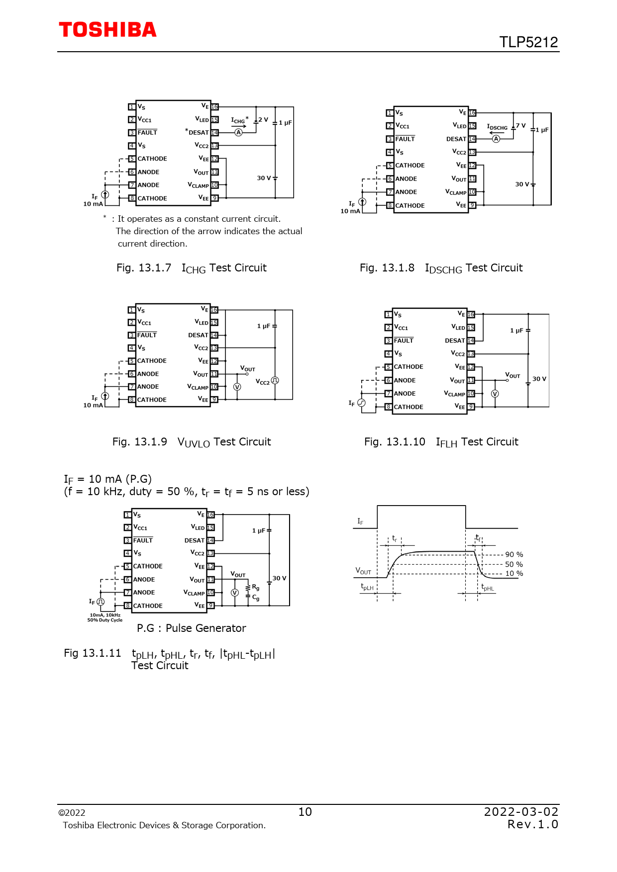

TLP5212. *. :. It. operates. as. a. constant. current. circuit. The. direction. of. the. arrow. indicates. the. actual. current. direction. Fig. 13.1.7. ICHG. Test
TLP5212 * : It operates as a constant current circuit The direction of the arrow indicates the actual current direction Fig 13.1.7 ICHG Test
TLP5212 * : It operates as a constant current circuit. The direction of the arrow indicates the actual current direction. Fig. 13.1.7 ICHG Test Circuit Fig. 13.1.8 IDSCHG Test Circuit Fig. 13.1.9 VUVLO Test Circuit Fig. 13.1.10 IFLH Test Circuit IF = 10 mA (P.G) (f = 10 kHz, duty = 50 %, tr = tf = 5 ns or less) P.G : Pulse Generator Fig 13.1.11 tpLH, tpHL, tr, tf, |tpHL-tpLH| Test Circuit ©2022 10 2022-03-02 Toshiba Electronic Devices & Storage Corporation. Rev.1.0
