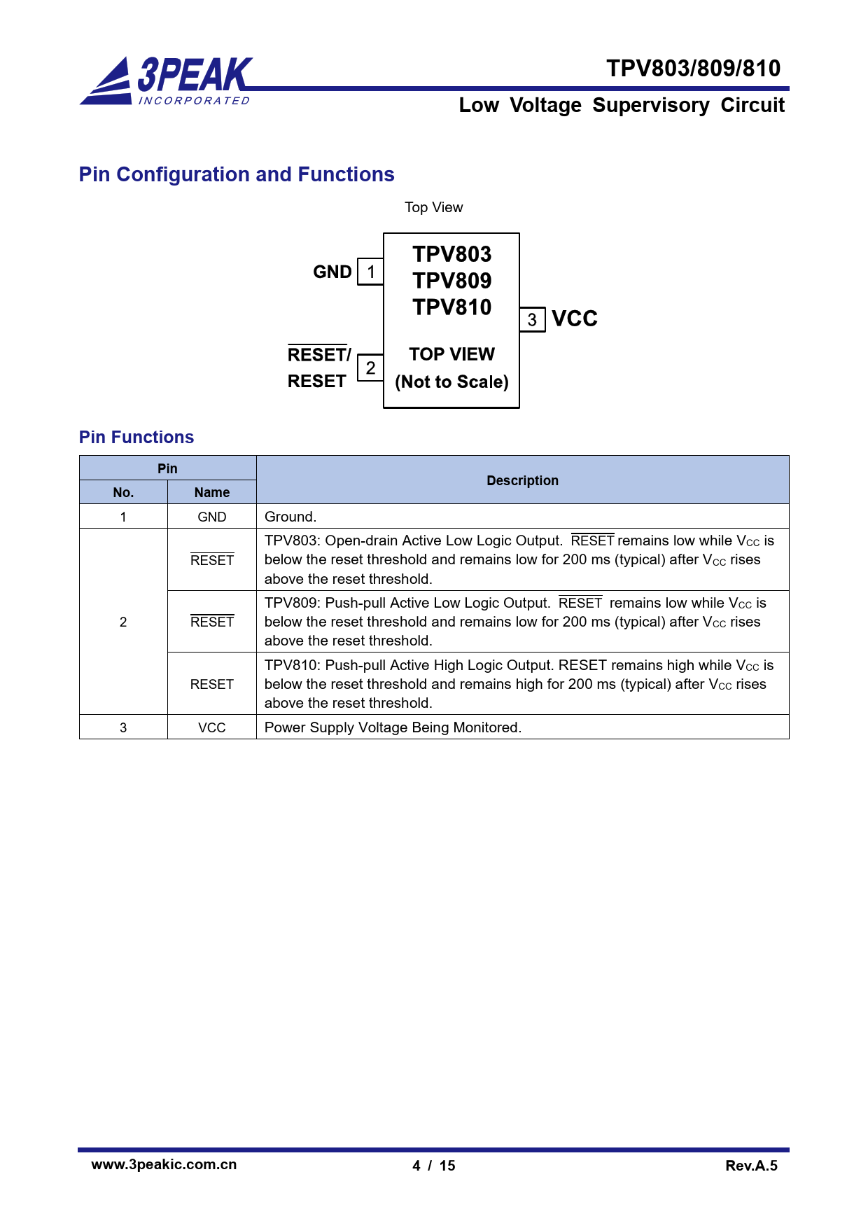

TPV803/809/810. Low Voltage Supervisory Circuit. Pin Configuration and Functions. Pin Functions. Pin. Description. No. Name
TPV803/809/810 Low Voltage Supervisory Circuit Pin Configuration and Functions Pin Functions Pin Description No Name
Top View
Pin Functions Pin Description No. Name
1 GND Ground. TPV803: Open-drain Active Low Logic Output. RESET remains low while VCC is RESET below the reset threshold and remains low for 200 ms (typical) after VCC rises above the reset threshold. TPV809: Push-pull Active Low Logic Output. RESET remains low while VCC is 2 RESET below the reset threshold and remains low for 200 ms (typical) after VCC rises above the reset threshold. TPV810: Push-pull Active High Logic Output. RESET remains high while VCC is RESET below the reset threshold and remains high for 200 ms (typical) after VCC rises above the reset threshold. 3 VCC Power Supply Voltage Being Monitored.
