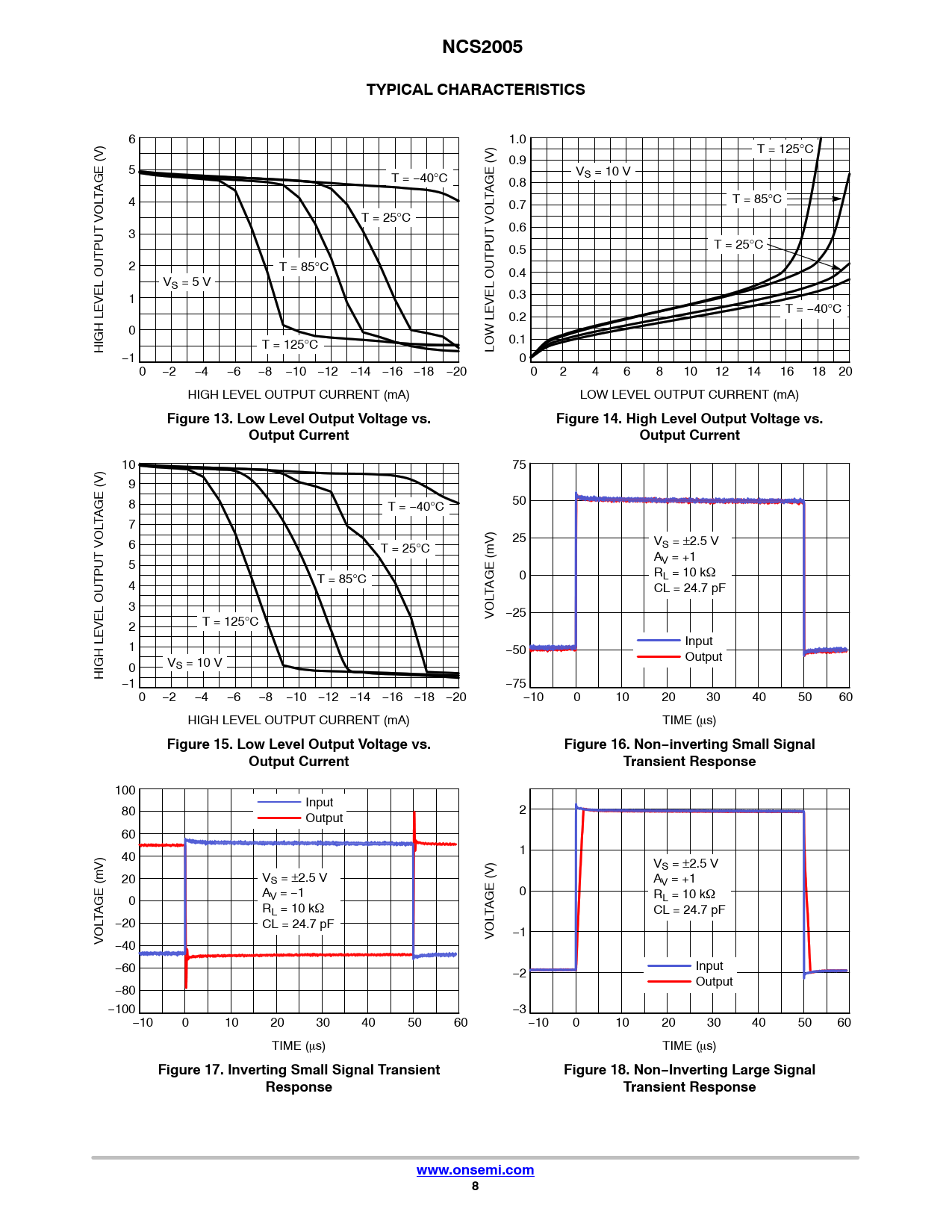

| Manufacturer | ON Semiconductor |
| Description | Operational Amplifier, Low Power, 8 MHz GBW, Rail-to-Rail Input-Output |
| Pages / Page | 11 / 8 — NCS2005. TYPICAL CHARACTERISTICS. Figure 13. Low Level Output Voltage vs. … |
| File Format / Size | PDF / 579 Kb |
NCS2005. TYPICAL CHARACTERISTICS. Figure 13. Low Level Output Voltage vs. Figure 14. High Level Output Voltage vs
NCS2005 TYPICAL CHARACTERISTICS
6 1.0 T = 125°C 0.9 5 T = −40°C VS = 10 V 0.8 TAGE (V) 4 TAGE (V) 0.7 T = 85°C T = 25°C 3 0.6 0.5 T = 25°C 2 T = 85°C 0.4 VS = 5 V 1 0.3 T = −40 0.2 °C 0 0.1 HIGH LEVEL OUTPUT VOL T = 125°C LOW LEVEL OUTPUT VOL −1 0 0 −2 −4 −6 −8 −10 −12 −14 −16 −18 −20 0 2 4 6 8 10 12 14 16 18 20 HIGH LEVEL OUTPUT CURRENT (mA) LOW LEVEL OUTPUT CURRENT (mA)
Figure 13. Low Level Output Voltage vs. Figure 14. High Level Output Voltage vs. Output Current Output Current
10 75 9 8 50 T = −40°C TAGE (V) 7 25 6 T = 25 V °C S = ±2.5 V A 5 V = +1 0 RL = 10 kW 4 T = 85°C TAGE (mV) CL = 24.7 pF 3 VOL −25 2 T = 125°C 1 Input −50 Output 0 VS = 10 V HIGH LEVEL OUTPUT VOL −1 −75 0 −2 −4 −6 −8 −10 −12 −14 −16 −18 −20 −10 0 10 20 30 40 50 60 HIGH LEVEL OUTPUT CURRENT (mA) TIME (ms)
Figure 15. Low Level Output Voltage vs. Figure 16. Non−inverting Small Signal Output Current Transient Response
100 Input 80 2 Output 60 40 1 VS = ±2.5 V 20 VS = ±2.5 V AV = +1 A 0 V = −1 RL = 10 kW 0 R TAGE (mV) L = 10 kW TAGE (V) CL = 24.7 pF −20 CL = 24.7 pF VOL −1 VOL −40 −60 −2 Input Output −80 −100 −3 −10 0 10 20 30 40 50 60 −10 0 10 20 30 40 50 60 TIME (ms) TIME (ms)
Figure 17. Inverting Small Signal Transient Figure 18. Non−Inverting Large Signal Response Transient Response www.onsemi.com 8
