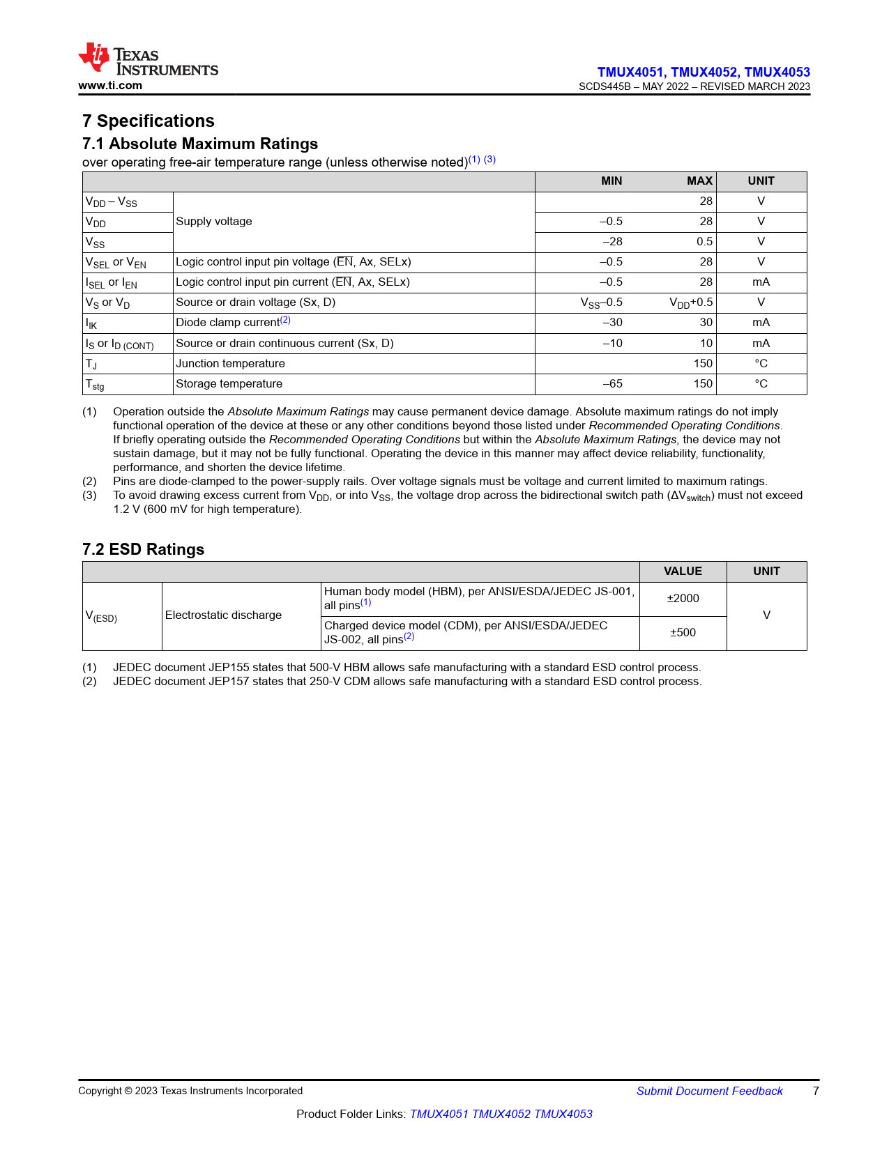

TMUX4051, TMUX4052. , TMUX4053. www.ti.com. 7 Specifications 7.1 Absolute Maximum Ratings. MIN. MAX. UNIT. 7.2 ESD Ratings. VALUE
link to page 7 link to page 7 link to page 7 link to page 7 link to page 7
TMUX4051, TMUX4052 , TMUX4053 www.ti.com
SCDS445B – MAY 2022 – REVISED MARCH 2023
over operating free-air temperature range (unless otherwise noted)(1) (3)
MIN MAX UNIT
VDD – VSS 28 V VDD Supply voltage –0.5 28 V VSS –28 0.5 V VSEL or VEN Logic control input pin voltage (EN, Ax, SELx) –0.5 28 V ISEL or IEN Logic control input pin current (EN, Ax, SELx) –0.5 28 mA VS or VD Source or drain voltage (Sx, D) VSS–0.5 VDD+0.5 V IIK Diode clamp current(2) –30 30 mA IS or ID (CONT) Source or drain continuous current (Sx, D) –10 10 mA TJ Junction temperature 150 °C Tstg Storage temperature –65 150 °C (1) Operation outside the Absolute Maximum Ratings may cause permanent device damage. Absolute maximum ratings do not imply functional operation of the device at these or any other conditions beyond those listed under Recommended Operating Conditions. If briefly operating outside the Recommended Operating Conditions but within the Absolute Maximum Ratings, the device may not sustain damage, but it may not be fully functional. Operating the device in this manner may affect device reliability, functionality, performance, and shorten the device lifetime. (2) Pins are diode-clamped to the power-supply rails. Over voltage signals must be voltage and current limited to maximum ratings. (3) To avoid drawing excess current from VDD, or into VSS, the voltage drop across the bidirectional switch path (ΔVswitch) must not exceed 1.2 V (600 mV for high temperature).
7.2 ESD Ratings VALUE UNIT
Human body model (HBM), per ANSI/ESDA/JEDEC JS-001, all pins(1) ±2000 V(ESD) Electrostatic discharge V Charged device model (CDM), per ANSI/ESDA/JEDEC JS-002, all pins(2) ±500 (1) JEDEC document JEP155 states that 500-V HBM allows safe manufacturing with a standard ESD control process. (2) JEDEC document JEP157 states that 250-V CDM allows safe manufacturing with a standard ESD control process. Copyright © 2023 Texas Instruments Incorporated Submit Document Feedback 7 Product Folder Links: TMUX4051 TMUX4052 TMUX4053 Document Outline 1 Features 2 Applications 3 Description Table of Contents 4 Revision History 5 Device Comparison Table 6 Pin Configuration and Functions 7 Specifications 7.1 Absolute Maximum Ratings 7.2 ESD Ratings 7.3 Thermal Information: TMUX405x 7.4 Recommended Operating Conditions 7.5 Electrical Characteristics 7.6 AC Performance Characteristics 7.7 Timing Characteristics 7.8 Typical Characteristics 8 Parameter Measurement Information 8.1 On-Resistance 8.2 Off-Leakage Current 8.3 On-Leakage Current 8.4 Transition Time 8.5 Break-Before-Make 8.6 tON(EN) and tOFF(EN) 8.7 Propagation Delay 8.8 Charge Injection 8.9 Off Isolation 8.10 Crosstalk 8.11 Bandwidth 9 Detailed Description 9.1 Overview 9.2 Functional Block Diagram 9.3 Feature Description 9.3.1 Bidirectional Operation 9.3.2 Rail-to-Rail Operation 9.3.3 1.8 V Logic Compatible Inputs 9.3.4 Device Functional Modes 9.3.5 Truth Tables 10 Application and Implementation 10.1 Application Information 10.2 Typical Application 10.3 Design Requirements 10.4 Detailed Design Procedure 10.5 Application Curves 10.6 Power Supply Recommendations 10.7 Layout 10.7.1 Layout Guidelines 10.7.2 Layout Example 11 Device and Documentation Support 11.1 Documentation Support 11.1.1 Related Documentation 11.2 Receiving Notification of Documentation Updates 11.3 Support Resources 11.4 Trademarks 11.5 Electrostatic Discharge Caution 11.6 Glossary 12 Mechanical, Packaging, and Orderable Information Sheets and Views 4224642(B)-02_PKG_OUTLINE 4224642(B)-03_BOARD_LAYOUT 4224642(B)-04_STENCIL Sheets and Views 4224640-02_PKG_OULINE 4224640-03_BOARD_LAYOUT 4224640-04_STENCIL
