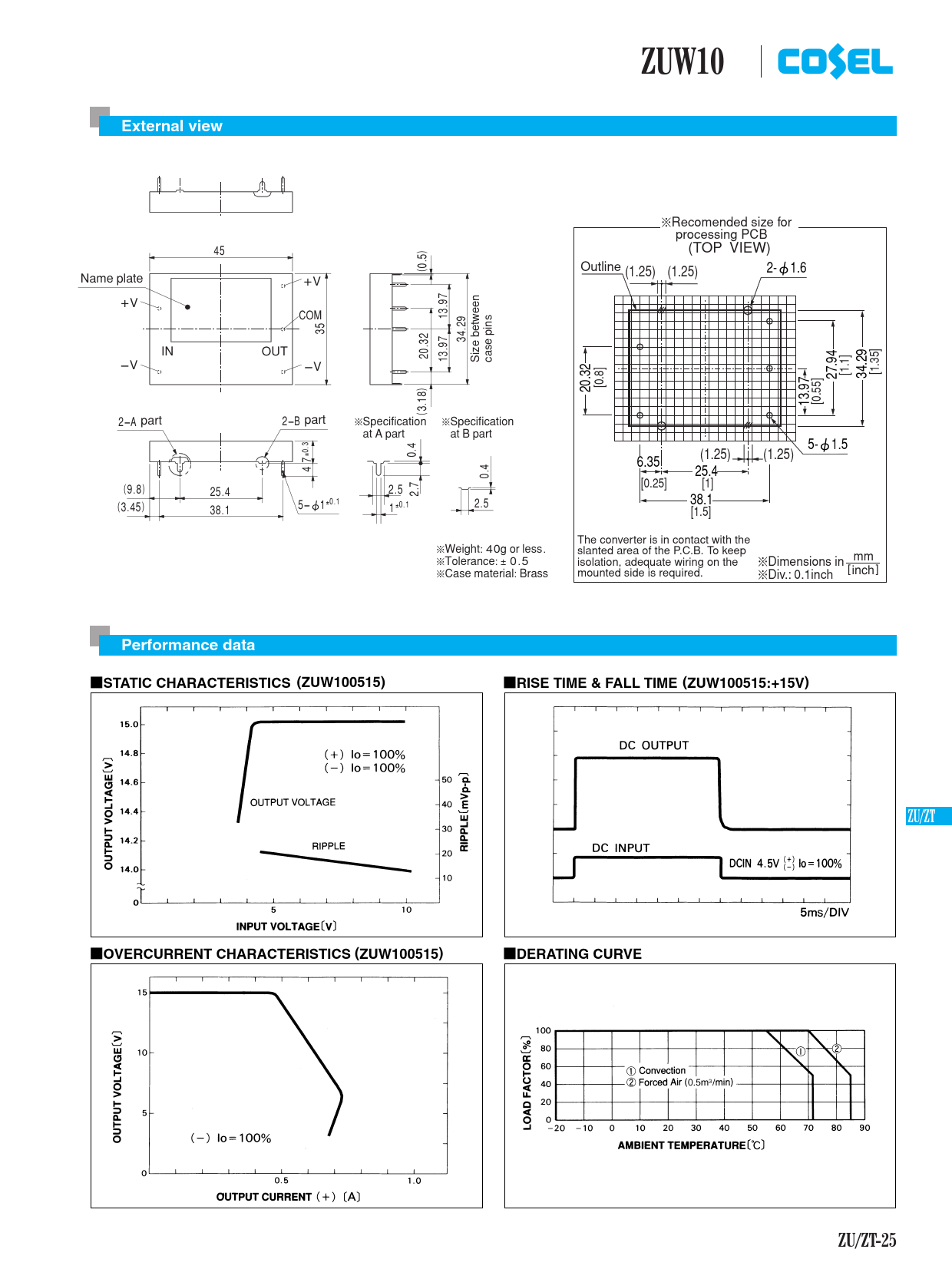

Pages / Page2 / 2 — ZUW10. External view. Performance data. STATIC CHARACTERISTICS …
File Format / SizePDF / 108 Kb
ZUW10. External view. Performance data. STATIC CHARACTERISTICS (ZUW100515). RISE TIME & FALL TIME (ZUW100515:+15V). ZU/ZT
ZUW10 External view Performance data STATIC CHARACTERISTICS (ZUW100515) RISE TIME & FALL TIME (ZUW100515:+15V) ZU/ZT
ZUW10 External view
¶Recomended size for processing PCB 45 (TOP VIEW) Outline (0.5) (1.25) (1.25) 2-º1.6 Name plate +V +V COM 13.97 35 34.29 IN OUT 20.32 13.97 Size between case pins -V -V 27.94 [1.1] 34.29 [1.35] 20.32 [0.8] 13.97 [0.55] (3.18) 2-A part 2-B part ¶Specification ¶Specification at A part at B part 5-º1.5 ±0.3 0.4 (1.25) (1.25) 7 6.35 4 25.4 0.4 [0.25] [1] (9.8) 25.4 2.5 2.7 38.1 (3.45) º 2.5 38.1 5- 1±0.1 1±0.1 [1.5] The converter is in contact with the ¶Weight: 40g or less. slanted area of the P.C.B. To keep mm ¶Tolerance: ± 0.5 isolation, adequate wiring on the ¶Dimensions in ¶Case material: Brass mounted side is required. ¶Div.: 0.1inch [inch]
Performance data
OVERCURRENT CHARACTERISTICS (ZUW100515)
DERATING CURVE
