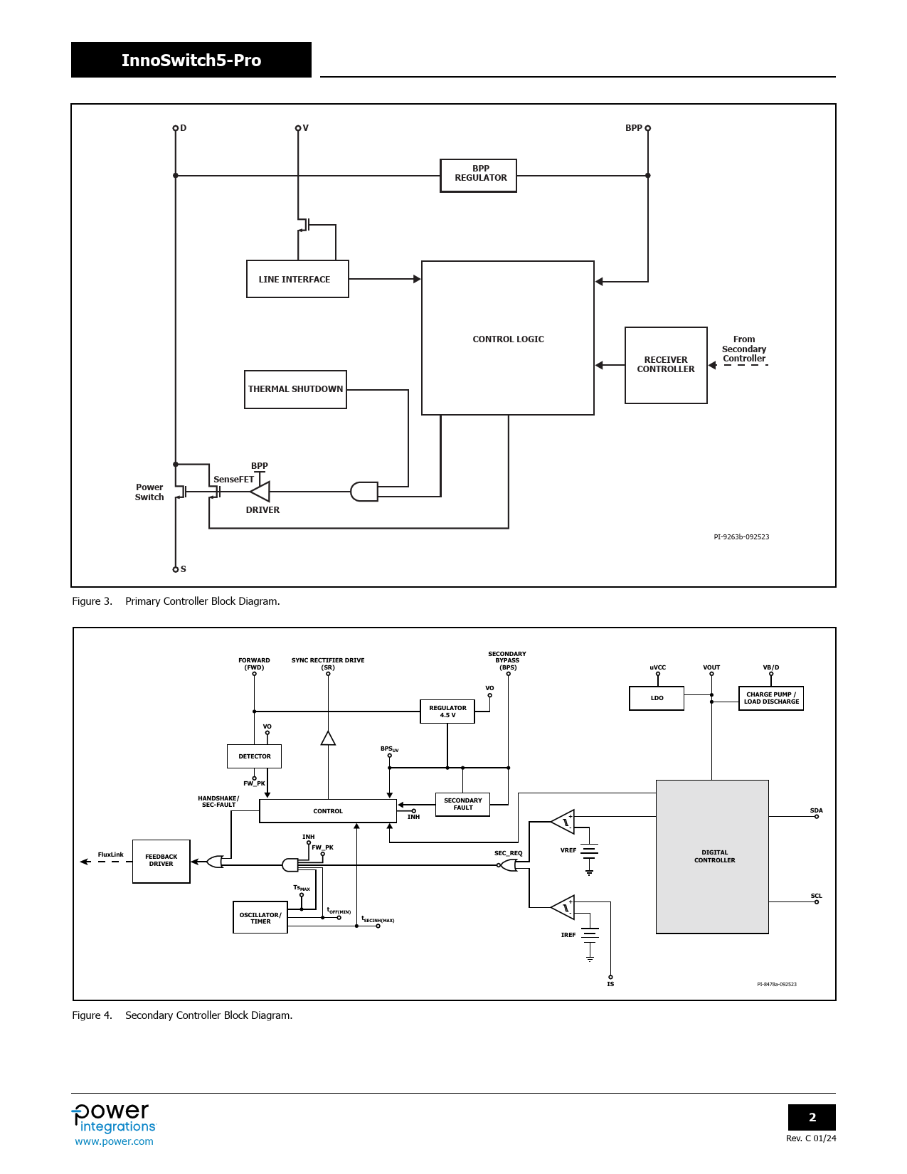

InnoSwitch5-Pro. BPP. REGULATOR. LINE INTERFACE. CONTROL LOGIC. From. Secondary. RECEIVER. Controller. CONTROLLER. THERMAL SHUTDOWN. SenseFET
InnoSwitch5-Pro D V BPP BPP REGULATOR LINE INTERFACE CONTROL LOGIC From Secondary RECEIVER Controller CONTROLLER THERMAL SHUTDOWN BPP SenseFET Power Switch DRIVER
PI-9263b-092523
S
Figure 3. Primary Controller Block Diagram.
SECONDARY FORWARD SYNC RECTIFIER DRIVE BYPASS (FWD) (SR) (BPS) uVCC VOUT VB/D VO LDO CHARGE PUMP / LOAD DISCHARGE REGULATOR 4.5 V VO BPSUV DETECTOR FW_PK HANDSHAKE/ SECONDARY SEC-FAULT CONTROL FAULT SDA INH + - INH FW_PK FluxLink VREF DIGITAL FEEDBACK SEC_REQ DRIVER CONTROLLER TsMAX SCL + tOFF(MIN) - OSCILLATOR/ tSECINH(MAX) TIMER IREF IS
PI-8478a-092523 Figure 4. Secondary Controller Block Diagram.
