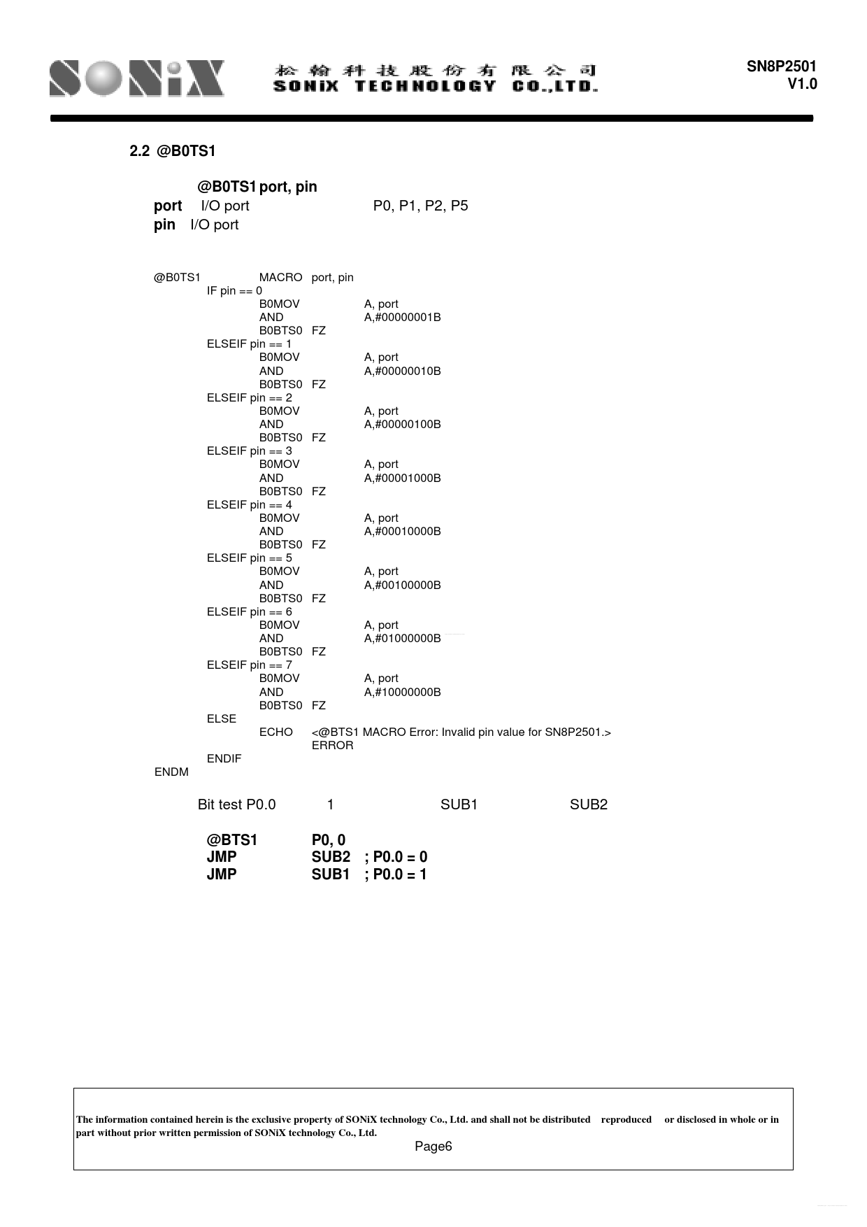

V1.0 2.2 @B0TS1
巨集程式: 語法:
@B0TS1 port, pin port
: I/O port 位置,設置數值為 P0, P1, P2, P5。
pin
:I/O port 腳位位置, 程式: @B0TS1 MACRO port, pin IF pin == 0 B0MOV A, port AND A,#00000001B B0BTS0 FZ ELSEIF pin == 1 B0MOV A, port AND A,#00000010B B0BTS0 FZ ELSEIF pin == 2 B0MOV A, port AND A,#00000100B B0BTS0 FZ ELSEIF pin == 3 B0MOV A, port AND A,#00001000B B0BTS0 FZ ELSEIF pin == 4 B0MOV A, port AND A,#00010000B B0BTS0 FZ ELSEIF pin == 5 B0MOV A, port AND A,#00100000B B0BTS0 FZ ELSEIF pin == 6 B0MOV A, port AND A,#01000000B http://www.DataSheet4U.net/ B0BTS0 FZ ELSEIF pin == 7 B0MOV A, port AND A,#10000000B B0BTS0 FZ ELSE ECHO <@BTS1 MACRO Error: Invalid pin value for SN8P2501.> ERROR ENDIF ENDM 範例:Bit test P0.0 是否為 1,成立程式跳至 SUB1,不成立跳至 SUB2。
@BTS1 P0, 0 JMP SUB2 ; P0.0 = 0 JMP SUB1 ; P0.0 = 1
