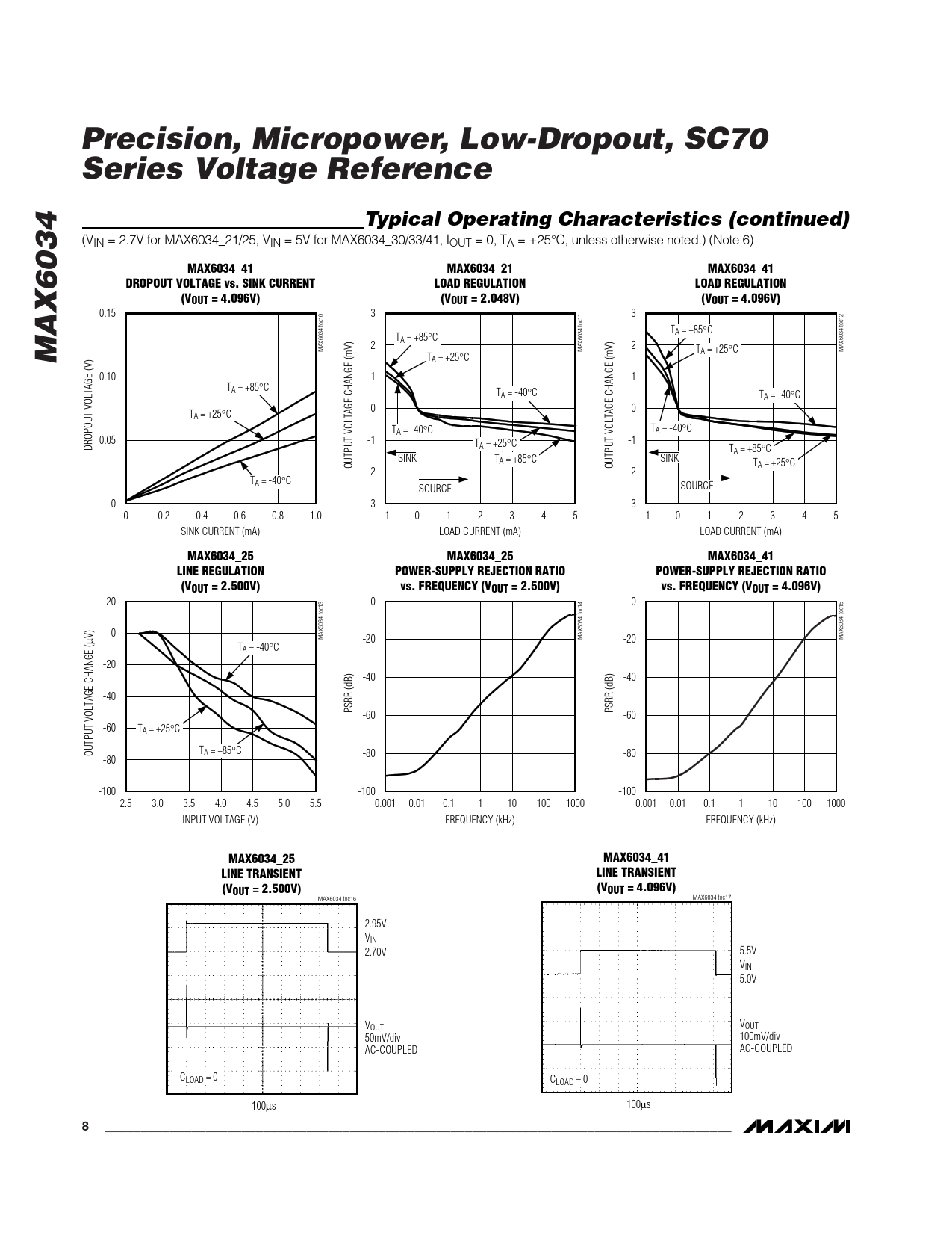

Precision, Micropower, Low-Dropout, SC70 Series Voltage Reference. Typical Operating Characteristics (continued)
Precision, Micropower, Low-Dropout, SC70 Series Voltage Reference Typical Operating Characteristics (continued)
(VIN = 2.7V for MAX6034_21/25, VIN = 5V for MAX6034_30/33/41, IOUT = 0, TA = +25°C, unless otherwise noted.) (Note 6)
MAX6034_41 MAX6034_21 MAX6034_41 DROPOUT VOLTAGE vs. SINK CURRENT LOAD REGULATION LOAD REGULATION (VOUT = 4.096V) (VOUT = 2.048V) (VOUT = 4.096V)
0.15 3 3 TA = +85°C TA = +85°C
MAX6034
2 2 MAX6034 toc10 MAX6034 toc11 T MAX6034 toc12 A = +25°C TA = +25°C 0.10 1 1 TA = +85°C TA = -40°C TA = -40°C 0 0 TA = +25°C T TA = -40 A = -40°C °C 0.05 -1 -1 TA = +25 DROPOUT VOLTAGE (V) °C TA = +85°C SINK T SINK OUTPUT VOLTAGE CHANGE (mV) A = +85°C OUTPUT VOLTAGE CHANGE (mV) TA = +25°C -2 -2 TA = -40°C SOURCE SOURCE 0 -3 -3 0 0.2 0.4 0.6 0.8 1.0 -1 0 1 2 3 4 5 -1 0 1 2 3 4 5 SINK CURRENT (mA) LOAD CURRENT (mA) LOAD CURRENT (mA)
MAX6034_25 MAX6034_25 MAX6034_41 LINE REGULATION POWER-SUPPLY REJECTION RATIO POWER-SUPPLY REJECTION RATIO (VOUT = 2.500V) vs. FREQUENCY (VOUT = 2.500V) vs. FREQUENCY (VOUT = 4.096V)
20 0 0 0 MAX6034 toc13 MAX6034 toc14 MAX6034 toc15 -20 -20 µV) TA = -40°C -20 -40 -40 -40 PSRR (dB) PSRR (dB) -60 -60 -60 TA = +25°C OUTPUT VOLTAGE CHANGE ( TA = +85°C -80 -80 -80 -100 -100 -100 2.5 3.0 3.5 4.0 4.5 5.0 5.5 0.001 0.01 0.1 1 10 100 1000 0.001 0.01 0.1 1 10 100 1000 INPUT VOLTAGE (V) FREQUENCY (kHz) FREQUENCY (kHz)
MAX6034_25 MAX6034_41 LINE TRANSIENT LINE TRANSIENT (V (V OUT = 2.500V) OUT = 4.096V)
MAX6034 toc17 MAX6034 toc16 2.95V VIN 2.70V 5.5V VIN 5.0V V V OUT OUT 50mV/div 100mV/div AC-COUPLED AC-COUPLED CLOAD = 0 CLOAD = 0 100 100 µs µs
