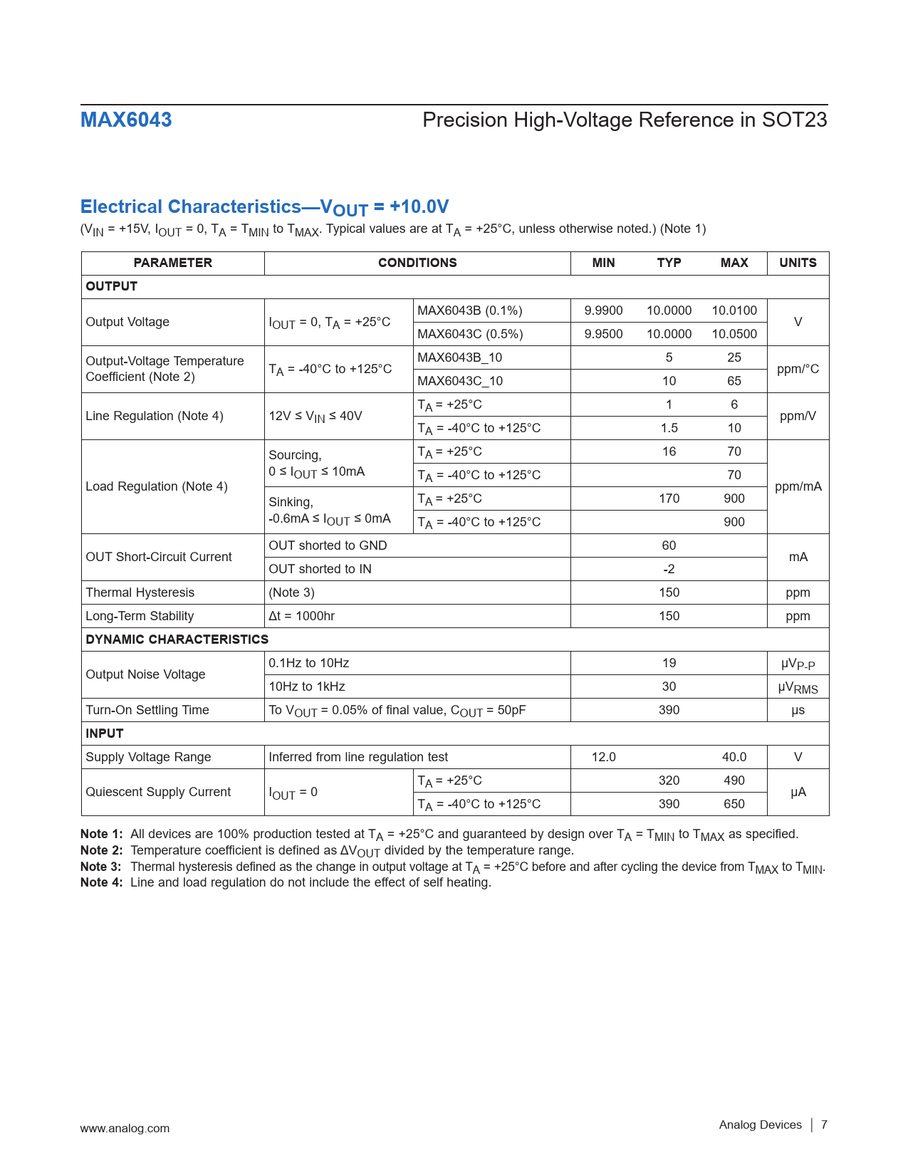

MAX6043. Electrical Characteristics—VOUT = +10.0V. PARAMETER. CONDITIONS. MIN. TYP. MAX. UNITS. OUTPUT. DYNAMIC CHARACTERISTICS. INPUT
MAX6043 Electrical Characteristics—VOUT = +10.0V PARAMETER CONDITIONS MIN TYP MAX UNITS OUTPUT DYNAMIC CHARACTERISTICS INPUT
MAX6043
Precision High-Voltage Reference in SOT23
(VIN = +15V, IOUT = 0, TA = TMIN to TMAX. Typical values are at TA = +25°C, unless otherwise noted.) (Note 1)
MAX6043B (0.1%) 9.9900 10.0000 10.0100 Output Voltage IOUT = 0, TA = +25°C V MAX6043C (0.5%) 9.9500 10.0000 10.0500 Output-Voltage Temperature MAX6043B_10 5 25 Coefficient (Note 2) TA = -40°C to +125°C ppm/°C MAX6043C_10 10 65 T Line Regulation (Note 4) 12V ≤ V A = +25°C 1 6 IN ≤ 40V ppm/V TA = -40°C to +125°C 1.5 10 Sourcing, TA = +25°C 16 70 0 ≤ IOUT ≤ 10mA T Load Regulation (Note 4) A = -40°C to +125°C 70 ppm/mA Sinking, TA = +25°C 170 900 -0.6mA ≤ IOUT ≤ 0mA TA = -40°C to +125°C 900 OUT shorted to GND 60 OUT Short-Circuit Current mA OUT shorted to IN -2 Thermal Hysteresis (Note 3) 150 ppm Long-Term Stability Δt = 1000hr 150 ppm
0.1Hz to 10Hz 19 µV Output Noise Voltage P-P 10Hz to 1kHz 30 µVRMS Turn-On Settling Time To VOUT = 0.05% of final value, COUT = 50pF 390 µs
INPUT
Supply Voltage Range Inferred from line regulation test 12.0 40.0 V T Quiescent Supply Current I A = +25°C 320 490 OUT = 0 µA TA = -40°C to +125°C 390 650
Note 1:
All devices are 100% production tested at TA = +25°C and guaranteed by design over TA = TMIN to TMAX as specified.
Note 2:
Temperature coefficient is defined as ΔVOUT divided by the temperature range.
Note 3:
Thermal hysteresis defined as the change in output voltage at TA = +25°C before and after cycling the device from TMAX to TMIN.
Note 4:
Line and load regulation do not include the effect of self heating. www.analog.com Analog Devices │ 7
