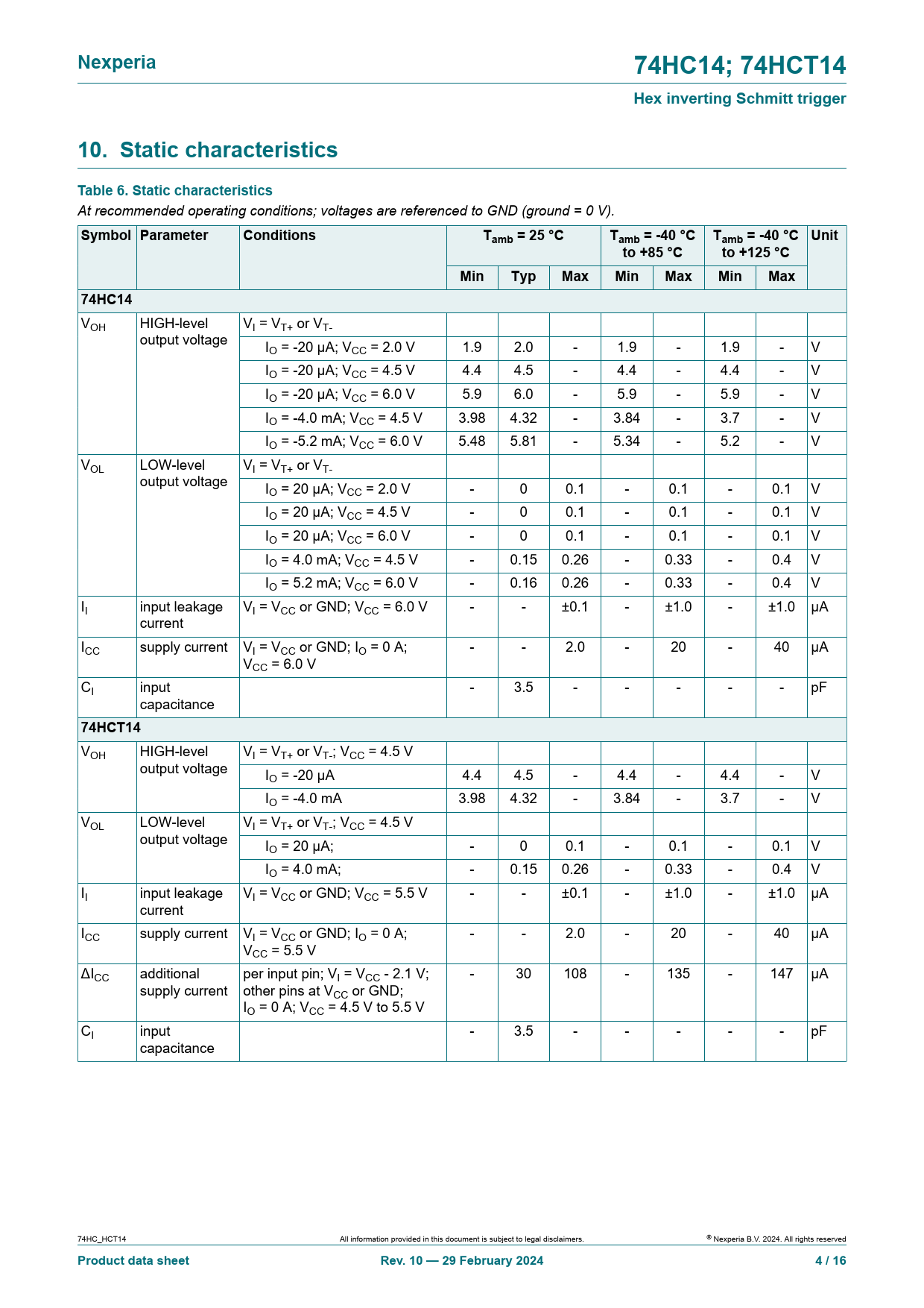

Nexperia. 74HC14; 74HCT14 Hex inverting Schmitt trigger. 10. Static characteristics Table 6. Static characteristics
Nexperia 74HC14; 74HCT14 Hex inverting Schmitt trigger 10 Static characteristics Table 6 Static characteristics
Nexperia 74HC14; 74HCT14 Hex inverting Schmitt trigger 10. Static characteristics Table 6. Static characteristics
At recommended operating conditions; voltages are referenced to GND (ground = 0 V).
Symbol Parameter Conditions Tamb = 25 °C Tamb = -40 °C Tamb = -40 °C Unit to +85 °C to +125 °C Min Typ Max Min Max Min Max 74HC14
VOH HIGH-level VI = VT+ or VT- output voltage IO = -20 μA; VCC = 2.0 V 1.9 2.0 - 1.9 - 1.9 - V IO = -20 μA; VCC = 4.5 V 4.4 4.5 - 4.4 - 4.4 - V IO = -20 μA; VCC = 6.0 V 5.9 6.0 - 5.9 - 5.9 - V IO = -4.0 mA; VCC = 4.5 V 3.98 4.32 - 3.84 - 3.7 - V IO = -5.2 mA; VCC = 6.0 V 5.48 5.81 - 5.34 - 5.2 - V VOL LOW-level VI = VT+ or VT- output voltage IO = 20 μA; VCC = 2.0 V - 0 0.1 - 0.1 - 0.1 V IO = 20 μA; VCC = 4.5 V - 0 0.1 - 0.1 - 0.1 V IO = 20 μA; VCC = 6.0 V - 0 0.1 - 0.1 - 0.1 V IO = 4.0 mA; VCC = 4.5 V - 0.15 0.26 - 0.33 - 0.4 V IO = 5.2 mA; VCC = 6.0 V - 0.16 0.26 - 0.33 - 0.4 V II input leakage VI = VCC or GND; VCC = 6.0 V - - ±0.1 - ±1.0 - ±1.0 μA current ICC supply current VI = VCC or GND; IO = 0 A; - - 2.0 - 20 - 40 μA VCC = 6.0 V CI input - 3.5 - - - - - pF capacitance
74HCT14
VOH HIGH-level VI = VT+ or VT-; VCC = 4.5 V output voltage IO = -20 μA 4.4 4.5 - 4.4 - 4.4 - V IO = -4.0 mA 3.98 4.32 - 3.84 - 3.7 - V VOL LOW-level VI = VT+ or VT-; VCC = 4.5 V output voltage IO = 20 μA; - 0 0.1 - 0.1 - 0.1 V IO = 4.0 mA; - 0.15 0.26 - 0.33 - 0.4 V II input leakage VI = VCC or GND; VCC = 5.5 V - - ±0.1 - ±1.0 - ±1.0 μA current ICC supply current VI = VCC or GND; IO = 0 A; - - 2.0 - 20 - 40 μA VCC = 5.5 V ΔICC additional per input pin; VI = VCC - 2.1 V; - 30 108 - 135 - 147 μA supply current other pins at VCC or GND; IO = 0 A; VCC = 4.5 V to 5.5 V CI input - 3.5 - - - - - pF capacitance 74HC_HCT14 All information provided in this document is subject to legal disclaimers. © Nexperia B.V. 2024. Al rights reserved
