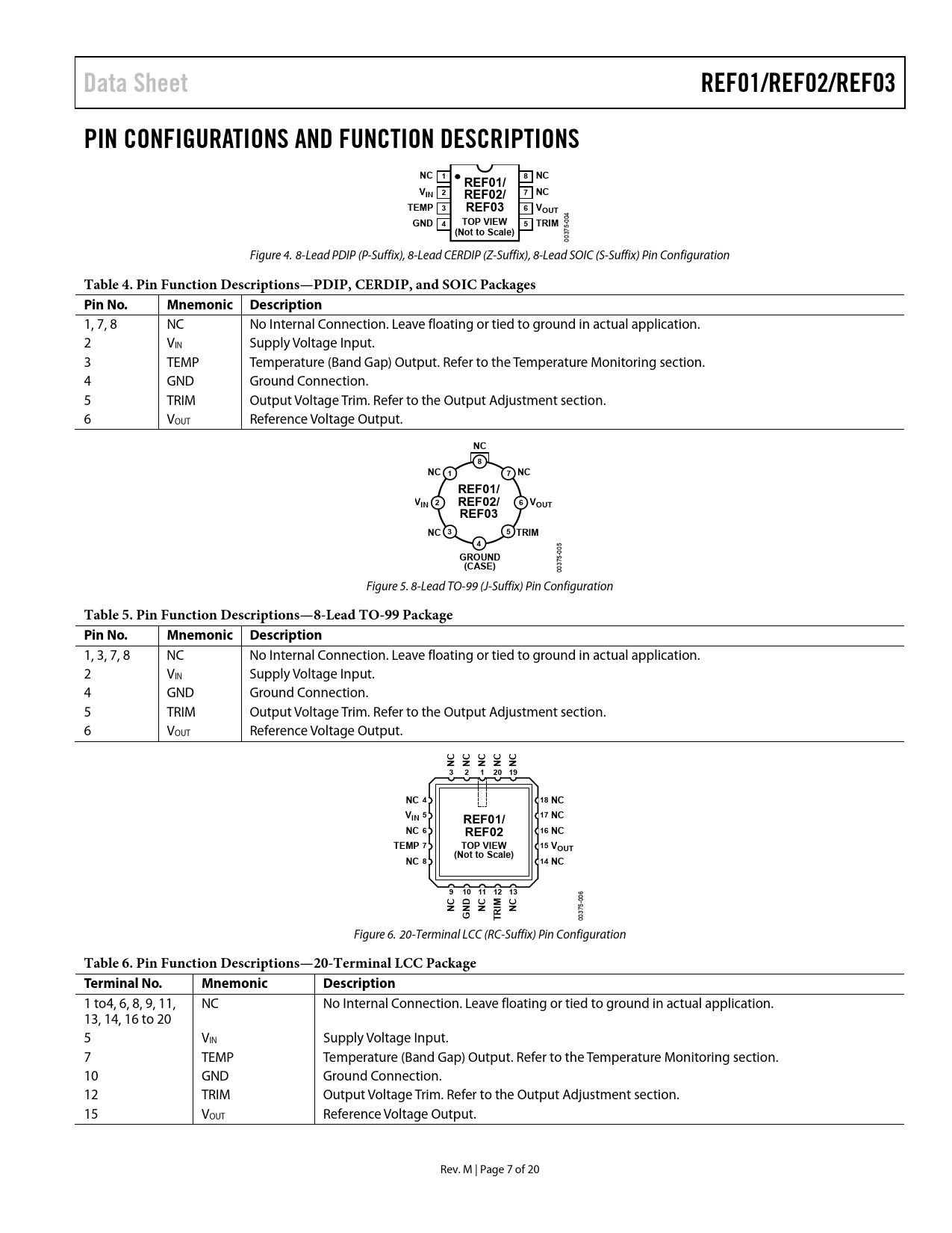

Data Sheet. REF01/REF02/REF03. PIN CONFIGURATIONS AND FUNCTION DESCRIPTIONS. NC 1. REF01/. 8 NC. VIN 2. REF02/. 7 NC. TEMP 3. REF03. 6 VOUT
Data Sheet REF01/REF02/REF03 PIN CONFIGURATIONS AND FUNCTION DESCRIPTIONS NC 1 REF01/ 8 NC VIN 2 REF02/ 7 NC TEMP 3 REF03 6 VOUT
link to page 15 link to page 14 link to page 14 link to page 15 link to page 14
004
GND 4 TOP VIEW 5 TRIM (Not to Scale)
00375- Figure 4. 8-Lead PDIP (P-Suffix), 8-Lead CERDIP (Z-Suffix), 8-Lead SOIC (S-Suffix) Pin Configuration
Table 4. Pin Function Descriptions—PDIP, CERDIP, and SOIC Packages Pin No. Mnemonic Description
1, 7, 8 NC No Internal Connection. Leave floating or tied to ground in actual application. 2 VIN Supply Voltage Input. 3 TEMP Temperature (Band Gap) Output. Refer to the Temperature Monitoring section. 4 GND Ground Connection. 5 TRIM Output Voltage Trim. Refer to the Output Adjustment section. 6 VOUT Reference Voltage Output.
NC 8 NC 1 7 NC REF01/ V 2 IN REF02/ 6 VOUT REF03 NC 3 5 TRIM 4
005
GROUND (CASE)
00375- Figure 5. 8-Lead TO-99 (J-Suffix) Pin Configuration
Table 5. Pin Function Descriptions—8-Lead TO-99 Package Pin No. Mnemonic Description
1, 3, 7, 8 NC No Internal Connection. Leave floating or tied to ground in actual application. 2 VIN Supply Voltage Input. 4 GND Ground Connection. 5 TRIM Output Voltage Trim. Refer to the Output Adjustment section. 6 VOUT Reference Voltage Output.
NC NC NC NC NC 3 2 1 20 19 NC 4 18 NC V 5 IN 17 NC REF01/ NC 6 16 NC REF02 TEMP 7 TOP VIEW 15 VOUT NC (Not to Scale) 8 14 NC 9 10 11 12 13
006
IM NC ND NC NC G TR
00375- Figure 6. 20-Terminal LCC (RC-Suffix) Pin Configuration
Table 6. Pin Function Descriptions—20-Terminal LCC Package Terminal No. Mnemonic Description
1 to4, 6, 8, 9, 11, NC No Internal Connection. Leave floating or tied to ground in actual application. 13, 14, 16 to 20 5 VIN Supply Voltage Input. 7 TEMP Temperature (Band Gap) Output. Refer to the Temperature Monitoring section. 10 GND Ground Connection. 12 TRIM Output Voltage Trim. Refer to the Output Adjustment section. 15 VOUT Reference Voltage Output. Rev. M | Page 7 of 20 Document Outline FEATURES APPLICATIONS GENERAL DESCRIPTION PIN CONFIGURATIONS TABLE OF CONTENTS REVISION HISTORY SPECIFICATIONS REF01 SPECIFICATIONS REF02 SPECIFICATIONS REF03 SPECIFICATIONS ABSOLUTE MAXIMUM RATINGS THERMAL RESISTANCE ESD CAUTION PIN CONFIGURATIONS AND FUNCTION DESCRIPTIONS TYPICAL PERFORMANCE CHARACTERISTICS TERMINOLOGY THEORY OF OPERATION INPUT AND OUTPUT CAPACITORS OUTPUT ADJUSTMENT TEMPERATURE MONITORING LONG-TERM STABILITY BURN-IN POWER DISSIPATION APPLICATIONS INFORMATION BASIC REFERENCE APPLICATION LOW COST CURRENT SOURCE PRECISION CURRENT SOURCE WITH ADJUSTABLE OUTPUT PRECISION BOOSTED OUTPUT REGULATOR BIPOLAR VOLTAGE REFERENCE ADJUSTABLE REFERENCE WITH POSITIVE AND NEGATIVE SWING OUTLINE DIMENSIONS REF01 ORDERING GUIDE REF02 ORDERING GUIDE REF03 ORDERING GUIDE
