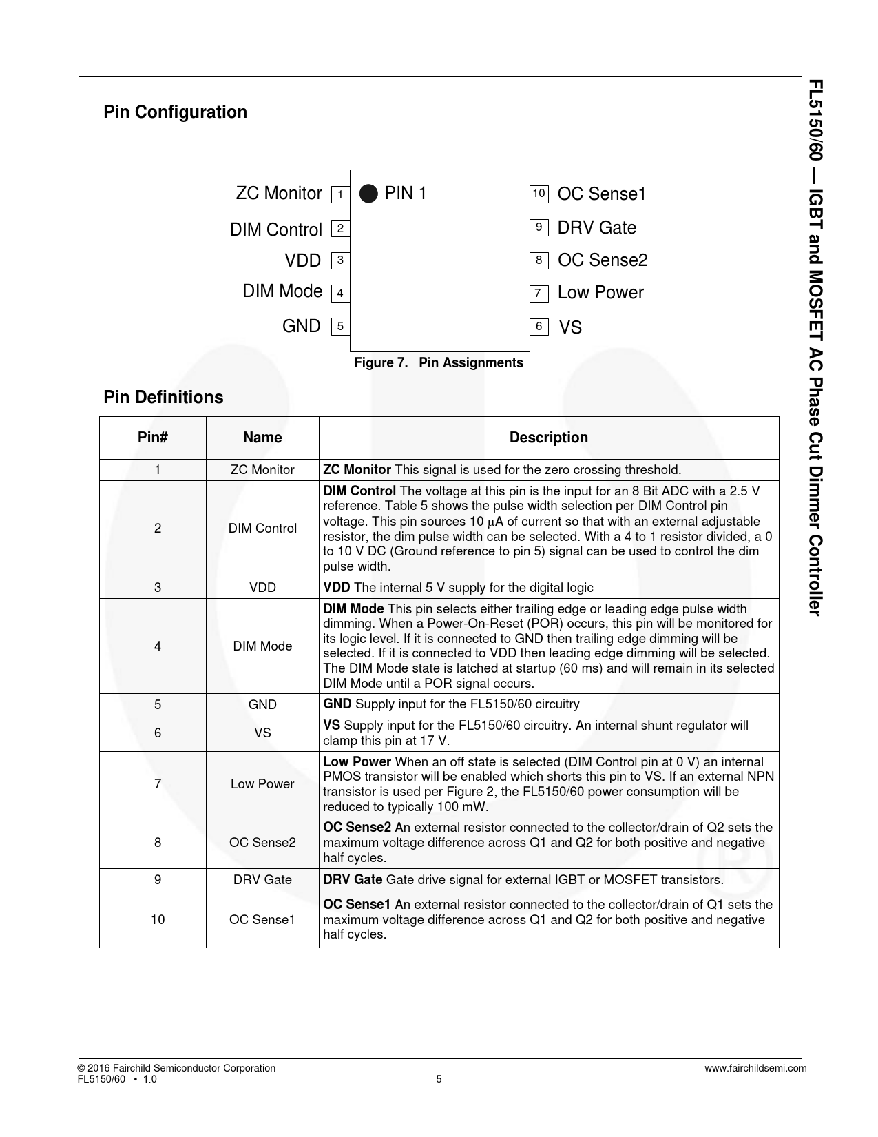

ZC Monitor 1 DIM Control PIN 1 10 OC Sense1 2 9 DRV Gate VDD 3 8 OC Sense2 DIM Mode 4 7 Low Power GND 5 6 VS Figure 7. Pin Assignments Pin Definitions
Pin# Name Description ZC Monitor ZC Monitor This signal is used for the zero crossing threshold. 2 DIM Control DIM Control The voltage at this pin is the input for an 8 Bit ADC with a 2.5 V
reference. Table 5 shows the pulse width selection per DIM Control pin
voltage. This pin sources 10 A of current so that with an external adjustable
resistor, the dim pulse width can be selected. With a 4 to 1 resistor divided, a 0
to 10 V DC (Ground reference to pin 5) signal can be used to control the dim
pulse width. 3 VDD 1 4 DIM Mode 5 GND 6 VS VDD The internal 5 V supply for the digital logic
DIM Mode This pin selects either trailing edge or leading edge pulse width
dimming. When a Power-On-Reset (POR) occurs, this pin will be monitored for
its logic level. If it is connected to GND then trailing edge dimming will be
selected. If it is connected to VDD then leading edge dimming will be selected.
The DIM Mode state is latched at startup (60 ms) and will remain in its selected
DIM Mode until a POR signal occurs.
GND Supply input for the FL5150/60 circuitry
VS Supply input for the FL5150/60 circuitry. An internal shunt regulator will
clamp this pin at 17 V. 7 Low Power Low Power When an off state is selected (DIM Control pin at 0 V) an internal
PMOS transistor will be enabled which shorts this pin to VS. If an external NPN
transistor is used per Figure 2, the FL5150/60 power consumption will be
reduced to typically 100 mW. 8 OC Sense2 OC Sense2 An external resistor connected to the collector/drain of Q2 sets the
maximum voltage difference across Q1 and Q2 for both positive and negative
half cycles. 9 DRV Gate DRV Gate Gate drive signal for external IGBT or MOSFET transistors. 10 OC Sense1 OC Sense1 An external resistor connected to the collector/drain of Q1 sets the
half cycles. © 2016 Fairchild Semiconductor Corporation
