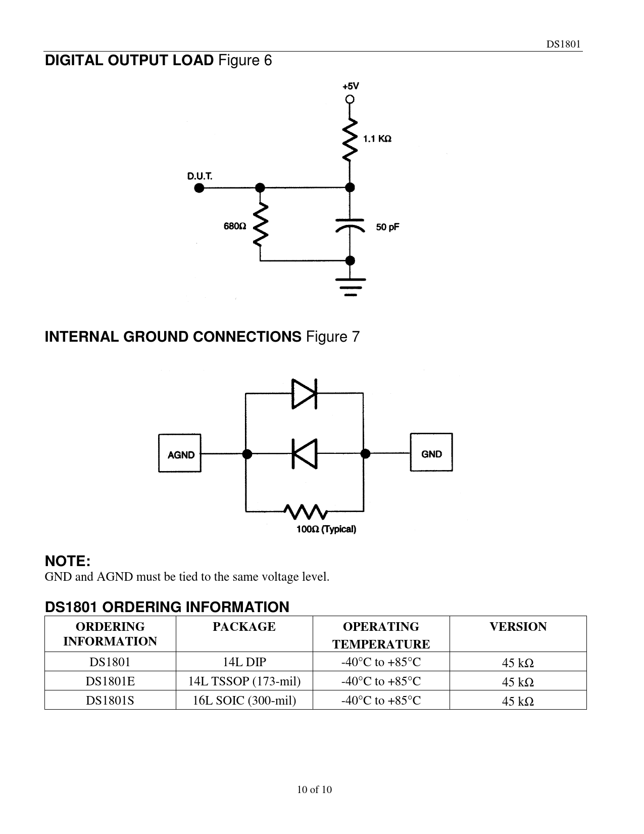

DIGITAL OUTPUT LOAD
Figure 6
INTERNAL GROUND CONNECTIONS
Figure 7
NOTE:
GND and AGND must be tied to the same voltage level.
DS1801 ORDERING INFORMATION ORDERING PACKAGE OPERATING VERSION INFORMATION TEMPERATURE
DS1801 14L DIP -40°C to +85°C 45 kΩ DS1801E 14L TSSOP (173-mil) -40°C to +85°C 45 kΩ DS1801S 16L SOIC (300-mil) -40°C to +85°C 45 kΩ 10 of 10
