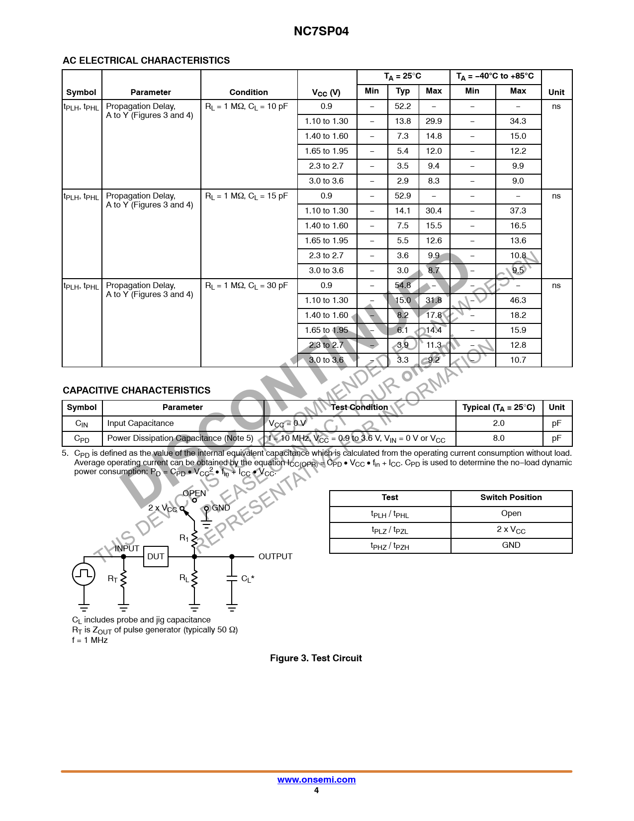

NC7SP04. AC ELECTRICAL CHARACTERISTICS. TA = 25. TA = −40. C to +85. Symbol. Parameter. Condition. VCC (V). Min. Typ. Max. Unit

Symbol Parameter Condition VCC (V) Min Typ Max Min Max

ÎÎÎÎ ÎÎÎÎÎÎÎ ÎÎÎÎÎÎÎ ÎÎÎÎÎ ÎÎÎÎÎÎÎ ÎÎÎÎÎÎ ÎÎÎ tPLH, tPHL Propagation Delay, RL = 1 MW, CL = 10 pF 0.9 − 52.2 − − − ns ÎÎÎÎ ÎÎÎÎÎÎÎ ÎÎÎÎÎÎÎ ÎÎÎÎÎ ÎÎÎ ÎÎÎ ÎÎÎ ÎÎÎÎ ÎÎÎ ÎÎÎ A to Y (Figures 3 and 4) 1.10 to 1.30 − 13.8 29.9 − 34.3 1.40 to 1.60 − 7.3 14.8 − 15.0 1.65 to 1.95 − 5.4 12.0 − 12.2 2.3 to 2.7 − 3.5 9.4 − 9.9 3.0 to 3.6 − 2.9 8.3 − 9.0 tPLH, tPHL Propagation Delay, RL = 1 MW, CL = 15 pF 0.9 − 52.9 − − − ns A to Y (Figures 3 and 4) 1.10 to 1.30 − 14.1 30.4 − 37.3 1.40 to 1.60 − 7.5 15.5 − 16.5 1.65 to 1.95 − 5.5 12.6 − 13.6 2.3 to 2.7 − 3.6 9.9 − 10.8 3.0 to 3.6 − 3.0 8.7 − 9.5 tPLH, tPHL Propagation Delay, RL = 1 MW, CL = 30 pF 0.9 − 54.8 − − − ns A to Y (Figures 3 and 4) 1.10 to 1.30 − 15.0 31.8 − 46.3 1.40 to 1.60 − 8.2 17.8 − 18.2 1.65 to 1.95 − 6.1 14.4 − 15.9 2.3 to 2.7 − 3.9 11.3 − 12.8 3.0 to 3.6 − 3.3 9.2 − 10.7

CIN Input Capacitance VCC = 0 V 2.0 pF CPD Power Dissipation Capacitance (Note 5) f = 10 MHz, VCC = 0.9 to 3.6 V, VIN = 0 V or VCC 8.0 pF 5. CPD is defined as the value of the internal equivalent capacitance which is calculated from the operating current consumption without load. Average operating current can be obtained by the equation ICC(OPR) = CPD VCC fin + ICC. CPD is used to determine the no−load dynamic power consumption: P 2 D = CPD VCC fin + ICC VCC. OPEN
Test Switch Position
2 x VCC GND tPLH / tPHL Open tPLZ / tPZL 2 x VCC R1 INPUT tPHZ / tPZH GND DUT OUTPUT RT RL CL* CL includes probe and jig capacitance RT is ZOUT of pulse generator (typically 50 W) f = 1 MHz
