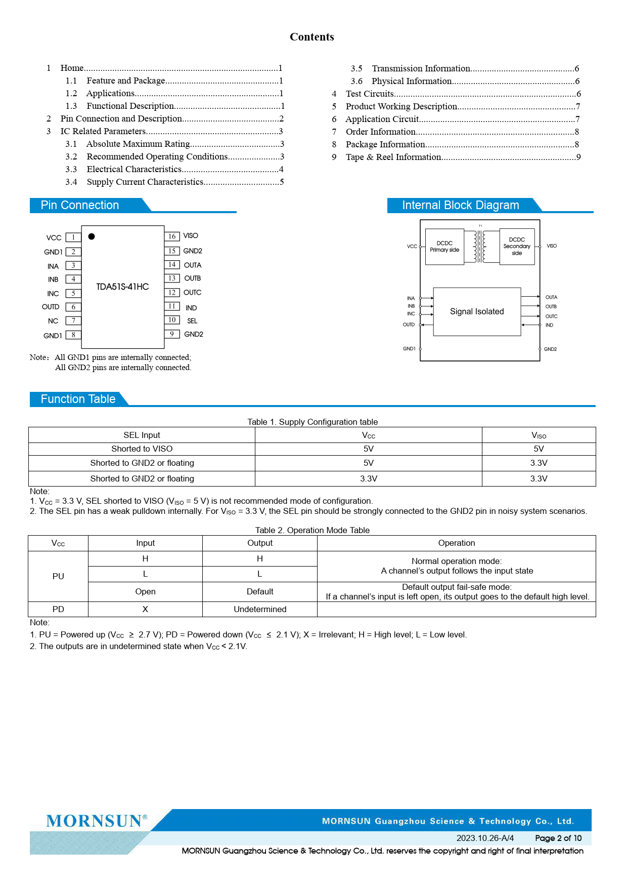

1 Home. 1 3.5 Transmission Information. 6 1.1 Feature and Package. 1 3.6 Physical Information. 6 1.2 Applications. .1 4 Test Circuits. .6 1.3 Functional Description. .1 5 Product Working Description. 7 2 Pin Connection and Description. .2 6 Application Circuit. 7 3 IC Related Parameters.. .3 7 Order Information. .8 3.1 Absolute Maximum Rating. 3 8 Package Information. .8 3.2 Recommended Operating Conditions. 3 9 Tape & Reel Information. .9 3.3 Electrical Characteristics. .4 3.4 Supply Current Characteristics. 5 Pin Connection Internal Block Diagram Note:All GND1 pins are internally connected; All GND2 pins are internally connected. Function Table Table 1. Supply Configuration table SEL Input VCC VISO Shorted to VISO 5V 5V Shorted to GND2 or floating 5V 3.3V Shorted to GND2 or floating 3.3V 3.3V Note: 1. VCC = 3.3 V, SEL shorted to VISO (VISO = 5 V) is not recommended mode of configuration. 2. The SEL pin has a weak pul down internal y. For VISO = 3.3 V, the SEL pin should be strongly connected to the GND2 pin in noisy system scenarios. Table 2. Operation Mode Table VCC Input Output Operation H H Normal operation mode: PU A channel’s output fol ows the input state L L Open Default Default output fail-safe mode: If a channel’s input is left open, its output goes to the default high level. PD X Undetermined Note: 1. PU = Powered up (VCC ≥ 2.7 V); PD = Powered down (VCC ≤ 2.1 V); X = Irrelevant; H = High level; L = Low level. 2. The outputs are in undetermined state when VCC < 2.1V. 2023.10.26-A/4
