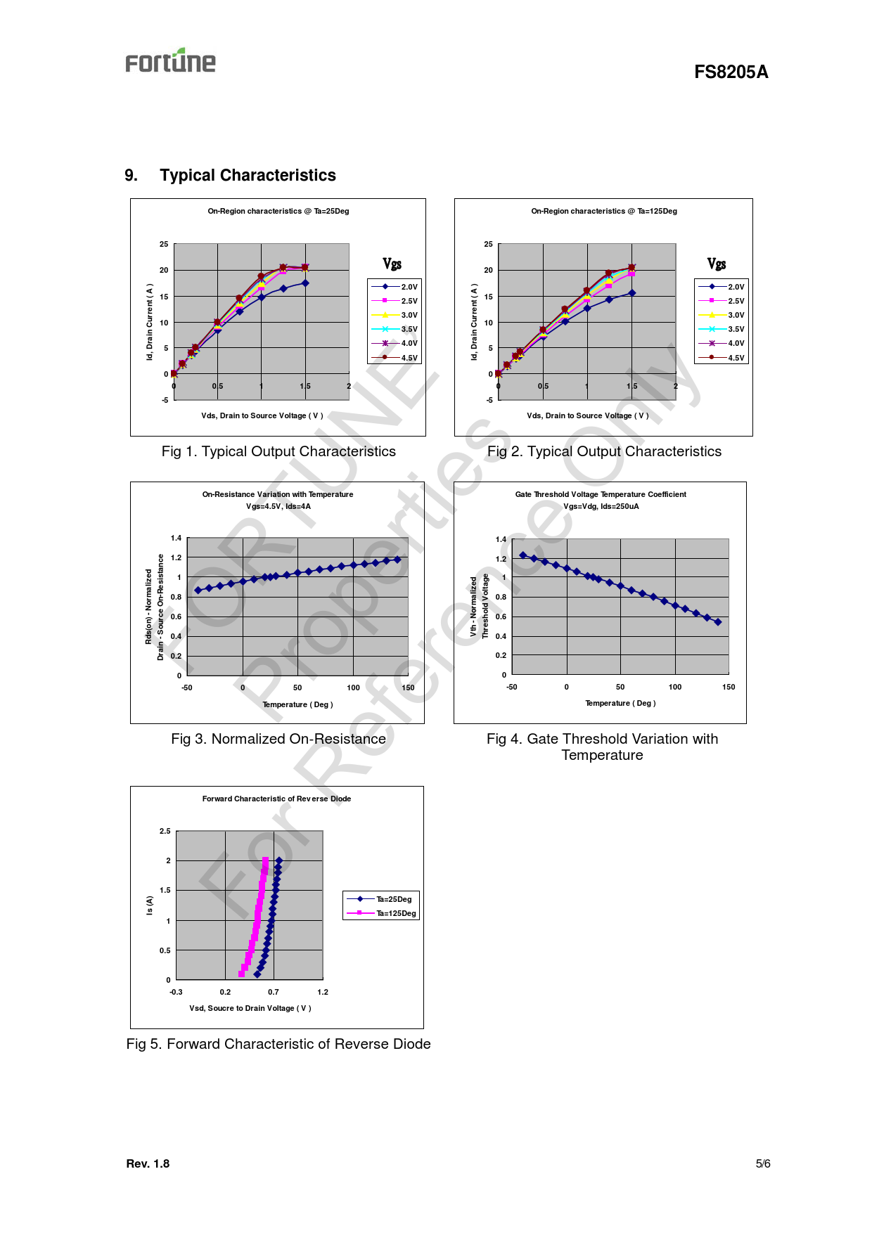

Datasheet FS8205A (Fortune Semiconductor) - 5
ManufacturerFortune Semiconductor
DescriptionDual N-Channel Power MOSFET
Pages / Page6 / 5 — FS8205A 9. Typical Characteristics
File Format / SizePDF / 775 Kb
FS8205A 9 Typical Characteristics
On-Region characteristics @ Ta=25Deg On-Region characteristics @ Ta=125Deg 25 25 15 2.5V
3.0V 10 3.5V
4.0V 5 4.5V Id, Drain Current ( A ) 20
2.0V 2.0V
15 2.5V
3.0V 10 3.5V
4.0V 5 FO
Fo P R
r R ro TU
ef pe NE
er rti
e
en s
ce
O
nl
y Id, Drain Current ( A ) 20 0 0 0.5 1 1.5 2 0 -5 0.5 1 1.5 2 -5 Vds, Drain to Source Voltage ( V ) Vds, Drain to Source Voltage ( V ) Fig 2. Typical Output Characteristics On-Resistance Variation with Temperature Gate Threshold Voltage Temperature Coefficient Vgs=4.5V, Ids=4A Vgs=Vdg, Ids=250uA 1.4 1.4 1.2 1.2 Vth -Normalized 1 0.8
0.6
0.4 Threshold Voltage Drain -Source On-Resistance Fig 1. Typical Output Characteristics Rds(on) -Normalized 4.5V 0 1 0.8
0.6
0.4
0.2 0.2 0 0 -50 0 50 100 150 -50 0 50 100 150 Temperature ( Deg ) Temperature ( Deg ) Fig 3. Normalized On-Resistance Fig 4. Gate Threshold Variation with
Temperature Forward Characteristic of Rev erse Diode 2.5 2 Is (A) 1.5 Ta=25Deg Ta=125Deg 1 0.5 0
-0.3 0.2 0.7 1.2 Vsd, Soucre to Drain Voltage ( V ) Fig 5. Forward Characteristic of Reverse Diode Rev. 1.8 5/6
