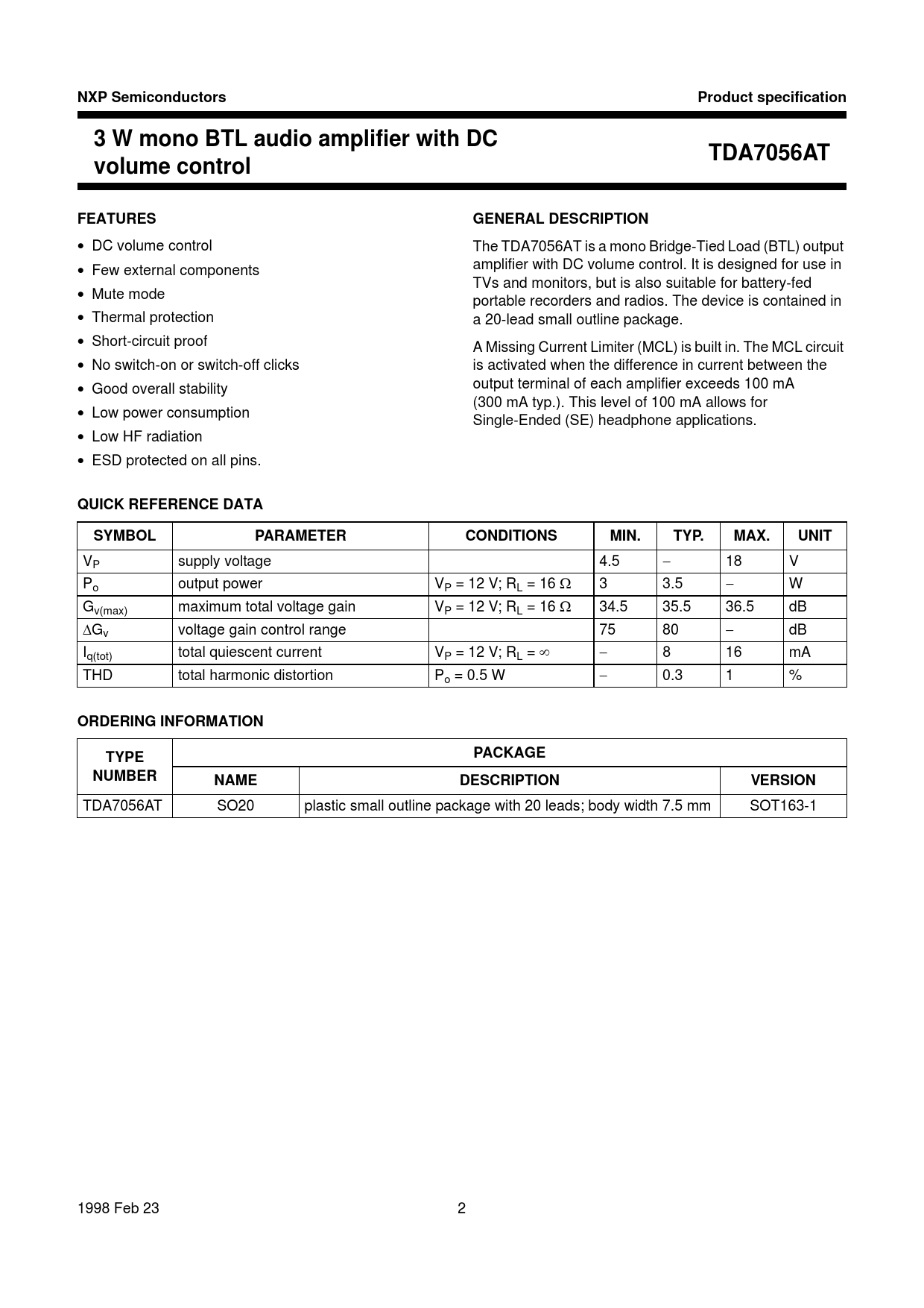

NXP Semiconductors. Product specification. 3 W mono BTL audio amplifier with DC. TDA7056AT. volume control. FEATURES
NXP Semiconductors Product specification 3 W mono BTL audio amplifier with DC TDA7056AT volume control FEATURES
NXP Semiconductors Product specification 3 W mono BTL audio amplifier with DC TDA7056AT volume control FEATURES GENERAL DESCRIPTION
• DC volume control The TDA7056AT is a mono Bridge-Tied Load (BTL) output • Few external components amplifier with DC volume control. It is designed for use in TVs and monitors, but is also suitable for battery-fed • Mute mode portable recorders and radios. The device is contained in • Thermal protection a 20-lead small outline package. • Short-circuit proof A Missing Current Limiter (MCL) is built in. The MCL circuit • No switch-on or switch-off clicks is activated when the difference in current between the • Good overall stability output terminal of each amplifier exceeds 100 mA (300 mA typ.). This level of 100 mA allows for • Low power consumption Single-Ended (SE) headphone applications. • Low HF radiation • ESD protected on all pins.
QUICK REFERENCE DATA SYMBOL PARAMETER CONDITIONS MIN. TYP. MAX. UNIT
VP supply voltage 4.5 − 18 V Po output power VP = 12 V; RL = 16 Ω 3 3.5 − W Gv(max) maximum total voltage gain VP = 12 V; RL = 16 Ω 34.5 35.5 36.5 dB ΔGv voltage gain control range 75 80 − dB Iq(tot) total quiescent current VP = 12 V; RL = ∞ − 8 16 mA THD total harmonic distortion Po = 0.5 W − 0.3 1 %
ORDERING INFORMATION TYPE PACKAGE NUMBER NAME DESCRIPTION VERSION
TDA7056AT SO20 plastic small outline package with 20 leads; body width 7.5 mm SOT163-1 1998 Feb 23 2 Document Outline Features General description Quick reference data Ordering information Block diagram Pinning Functional description Power dissipation Limiting values Thermal characteristics Characteristics Test and application information Test conditions Voltage gain Output power Switch-on/switch-off Thermal behaviour: Short-circuit protection: Package outline Soldering Introduction Reflow soldering Wave soldering Repairing soldered joints Data sheet status Disclaimers
