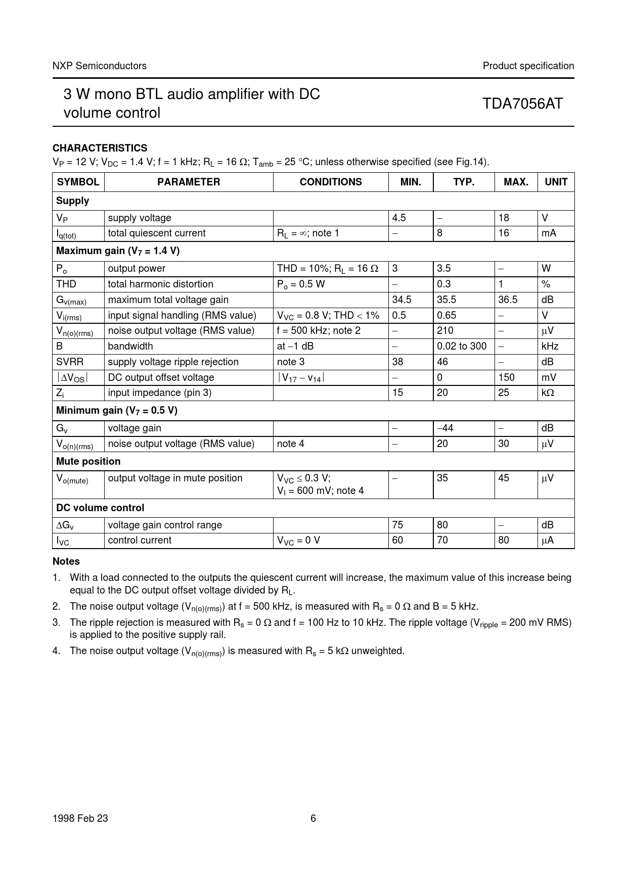

CHARACTERISTICS. SYMBOL. PARAMETER. CONDITIONS. MIN. TYP. MAX. UNIT. Supply. Maximum gain (V7 = 1.4 V). Minimum gain (V7 = 0.5 V)
CHARACTERISTICS SYMBOL PARAMETER CONDITIONS MIN TYP MAX UNIT Supply Maximum gain (V7 = 1.4 V) Minimum gain (V7 = 0.5 V)
link to page 12 link to page 6 link to page 6 link to page 6 link to page 6 link to page 6 NXP Semiconductors Product specification 3 W mono BTL audio amplifier with DC TDA7056AT volume control
CHARACTERISTICS
VP = 12 V; VDC = 1.4 V; f = 1 kHz; RL = 16 Ω; Tamb = 25 °C; unless otherwise specified (see Fig.14).
SYMBOL PARAMETER CONDITIONS MIN. TYP. MAX. UNIT Supply
VP supply voltage 4.5 − 18 V Iq(tot) total quiescent current RL = ∞; note 1 − 8 16 mA
Po output power THD = 10%; RL = 16 Ω 3 3.5 − W THD total harmonic distortion Po = 0.5 W − 0.3 1 % Gv(max) maximum total voltage gain 34.5 35.5 36.5 dB Vi(rms) input signal handling (RMS value) VVC = 0.8 V; THD < 1% 0.5 0.65 − V Vn(o)(rms) noise output voltage (RMS value) f = 500 kHz; note 2 − 210 − μV B bandwidth at −1 dB − 0.02 to 300 − kHz SVRR supply voltage ripple rejection note 3 38 46 − dB ⎪ΔV ⎪ − ⎪ − OS DC output offset voltage ⎪V17 v14 0 150 mV Zi input impedance (pin 3) 15 20 25 kΩ
Gv voltage gain − −44 − dB Vo(n)(rms) noise output voltage (RMS value) note 4 − 20 30 μV
Mute position
V ≤ − o(mute) output voltage in mute position VVC 0.3 V; 35 45 μV VI = 600 mV; note 4
DC volume control
ΔGv voltage gain control range 75 80 − dB IVC control current VVC = 0 V 60 70 80 μA
Notes
1. With a load connected to the outputs the quiescent current will increase, the maximum value of this increase being equal to the DC output offset voltage divided by RL. 2. The noise output voltage (Vn(o)(rms)) at f = 500 kHz, is measured with Rs = 0 Ω and B = 5 kHz. 3. The ripple rejection is measured with Rs = 0 Ω and f = 100 Hz to 10 kHz. The ripple voltage (Vripple = 200 mV RMS) is applied to the positive supply rail. 4. The noise output voltage (Vn(o)(rms)) is measured with Rs = 5 kΩ unweighted. 1998 Feb 23 6 Document Outline Features General description Quick reference data Ordering information Block diagram Pinning Functional description Power dissipation Limiting values Thermal characteristics Characteristics Test and application information Test conditions Voltage gain Output power Switch-on/switch-off Thermal behaviour: Short-circuit protection: Package outline Soldering Introduction Reflow soldering Wave soldering Repairing soldered joints Data sheet status Disclaimers
