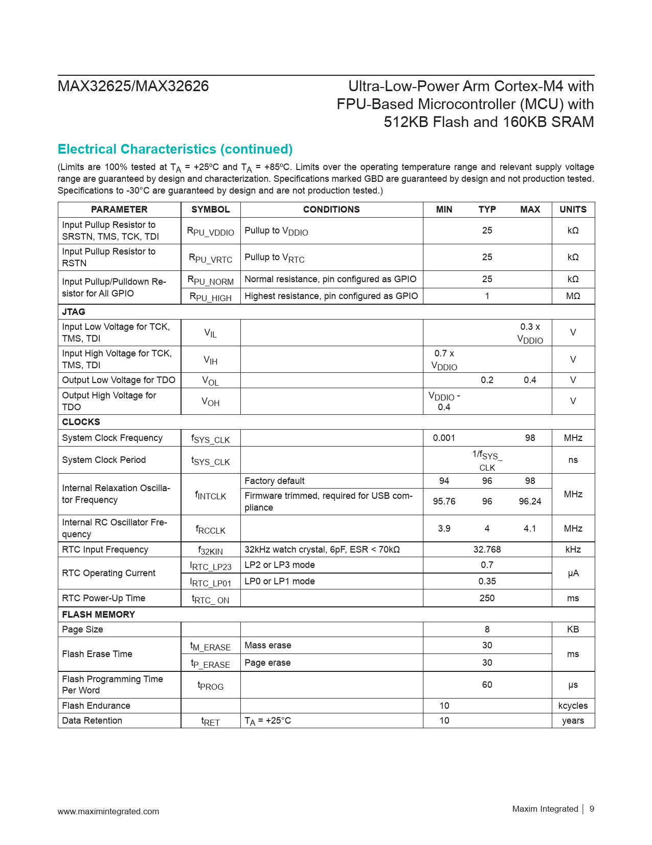

Electrical Characteristics (continued). PARAMETER. SYMBOL. CONDITIONS. MIN. TYP. MAX. UNITS. JTAG. CLOCKS. FLASH MEMORY
Electrical Characteristics (continued) PARAMETER SYMBOL CONDITIONS MIN TYP MAX UNITS JTAG CLOCKS FLASH MEMORY
MAX32625/MAX32626 Ultra-Low-Power Arm Cortex-M4 with FPU-Based Microcontroller (MCU) with 512KB Flash and 160KB SRAM
(Limits are 100% tested at TA = +25ºC and TA = +85ºC. Limits over the operating temperature range and relevant supply voltage range are guaranteed by design and characterization. Specifications marked GBD are guaranteed by design and not production tested. Specifications to -30°C are guaranteed by design and are not production tested.)
Input Pullup Resistor to SRSTN, TMS, TCK, TDI RPU_VDDIO Pullup to VDDIO 25 kΩ Input Pullup Resistor to RSTN RPU_VRTC Pullup to VRTC 25 kΩ Input Pullup/Pulldown Re- RPU_NORM Normal resistance, pin configured as GPIO 25 kΩ sistor for All GPIO RPU_HIGH Highest resistance, pin configured as GPIO 1 MΩ
JTAG
Input Low Voltage for TCK, 0.3 x TMS, TDI VIL V V DDIO Input High Voltage for TCK, 0.7 x TMS, TDI VIH V V DDIO Output Low Voltage for TDO VOL 0.2 0.4 V Output High Voltage for VDDIO - TDO VOH 0.4 V
CLOCKS
System Clock Frequency fSYS_CLK 0.001 98 MHz System Clock Period t 1/fSYS_ SYS_CLK ns CLK Factory default 94 96 98 Internal Relaxation Oscilla- tor Frequency fINTCLK Firmware trimmed, required for USB com- MHz pliance 95.76 96 96.24 Internal RC Oscillator Fre- quency fRCCLK 3.9 4 4.1 MHz RTC Input Frequency f32KIN 32kHz watch crystal, 6pF, ESR < 70kΩ 32.768 kHz I RTC Operating Current RTC_LP23 LP2 or LP3 mode 0.7 μA IRTC_LP01 LP0 or LP1 mode 0.35 RTC Power-Up Time tRTC_ ON 250 ms
FLASH MEMORY
