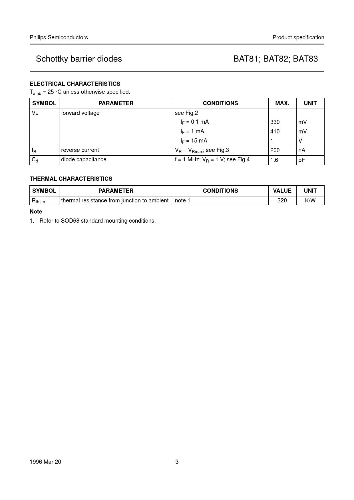

Philips Semiconductors Product specification Schottky barrier diodes BAT81; BAT82; BAT83
ELECTRICAL CHARACTERISTICS
Tamb = 25 °C unless otherwise specified.
SYMBOL PARAMETER CONDITIONS MAX. UNIT
VF forward voltage see Fig.2 IF = 0.1 mA 330 mV IF = 1 mA 410 mV IF = 15 mA 1 V IR reverse current VR = VRmax; see Fig.3 200 nA Cd diode capacitance f = 1 MHz; VR = 1 V; see Fig.4 1.6 pF
THERMAL CHARACTERISTICS SYMBOL PARAMETER CONDITIONS VALUE UNIT
Rth j-a thermal resistance from junction to ambient note 1 320 K/W
Note
1. Refer to SOD68 standard mounting conditions. 1996 Mar 20 3
