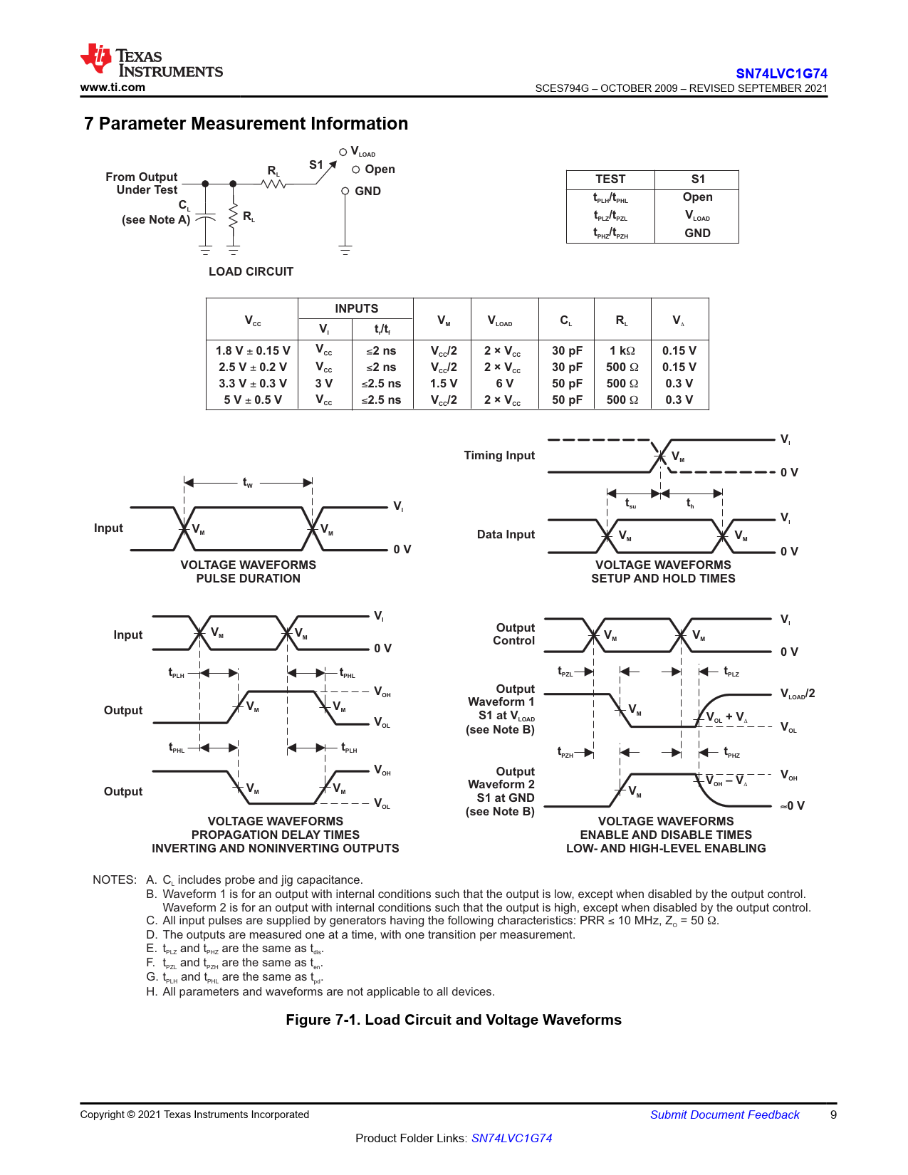

SN74LVC1G74. www.ti.com. 7 Parameter Measurement Information. VLOAD. Open. From Output. TEST. Under Test. GND. PLH. PHL. (see Note A). PLZ. PZL
SN74LVC1G74 www.ti.com 7 Parameter Measurement Information VLOAD Open From Output TEST Under Test GND PLH PHL (see Note A) PLZ PZL
SCES794G – OCTOBER 2009 – REVISED SEPTEMBER 2021
7 Parameter Measurement Information VLOAD S1 R Open From Output L TEST S1 Under Test GND t /t Open C PLH PHL L (see Note A) R t /t V L PLZ PZL LOAD t /t PHZ PZH GND LOAD CIRCUIT INPUTS V V V C R V CC M LOAD L L
D
V t /t I r f 1.8 V
0.15 V VCC
2 ns V /2 2 × V 30 pF 1 k 0.15 V CC CC
W
2.5 V
0.2 V VCC
2 ns V /2 2 × V 30 pF 500 0.15 V CC CC
W
3.3 V
0.3 V 3 V
2.5 ns 1.5 V 6 V 50 pF 500
W
0.3 V 5 V
0.5 V VCC
2.5 ns V /2 2 × V 50 pF 500 0.3 V CC CC
W
VI Timing Input VM 0 V tW t t su h VI VI Input V V M M Data Input V V M M 0 V 0 V VOLTAGE WAVEFORMS VOLTAGE WAVEFORMS PULSE DURATION SETUP AND HOLD TIMES VI V Output I Input VM VM V V Control M M 0 V 0 V t t t t PZL PLZ PLH PHL Output VOH V /2 Waveform 1 LOAD Output V V M M V S1 at V M LOAD V + V OL
D
VOL (see Note B) VOL t t PHL PLH t t PZH PHZ VOH Output VOH Waveform 2 V – V OH
D
Output V V M M V S1 at GND M VOL (see Note B)
0 V VOLTAGE WAVEFORMS VOLTAGE WAVEFORMS PROPAGATION DELAY TIMES ENABLE AND DISABLE TIMES INVERTING AND NONINVERTING OUTPUTS LOW- AND HIGH-LEVEL ENABLING
NOTES: A. C includes probe and jig capacitance. L B. Waveform 1 is for an output with internal conditions such that the output is low, except when disabled by the output control. Waveform 2 is for an output with internal conditions such that the output is high, except when disabled by the output control. C. All input pulses are supplied by generators having the following characteristics: PRR £ 10 MHz, Z = 50 W. O D. The outputs are measured one at a time, with one transition per measurement. E. t and t are the same as t . PLZ PHZ dis F. t and t are the same as t . PZL PZH en G. t and t are the same as t . PLH PHL pd H. All parameters and waveforms are not applicable to all devices.
Figure 7-1. Load Circuit and Voltage Waveforms
