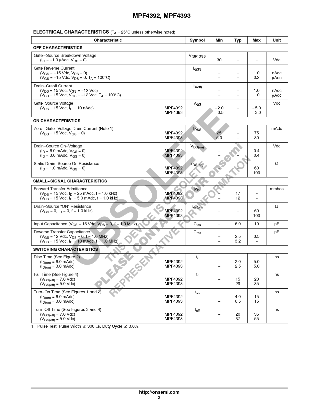

MPF4392, MPF4393. ELECTRICAL CHARACTERISTICS. Characteristic. Symbol. Min. Typ. Max. Unit. OFF CHARACTERISTICS. ON CHARACTERISTICS
MPF4392, MPF4393 ELECTRICAL CHARACTERISTICS Characteristic Symbol Min Typ Max Unit OFF CHARACTERISTICS ON CHARACTERISTICS
link to page 2 link to page 3 link to page 3 link to page 3 link to page 3 link to page 3 link to page 3
(TA = 25C unless otherwise noted)
Gate −Source Breakdown Voltage V(BR)GSS (IG = −1.0 mAdc, VDS = 0) 30 − − Vdc Gate Reverse Current IGSS (VGS = −15 Vdc, VDS = 0) − − 1.0 nAdc (VGS = −15 Vdc, VDS = 0, TA = 100C) − − 0.2 mAdc Drain−Cutoff Current ID(off) (VDS = 15 Vdc, VGS = −12 Vdc) − − 1.0 nAdc (VDS = 15 Vdc, VGS = −12 Vdc, TA = 100C) − − 1.0 mAdc Gate Source Voltage VGS Vdc (VDS = 15 Vdc, ID = 10 nAdc) MPF4392 −2.0 − −5.0 MPF4393 −0.5 − −3.0
ON CHARACTERISTICS
Zero−Gate −Voltage Drain Current (Note 1) IDSS mAdc (VDS = 15 Vdc, VGS = 0) MPF4392 25 − 75 MPF4393 5.0 − 30 Drain−Source On−Voltage VDS(on) Vdc (ID = 6.0 mAdc, VGS = 0) MPF4392 − − 0.4 (ID = 3.0 mAdc, VGS = 0) MPF4393 − − 0.4 Static Drain−Source On Resistance rDS(on) W (ID = 1.0 mAdc, VGS = 0) MPF4392 − − 60 MPF4393 − − 100
SMALL− SIGNAL CHARACTERISTICS
Forward Transfer Admittance |yfs| mmhos (VDS = 15 Vdc, ID = 25 mAdc, f = 1.0 kHz) MPF4392 − 17 − (VDS = 15 Vdc, ID = 5.0 mAdc, f = 1.0 kHz) MPF4393 − 12 − Drain−Source “ON” Resistance rds(on) W (VGS = 0, ID = 0, f = 1.0 kHz) MPF4392 − − 60 MPF4393 − − 100 Input Capacitance (VGS = 15 Vdc, VDS = 0, f = 1.0 MHz) Ciss − 6.0 10 pF Reverse Transfer Capacitance Crss pF (VGS = 12 Vdc, VDS = 0, f = 1.0 MHz) − 2.5 3.5 (VDS = 15 Vdc, ID = 10 mAdc, f = 1.0 MHz) − 3.2 −
SWITCHING CHARACTERISTICS
Rise Time (See Figure 2) tr ns (ID(on) = 6.0 mAdc) MPF4392 − 2.0 5.0 (ID(on) = 3.0 mAdc) MPF4393 − 2.5 5.0 Fall Time (See Figure 4) tf ns (VGS(off) = 7.0 Vdc) MPF4392 − 15 20 (VGS(off) = 5.0 Vdc) MPF4393 − 29 35 Turn−On Time (See Figures 1 and 2) ton ns (ID(on) = 6.0 mAdc) MPF4392 − 4.0 15 (ID(on) = 3.0 mAdc) MPF4393 − 6.5 15 Turn−Off Time (See Figures 3 and 4) toff ns (VGS(off) = 7.0 Vdc) MPF4392 − 20 35 (VGS(off) = 5.0 Vdc) MPF4393 − 37 55 1. Pulse Test: Pulse Width v 300 ms, Duty Cycle v 3.0%.
