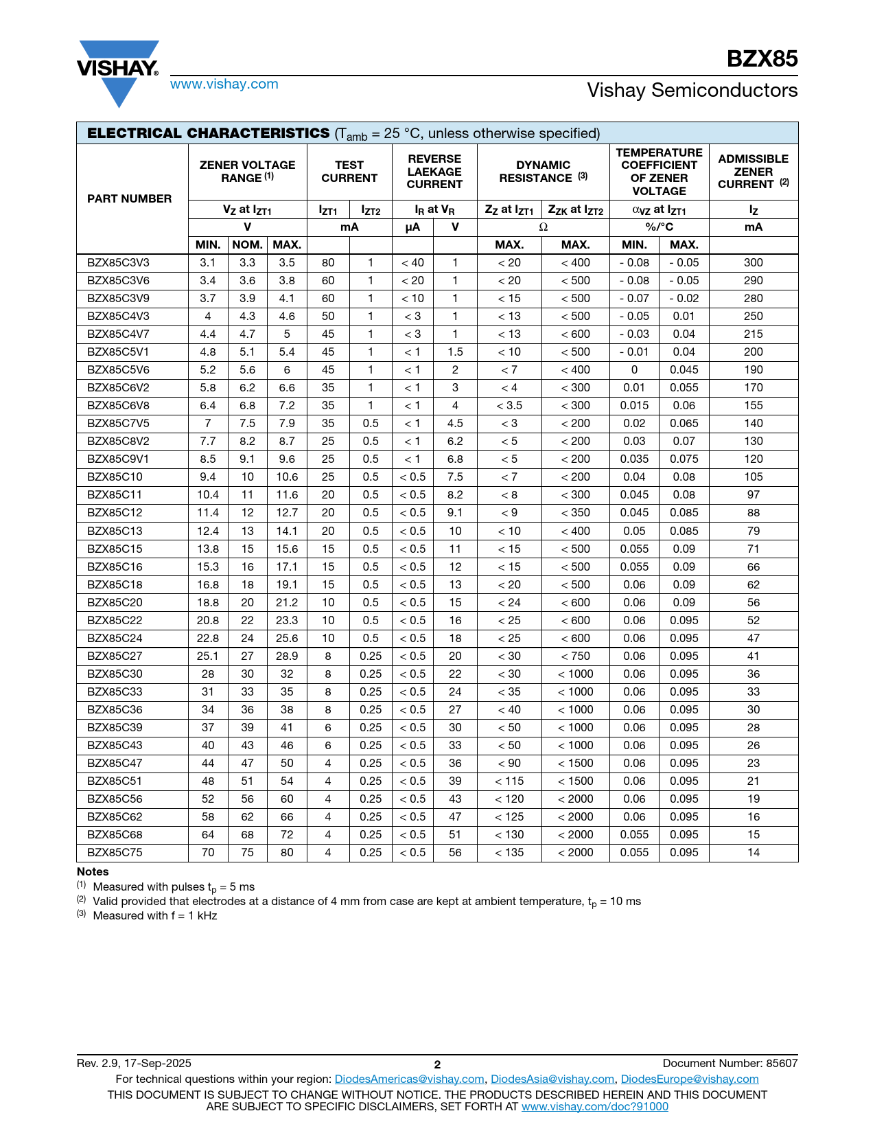

ManufacturerVishay
DescriptionSilicon Planar Power Zener Diodes in DO-41 (DO-204AL) package
Pages / Page4 / 2 — BZX85. ELECTRICAL CHARACTERISTICS. TEMPERATURE. REVERSE. ADMISSIBLE. …
Revision2.9
File Format / SizePDF / 108 Kb
BZX85. ELECTRICAL CHARACTERISTICS. TEMPERATURE. REVERSE. ADMISSIBLE. ZENER VOLTAGE. TEST. DYNAMIC. COEFFICIENT. LAEKAGE. ZENER. RANGE (1)
BZX85 ELECTRICAL CHARACTERISTICS TEMPERATURE REVERSE ADMISSIBLE ZENER VOLTAGE TEST DYNAMIC COEFFICIENT LAEKAGE ZENER RANGE (1)
BZX85
BZX85
(Tamb = 25 °C, unless otherwise specified)
TEMPERATURE REVERSE ADMISSIBLE ZENER VOLTAGE TEST DYNAMIC COEFFICIENT LAEKAGE ZENER RANGE (1) CURRENT RESISTANCE (3) OF ZENER CURRENT CURRENT (2) VOLTAGE PART NUMBER VZ at IZT1 IZT1 IZT2 IR at VR ZZ at IZT1 ZZK at IZT2
α
VZ at IZT1 IZ V mA μA V
Ω
%/°C mA MIN. NOM. MAX. MAX. MAX. MIN. MAX.
BZX85C3V3 3.1 3.3 3.5 80 1 < 40 1 < 20 < 400 - 0.08 - 0.05 300 BZX85C3V6 3.4 3.6 3.8 60 1 < 20 1 < 20 < 500 - 0.08 - 0.05 290 BZX85C3V9 3.7 3.9 4.1 60 1 < 10 1 < 15 < 500 - 0.07 - 0.02 280 BZX85C4V3 4 4.3 4.6 50 1 < 3 1 < 13 < 500 - 0.05 0.01 250 BZX85C4V7 4.4 4.7 5 45 1 < 3 1 < 13 < 600 - 0.03 0.04 215 BZX85C5V1 4.8 5.1 5.4 45 1 < 1 1.5 < 10 < 500 - 0.01 0.04 200 BZX85C5V6 5.2 5.6 6 45 1 < 1 2 < 7 < 400 0 0.045 190 BZX85C6V2 5.8 6.2 6.6 35 1 < 1 3 < 4 < 300 0.01 0.055 170 BZX85C6V8 6.4 6.8 7.2 35 1 < 1 4 < 3.5 < 300 0.015 0.06 155 BZX85C7V5 7 7.5 7.9 35 0.5 < 1 4.5 < 3 < 200 0.02 0.065 140 BZX85C8V2 7.7 8.2 8.7 25 0.5 < 1 6.2 < 5 < 200 0.03 0.07 130 BZX85C9V1 8.5 9.1 9.6 25 0.5 < 1 6.8 < 5 < 200 0.035 0.075 120 BZX85C10 9.4 10 10.6 25 0.5 < 0.5 7.5 < 7 < 200 0.04 0.08 105 BZX85C11 10.4 11 11.6 20 0.5 < 0.5 8.2 < 8 < 300 0.045 0.08 97 BZX85C12 11.4 12 12.7 20 0.5 < 0.5 9.1 < 9 < 350 0.045 0.085 88 BZX85C13 12.4 13 14.1 20 0.5 < 0.5 10 < 10 < 400 0.05 0.085 79 BZX85C15 13.8 15 15.6 15 0.5 < 0.5 11 < 15 < 500 0.055 0.09 71 BZX85C16 15.3 16 17.1 15 0.5 < 0.5 12 < 15 < 500 0.055 0.09 66 BZX85C18 16.8 18 19.1 15 0.5 < 0.5 13 < 20 < 500 0.06 0.09 62 BZX85C20 18.8 20 21.2 10 0.5 < 0.5 15 < 24 < 600 0.06 0.09 56 BZX85C22 20.8 22 23.3 10 0.5 < 0.5 16 < 25 < 600 0.06 0.095 52 BZX85C24 22.8 24 25.6 10 0.5 < 0.5 18 < 25 < 600 0.06 0.095 47 BZX85C27 25.1 27 28.9 8 0.25 < 0.5 20 < 30 < 750 0.06 0.095 41 BZX85C30 28 30 32 8 0.25 < 0.5 22 < 30 < 1000 0.06 0.095 36 BZX85C33 31 33 35 8 0.25 < 0.5 24 < 35 < 1000 0.06 0.095 33 BZX85C36 34 36 38 8 0.25 < 0.5 27 < 40 < 1000 0.06 0.095 30 BZX85C39 37 39 41 6 0.25 < 0.5 30 < 50 < 1000 0.06 0.095 28 BZX85C43 40 43 46 6 0.25 < 0.5 33 < 50 < 1000 0.06 0.095 26 BZX85C47 44 47 50 4 0.25 < 0.5 36 < 90 < 1500 0.06 0.095 23 BZX85C51 48 51 54 4 0.25 < 0.5 39 < 115 < 1500 0.06 0.095 21 BZX85C56 52 56 60 4 0.25 < 0.5 43 < 120 < 2000 0.06 0.095 19 BZX85C62 58 62 66 4 0.25 < 0.5 47 < 125 < 2000 0.06 0.095 16 BZX85C68 64 68 72 4 0.25 < 0.5 51 < 130 < 2000 0.055 0.095 15 BZX85C75 70 75 80 4 0.25 < 0.5 56 < 135 < 2000 0.055 0.095 14
Notes
(1) Measured with pulses tp = 5 ms (2) Valid provided that electrodes at a distance of 4 mm from case are kept at ambient temperature, tp = 10 ms (3) Measured with f = 1 kHz Rev. 2.9, 17-Sep-2025
