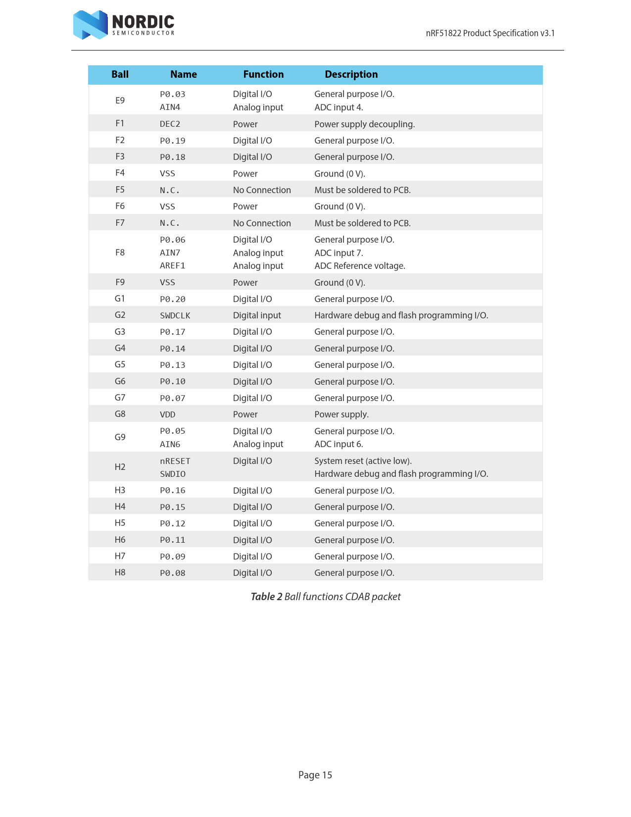

P0.03 Digital I/O General purpose I/O. E9 AIN4 Analog input ADC input 4. F1 DEC2 Power Power supply decoupling. F2 P0.19 Digital I/O General purpose I/O. F3 P0.18 Digital I/O General purpose I/O. F4 VSS Power Ground (0 V). F5 N.C. No Connection Must be soldered to PCB. F6 VSS Power Ground (0 V). F7 N.C. No Connection Must be soldered to PCB. P0.06 Digital I/O General purpose I/O. F8 AIN7 Analog input ADC input 7. AREF1 Analog input ADC Reference voltage. F9 VSS Power Ground (0 V). G1 P0.20 Digital I/O General purpose I/O. G2 SWDCLK Digital input Hardware debug and flash programming I/O. G3 P0.17 Digital I/O General purpose I/O. G4 P0.14 Digital I/O General purpose I/O. G5 P0.13 Digital I/O General purpose I/O. G6 P0.10 Digital I/O General purpose I/O. G7 P0.07 Digital I/O General purpose I/O. G8 VDD Power Power supply. P0.05 Digital I/O General purpose I/O. G9 AIN6 Analog input ADC input 6. nRESET Digital I/O System reset (active low). H2 SWDIO Hardware debug and flash programming I/O. H3 P0.16 Digital I/O General purpose I/O. H4 P0.15 Digital I/O General purpose I/O. H5 P0.12 Digital I/O General purpose I/O. H6 P0.11 Digital I/O General purpose I/O. H7 P0.09 Digital I/O General purpose I/O. H8 P0.08 Digital I/O General purpose I/O.
