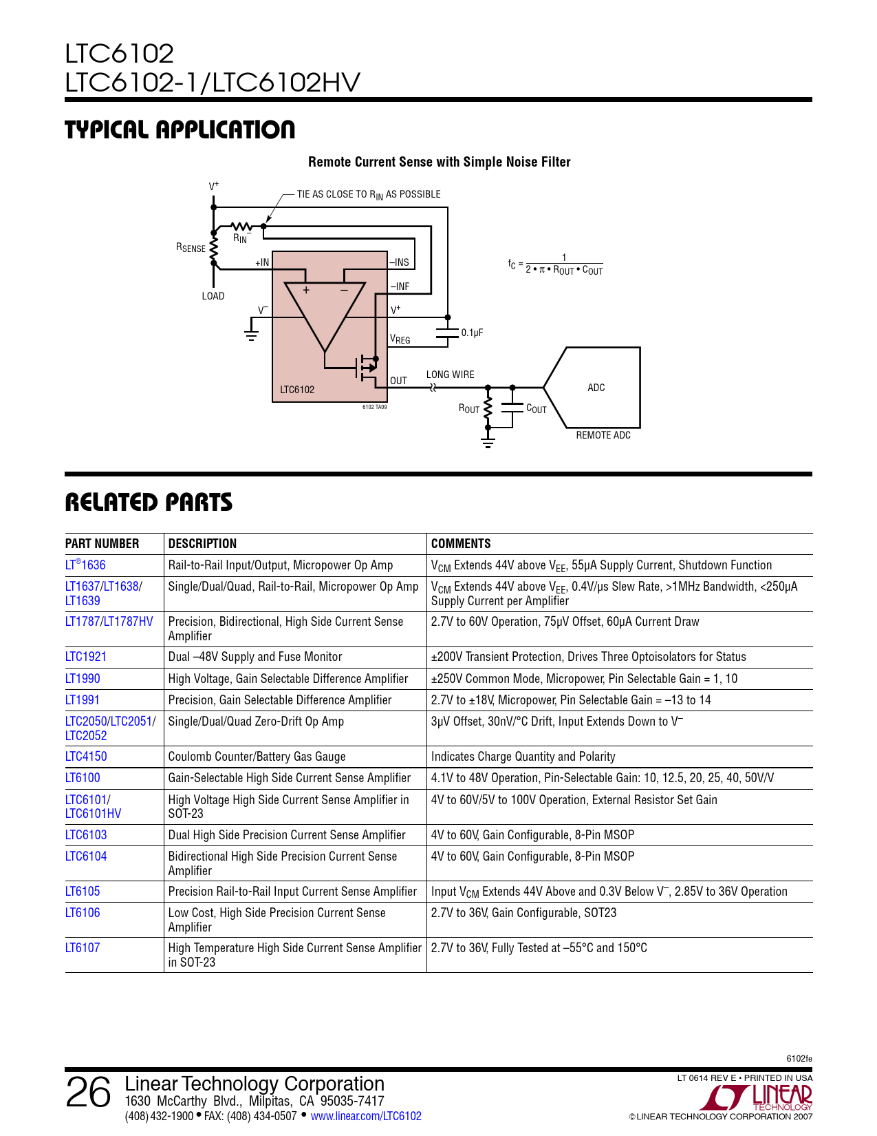

Typical applicaTion Remote Current Sense with Simple Noise Filter
V+ TIE AS CLOSE TO RIN AS POSSIBLE R – IN RSENSE +IN –INS fC = 1 2 • π • ROUT • COUT + – –INF LOAD V– V+ V 0.1µF REG LONG WIRE OUT LTC6102 ADC 6102 TA09 ROUT COUT REMOTE ADC
