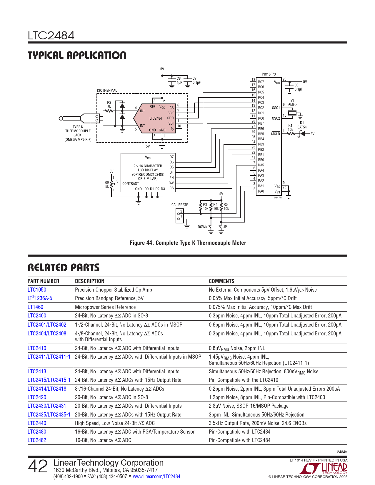

Pages / Page42 / 42 — Typical applicaTion. Figure 44. Complete Type K Thermocouple Meter. …
File Format / SizePDF / 768 Kb
Typical applicaTion. Figure 44. Complete Type K Thermocouple Meter. relaTeD parTs PART NUMBER. DESCRIPTION. COMMENTS
Typical applicaTion Figure 44 Complete Type K Thermocouple Meter relaTeD parTs PART NUMBER DESCRIPTION COMMENTS
LTC2484
Typical applicaTion
5V PIC16F73 C8 C7 18 20 1µF 0.1µF RC7 V 5V 17 DD C6 RC6 ISOTHERMAL 16 0.1µF RC5 15 RC4 3 2 14 R2 RC3 Y1 6 2k REF V 9 6MHz 4 CC CS 13 RC2 OSC1 IN+ 9 SCK 12 RC1 7 10 LTC2484 SDO 11 RC0 1 OSC2 SDI 28 D1 IN– RB7 10 TYPE K R1 5 f 27 BAT54 GND GND O RB6 THERMOCOUPLE 26 1 10k JACK 5V 8 11 RB5 MCLR 25 (OMEGA MPJ-K-F) RB4 24 5V RB3 23 RB2 22 RB1 V D7 CC 21 RB0 D6 7 RA5 2 × 16 CHARACTER D5 6 5V LCD DISPLAY RA4 D4 5 (OPIREX DMC162488 RA3 1 OR SIMILAR) EN 4 3 RA2 R6 CONTRAST RW 3 9 5k RA1 V GND D0 D1 D2 D3 RS 2 SS 19 2 RA0 VSS 5V 2484 F44 CALIBRATE R3 R4 R5 10k 10k 10k 2 1 DOWN UP
Figure 44. Complete Type K Thermocouple Meter relaTeD parTs PART NUMBER DESCRIPTION COMMENTS
