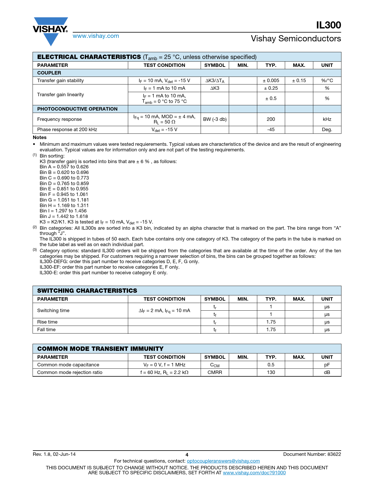

IL300. ELECTRICAL CHARACTERISTICS. PARAMETER. TEST CONDITION. SYMBOL. MIN. TYP. MAX. UNIT. COUPLER. PHOTOCONDUCTIVE OPERATION. Notes
IL300 ELECTRICAL CHARACTERISTICS PARAMETER TEST CONDITION SYMBOL MIN TYP MAX UNIT COUPLER PHOTOCONDUCTIVE OPERATION Notes
IL300
(Tamb = 25 °C, unless otherwise specified)
PARAMETER TEST CONDITION SYMBOL MIN. TYP. MAX. UNIT COUPLER
Transfer gain stability IF = 10 mA, Vdet = -15 V K3/TA ± 0.005 ± 0.15 %/°C IF = 1 mA to 10 mA K3 ± 0.25 % Transfer gain linearity IF = 1 mA to 10 mA, ± 0.5 % Tamb = 0 °C to 75 °C
I Frequency response Fq = 10 mA, MOD = ± 4 mA, RL = 50 BW (-3 db) 200 kHz Phase response at 200 kHz Vdet = -15 V -45 Deg.
Notes
• Minimum and maximum values were tested requierements. Typical values are characteristics of the device and are the result of engineering evaluation. Typical values are for information only and are not part of the testing requirements. (1) Bin sorting: K3 (transfer gain) is sorted into bins that are ± 6 % , as follows: Bin A = 0.557 to 0.626 Bin B = 0.620 to 0.696 Bin C = 0.690 to 0.773 Bin D = 0.765 to 0.859 Bin E = 0.851 to 0.955 Bin F = 0.945 to 1.061 Bin G = 1.051 to 1.181 Bin H = 1.169 to 1.311 Bin I = 1.297 to 1.456 Bin J = 1.442 to 1.618 K3 = K2/K1. K3 is tested at IF = 10 mA, Vdet = -15 V. (2) Bin categories: All IL300s are sorted into a K3 bin, indicated by an alpha character that is marked on the part. The bins range from “A” through “J”. The IL300 is shipped in tubes of 50 each. Each tube contains only one category of K3. The category of the parts in the tube is marked on the tube label as well as on each individual part. (3) Category options: standard IL300 orders will be shipped from the categories that are available at the time of the order. Any of the ten categories may be shipped. For customers requiring a narrower selection of bins, the bins can be grouped together as follows: IL300-DEFG: order this part number to receive categories D, E, F, G only. IL300-EF: order this part number to receive categories E, F only. IL300-E: order this part number to receive category E only.
SWITCHING CHARACTERISTICS PARAMETER TEST CONDITION SYMBOL MIN. TYP. MAX. UNIT
tr 1 μs Switching time IF = 2 mA, IFq = 10 mA tf 1 μs Rise time tr 1.75 μs Fall time tf 1.75 μs
COMMON MODE TRANSIENT IMMUNITY PARAMETER TEST CONDITION SYMBOL MIN. TYP. MAX. UNIT
Common mode capacitance VF = 0 V, f = 1 MHz CCM 0.5 pF Common mode rejection ratio f = 60 Hz, RL = 2.2 k CMRR 130 dB Rev. 1.8, 02-Jun-14
