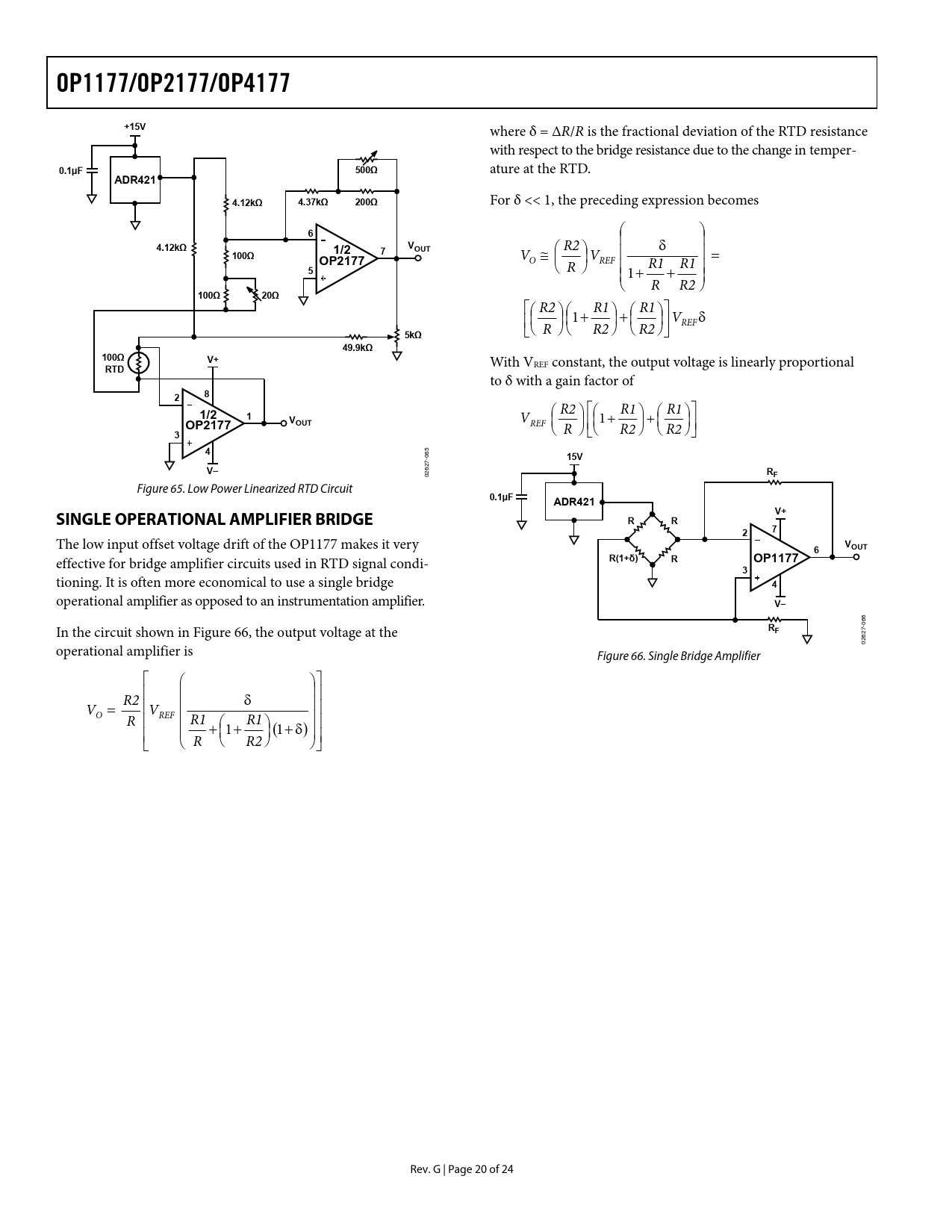

OP1177/OP2177/OP4177 +15V
where δ = ΔR/R is the fractional deviation of the RTD resistance with respect to the bridge resistance due to the change in temper-
0.1µF 500Ω
ature at the RTD.
ADR421 4.12kΩ 4.37kΩ 200Ω
For δ << 1, the preceding expression becomes
6
4.12kΩ 1/2 V
⎛ R2 ⎞ δ
OUT 100Ω 7
V ≅ V ⎜ ⎟
OP2177
O ⎜ ⎟ = REF R1 R1
5
⎝ R ⎠ ⎜⎜ 1+ + ⎟⎟ ⎝ R R2 ⎠
100Ω 20Ω
⎡⎛ R2 ⎞ ⎛ R1 ⎞ ⎛ R1 ⎞⎤ ⎜ ⎟ ⎜ 1+ ⎟ + ⎜ ⎟ V δ ⎢ ⎥ ⎣⎝ R ⎠ ⎝ R2 ⎠ ⎝ R2 ⎠⎦ REF
5kΩ 49.9kΩ 100Ω V+
With V
RTD
REF constant, the output voltage is linearly proportional to δ with a gain factor of
8 2 1/2
⎛ R2 ⎞ ⎡⎛ R1 ⎞ ⎛ R1 ⎞⎤
1
V 1 REF ⎜ ⎟ ⎜ + ⎟ +
OP2177 VOUT
⎢ ⎜ ⎟⎥ ⎝ R ⎠ ⎝ R2 ⎠ ⎝ R2 ⎠
3
4
65 -0
15V
27
V–
26
R
0
F
Figure 65. Low Power Linearized RTD Circuit
0.1µF ADR421 V+ SINGLE OPERATIONAL AMPLIFIER BRIDGE R R 7 2 V
The low input offset voltage drift of the OP1177 makes it very
6 OUT R(1+δ) R OP1177
effective for bridge amplifier circuits used in RTD signal condi-
3
tioning. It is often more economical to use a single bridge
4
operational amplifier as opposed to an instrumentation amplifier.
V–
66 -0
RF
