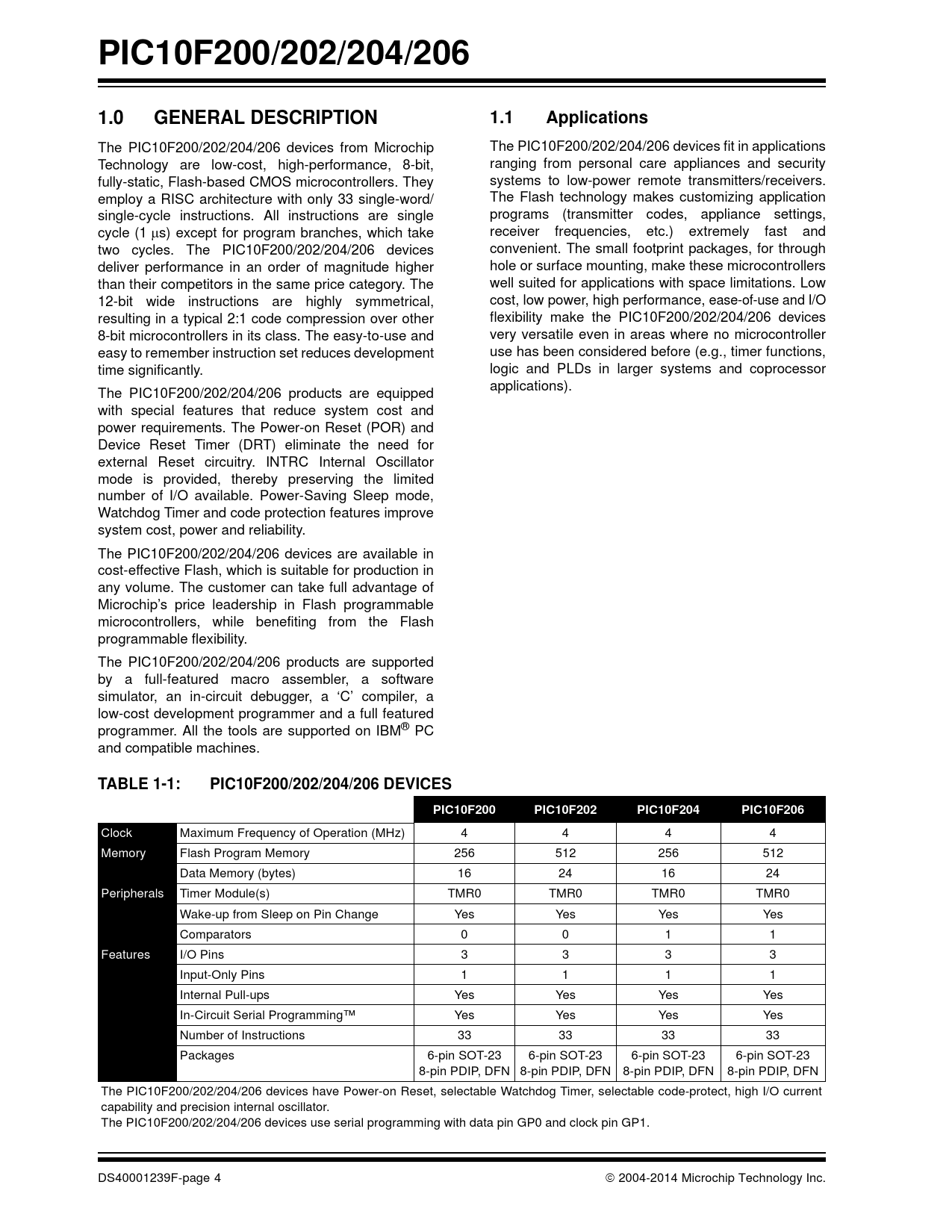

PIC10F200/202/204/206. 1.0 GENERAL DESCRIPTION 1.1 Applications The PIC10F200/202/204/206 devices fit in applications
PIC10F200/202/204/206 1.0 GENERAL DESCRIPTION 1.1 Applications The PIC10F200/202/204/206 devices fit in applications
ranging from personal care appliances and security
systems to low-power remote transmitters/receivers.
The Flash technology makes customizing application
programs (transmitter codes, appliance settings,
receiver frequencies, etc.) extremely fast and
convenient. The small footprint packages, for through
hole or surface mounting, make these microcontrollers
well suited for applications with space limitations. Low
cost, low power, high performance, ease-of-use and I/O
flexibility make the PIC10F200/202/204/206 devices
very versatile even in areas where no microcontroller
use has been considered before (e.g., timer functions,
logic and PLDs in larger systems and coprocessor
applications). The PIC10F200/202/204/206 devices from Microchip
Technology are low-cost, high-performance, 8-bit,
fully-static, Flash-based CMOS microcontrollers. They
employ a RISC architecture with only 33 single-word/
single-cycle instructions. All instructions are single
cycle (1 s) except for program branches, which take
two cycles. The PIC10F200/202/204/206 devices
deliver performance in an order of magnitude higher
than their competitors in the same price category. The
12-bit wide instructions are highly symmetrical,
resulting in a typical 2:1 code compression over other
8-bit microcontrollers in its class. The easy-to-use and
easy to remember instruction set reduces development
time significantly.
The PIC10F200/202/204/206 products are equipped
with special features that reduce system cost and
power requirements. The Power-on Reset (POR) and
Device Reset Timer (DRT) eliminate the need for
external Reset circuitry. INTRC Internal Oscillator
mode is provided, thereby preserving the limited
number of I/O available. Power-Saving Sleep mode,
Watchdog Timer and code protection features improve
system cost, power and reliability.
The PIC10F200/202/204/206 devices are available in
cost-effective Flash, which is suitable for production in
any volume. The customer can take full advantage of
Microchip’s price leadership in Flash programmable
microcontrollers, while benefiting from the Flash
programmable flexibility.
The PIC10F200/202/204/206 products are supported
by a full-featured macro assembler, a software
simulator, an in-circuit debugger, a ‘C’ compiler, a
low-cost development programmer and a full featured
programmer. All the tools are supported on IBM® PC
and compatible machines. TABLE 1-1: PIC10F200/202/204/206 DEVICES
PIC10F200 Clock Maximum Frequency of Operation (MHz) Memory Flash Program Memory
Data Memory (bytes) Peripherals Timer Module(s)
Wake-up from Sleep on Pin Change
Comparators Features PIC10F202 PIC10F204 PIC10F206 4 4 4 4 256 512 256 512 16 24 16 24 TMR0 TMR0 TMR0 TMR0 Yes Yes Yes Yes 0 0 1 1 I/O Pins 3 3 3 3 Input-Only Pins 1 1 1 1 Internal Pull-ups Yes Yes Yes Yes In-Circuit Serial Programming™ Yes Yes Yes Yes 33 33 33 Number of Instructions
Packages 6-pin SOT-23
6-pin SOT-23
6-pin SOT-23
8-pin PDIP, DFN 8-pin PDIP, DFN 8-pin PDIP, DFN 33
6-pin SOT-23
8-pin PDIP, DFN The PIC10F200/202/204/206 devices have Power-on Reset, selectable Watchdog Timer, selectable code-protect, high I/O current
capability and precision internal oscillator.
The PIC10F200/202/204/206 devices use serial programming with data pin GP0 and clock pin GP1. DS40001239F-page 4  2004-2014 Microchip Technology Inc.
