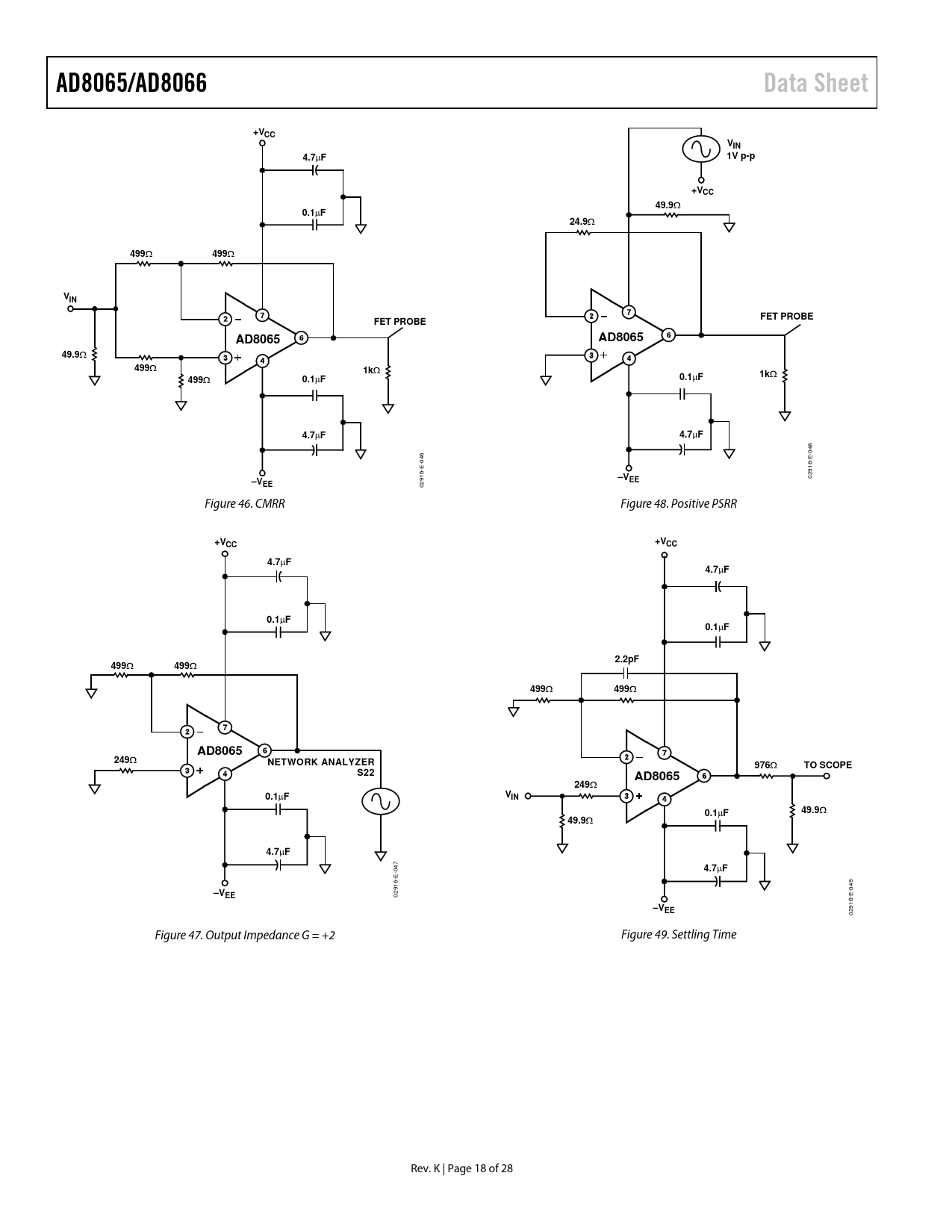

AD8065/AD8066. Data Sheet. +VCC. VIN. 4.7. 1V p-p. 49.9. 0.1. 24.9. 499. FET PROBE. AD8065. 2.2pF. 249. NETWORK ANALYZER. 976. TO SCOPE. S22. –VEE
AD8065/AD8066 Data Sheet +VCC VIN 4.7 1V p-p 49.9 0.1 24.9 499 FET PROBE AD8065 2.2pF 249 NETWORK ANALYZER 976 TO SCOPE S22 –VEE
AD8065
AD8066
µ
F 1V p-p +VCC 49.9
0.1
µ
F 24.9
499
499
VIN FET PROBE FET PROBE AD8065 AD8065 49.9
499
1k
1k
499
0.1
µ
F 0.1
µ
F 4.7
µ
F 4.7
µ
F –V
02916-E-048
–V EE EE
02916-E-046 Figure 46. CMRR Figure 48. Positive PSRR
+VCC +VCC 4.7
µ
F 4.7
µ
F 0.1
µ
F 0.1
µ
F 2.2pF 499
499
499
499
AD8065 249
TO SCOPE S22 AD8065 249
0.1
µ
F VIN 0.1
µ
F 49.9
49.9
4.7
µ
F 4.7
µ
F –VEE
02916-E-047
–VEE
02916-E-049 Figure 47. Output Impedance G = +2 Figure 49. Settling Time Rev. K | Page 18 of 28 Document Outline FEATURES APPLICATIONS CONNECTION DIAGRAMS GENERAL DESCRIPTION REVISION HISTORY SPECIFICATIONS ±5 V SPECIFICATIONS ±12 V SPECIFICATIONS +5 V ABSOLUTE MAXIMUM RATINGS MAXIMUM POWER DISSIPATION OUTPUT SHORT CIRCUIT ESD CAUTION TYPICAL PERFORMANCE CHARACTERISTICS TEST CIRCUITS SOIC-8 Pinout THEORY OF OPERATION CLOSED-LOOP FREQUENCY RESPONSE NONINVERTING CLOSED-LOOP FREQUENCY RESPONSE INVERTING CLOSED-LOOP FREQUENCY RESPONSE WIDEBAND OPERATION INPUT PROTECTION THERMAL CONSIDERATIONS INPUT AND OUTPUT OVERLOAD BEHAVIOR LAYOUT, GROUNDING, AND BYPASSING CONSIDERATIONS POWER SUPPLY BYPASSING GROUNDING LEAKAGE CURRENTS INPUT CAPACITANCE OUTPUT CAPACITANCE INPUT-TO-OUTPUT COUPLING WIDEBAND PHOTODIODE PREAMP HIGH SPEED JFET INPUT INSTRUMENTATION AMPLIFIER VIDEO BUFFER OUTLINE DIMENSIONS ORDERING GUIDE AUTOMOTIVE PRODUCTS
