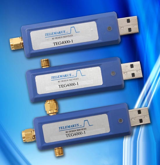

The TEG4000-1 is a Laboratory-quality, Synthesized RF Signal Source with minimum of 0dBm Output Power over a frequency range of 200 to 4000MHz.
The TEG4000-1 is the smallest USB microwave synthesized source available and is priced significantly below the current market offerings.
The source can be swept in step size as low as 1KHz between any two frequencies in its specified range.
Applications include local oscillator for frequency conversion, Scalar measurements and two or more can be combined for multi-tone testing . Use of the optional HUB allows the source to remain in a given state even after the host PC is removed from the system.
The unit also contains 0.5GB of flash memory used for installation files, test data and other supporting documentation. Drivers, utilities and documentation are available on the attenuator itself.
Calibration
Full results of factory test data are stored in the each units flash memory and available through the USB interface.
Benefits
- Synthesized RF Source
- USB 2.0 Interface
- 200MHz to 4000MHz
Features
- +1dBm Output
- PC Software supported
- Internal 10MHz Xtal Ref
- –100dBc phase noise @100KHz
