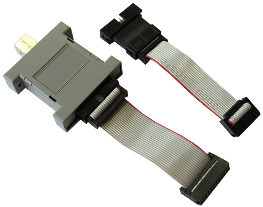

TMS320-JTAG-USB XDS100 - The world's lowest cost DSP USB JTAG for programming and emulation solution.
Detailed Description
Olimex TMS320-JTAG-USB
FEATURES
  • TMS320-JTAG-USB hardware is designed to utilize the XDS100 software
  • program all TMS320F C28xx flash 32-bit Real Time Microcontrollers (DSP), not XDS510 compatible, but have own CCS 3.30 drivers and support
  • supports all members of C2800 family C54/55x and C674x (more to be implemented in future)
  • uses standard 0.1" 2×7 pin and 2×10 pin JTAG connector
  • no need for external power supply, all power is taken from USB and the target
  • compatible with Code Composer Studio 3.30 software for programming, real time emulation, debugging, step by step program execution, breakpoints, memory dump etc everything all high priced emulators do
  • dimensions 50×40 mm (2×1.6") + 20 cm (8") cable
